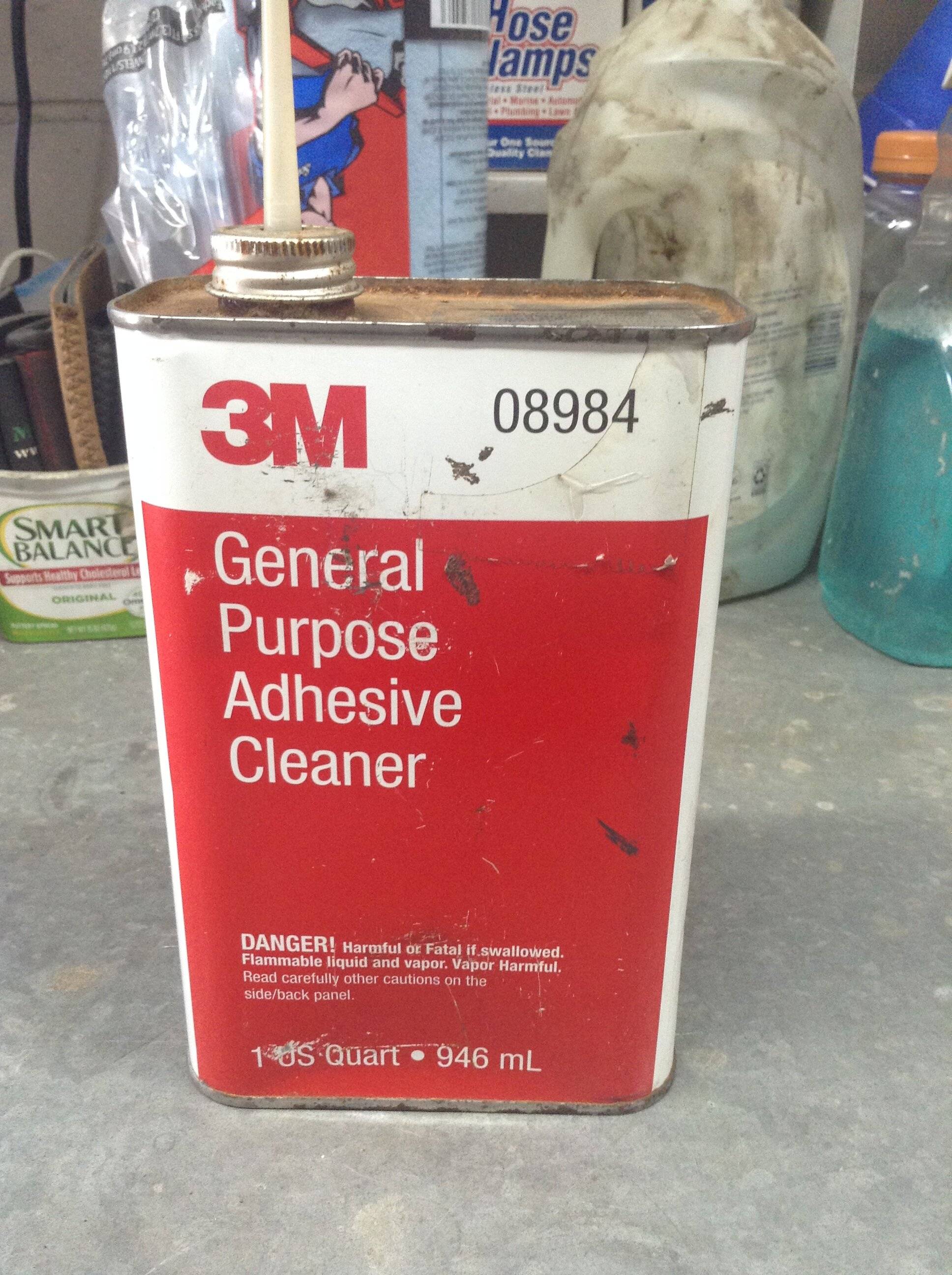

Anyone have any recommendations on what may be an option to take fine overspray off of my hood? This hood is smoother than original texture. Just not sure what would work and not damage the organosol finish.
I have used this in the past to take overspray off plastic gauge lens and had good results. just put some on acotton cloth and wipe on sparingly. You can always test on something else to see if it works for you. I'm sure other members here will have an idea or two as well.
