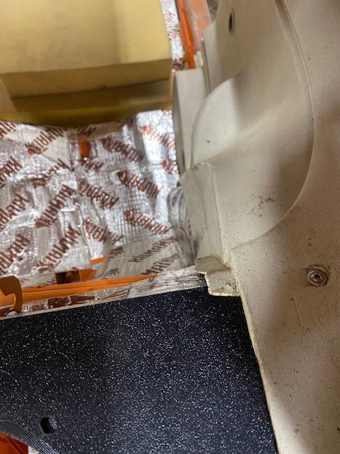

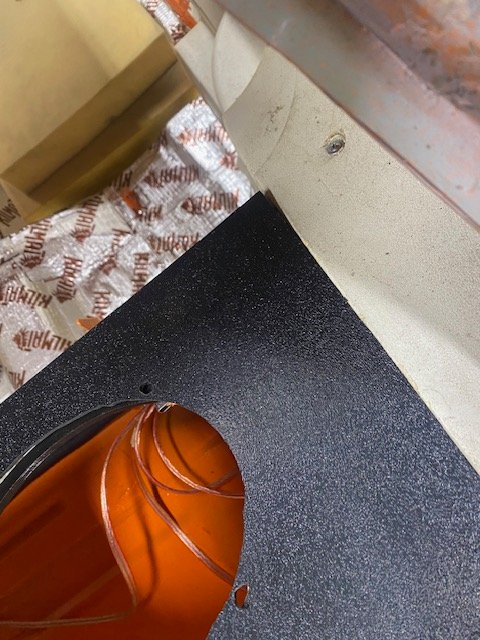

Tuesday at 4:48 PM #1 Quiny Well-Known Member Joined Jul 21, 2021 Messages 80 Reaction score 32 Location 02760 Does the package tray go under the plastic interior rear sail quarter panel or above? It seams like it should go above but if it does I need to trim it.
Tuesday at 9:32 PM #2 pschlosser Well-Known Member Joined Dec 8, 2022 Messages 1,561 Reaction score 861 Location Santa Rosa, California Quiny said: Does the package tray go under the plastic interior rear sail quarter panel or above? Click to expand... the sail panel is the (headliner fabric covered) panel between the side rear and back windows. It goes in before any surrounding trim. the package tray goes in, soon after. the back window trim and upper side trim go in next. the rear interior quarter panels go in, after that, help to hold things in place. finally, the back seat upper and lower are installed.
Yesterday at 11:31 AM #3 heminut Well-Known Member Joined Dec 28, 2008 Messages 1,057 Reaction score 976 Location Deming, New Mexico The package tray piece goes under the side panels.
Yesterday at 2:40 PM #4 Katfish Well-Known Member Joined May 14, 2022 Messages 989 Reaction score 694 Location Palm Bay, FL Is it even possible to put it above the side panels? There's enough cardboard that mine would never fit that way.
Yesterday at 6:17 PM #5 Xcudame Well-Known Member Joined May 27, 2023 Messages 3,144 Reaction score 2,442 Location Southeast Arizona The package tray goes in first as everything else holds it in place. Even the rear speakers drop in on top of the package tray.
