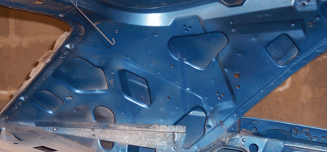

I went out a took a picture of the sail panel in my 71 Barracuda to show the coat hook holding the top. the sides and bottom are helped held in place by the interior trim/mouldings and the rear side panel. So except in the case of warped ones, they fit in there pretty snug.
