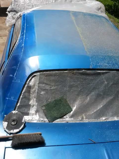

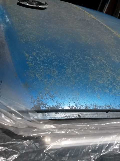

WELL EXCUDAME!!! I had to use it. I like the user name. I dare to differ in my case. Being the second owner. When I replaced the vinyl roof there was a complete coat of paint on ther roof. As I have learded never say never with a mopar. Maybe a new guy or the spray pot had to be cleared for what ever reason who knows.

I wonder if it was a painted car and it got pulled off the line to add a vinyl top? But you're right, never say never with Chrysler! But of the dozen or so Challenger vinyl top cars I've owned or help chop up (needed pieces for the circle track Challenger), they were never completely painted. some did have the sail panels painted haphazardly. Personally (and problem most people who own a vinyl top car) wish the factory had painted it before installing the vinyl top. Definitely prown to rusting!
