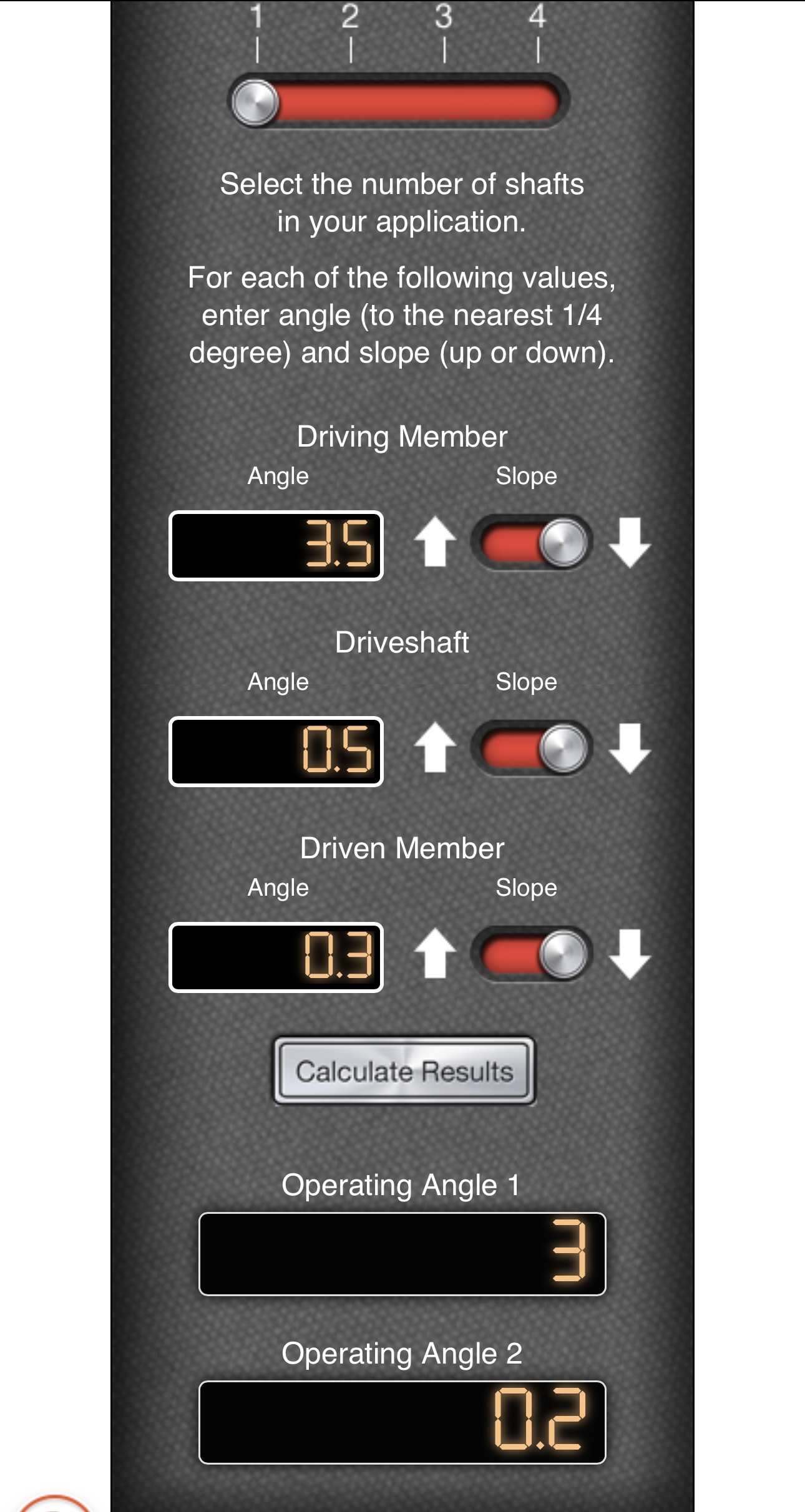

Ok need a quick recap i measured my driveline angels today and got these measurements .. Now i’m pretty sure i need a 2 degree shim in the rear to make my operating angles pretty good .. Is this correct or iam i missing something here .. ?
Thanks guys!

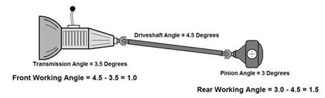

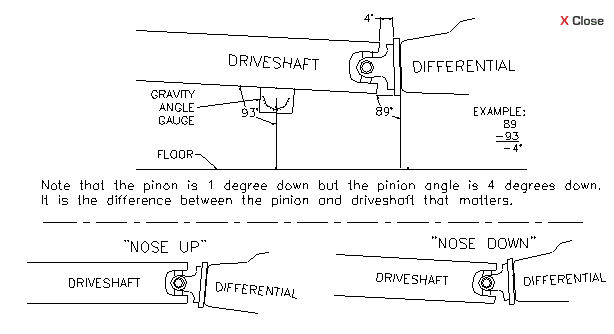

4 degree comes to mind is what is ideal maybe not in you case. not sure let me find something. not sure of what your doing.

Angles are off it has a 6.1 hemi 545rfe and it needs the pinion set agian
Now we get more information... Basically a truck/R.V. transmission.
The pinion and tailshaft angle need to be compatible.
Look in the FSM for 70-74 Challenger Chassis Manual in th Propeller Shaft and Universal Joint section, 16
