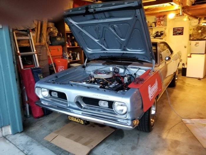

Mopar in it's natural state
Disconnect the battery. ..always.

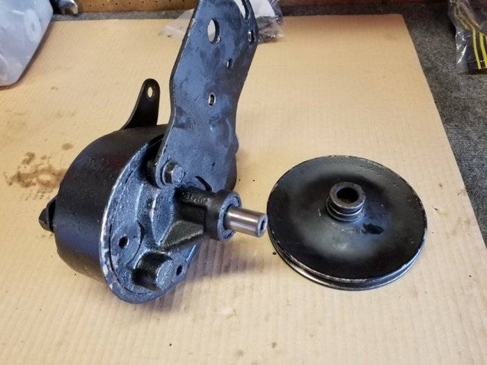

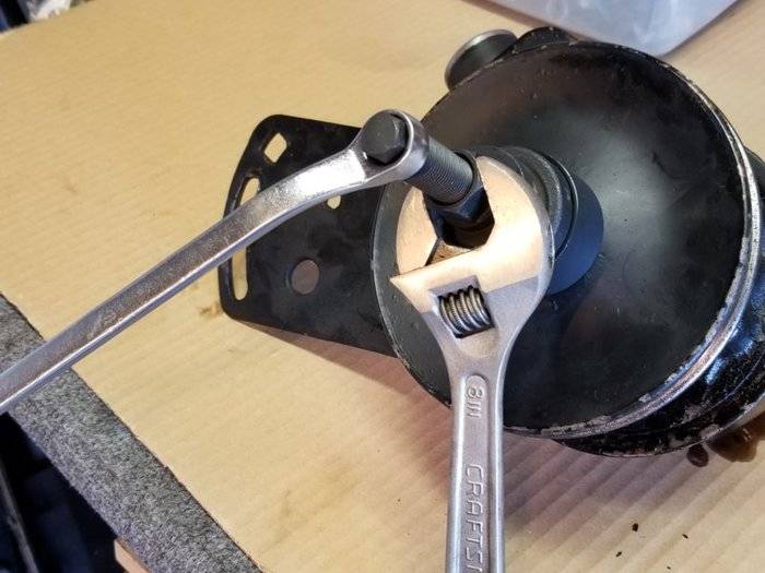

Now, first pull off the pulley.
I bought a Walmart puller - don't. It's crap. It stripped out and never even pulled the pulley. No problem, Walmart gave me my money back.
I rented one for free (deposit) at the parts store and the pulley came right off.

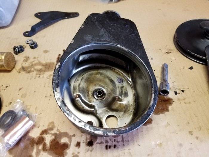

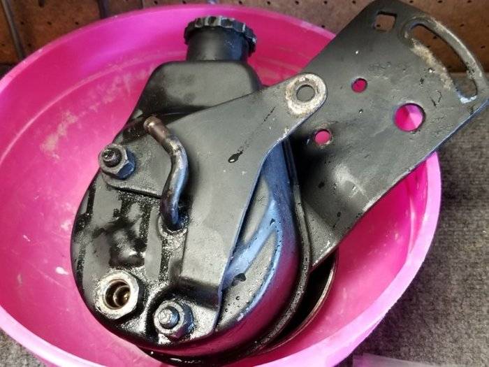

Next, take the tank off.
And here is the pump

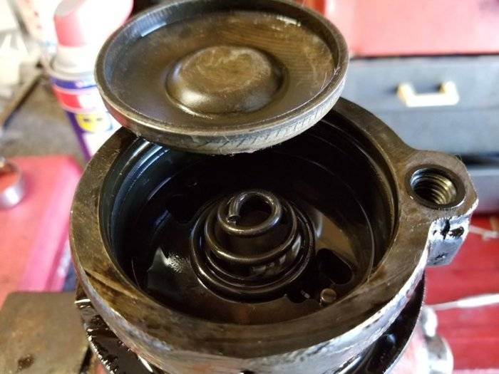

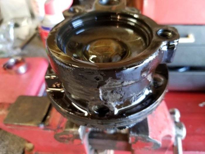

Use a c-clamp to compress the cap a little and remove the retaining clip.
At this point, gently tap the pulley shaft and it all comes out of the casting.
The "rebuild" only consists of replacing a few o-rings and a seal ...I didn't photograph the o-rings....just remove one, go to you kit and find the match and put it in...couldn't get any easier.
Then reassemble it the way it came apart...there's not many parts, just take it apart carefully and it's very simple.

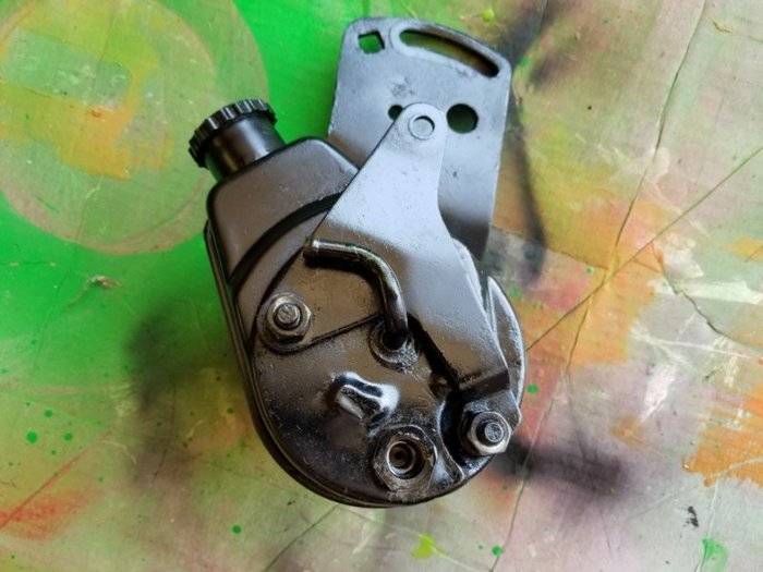

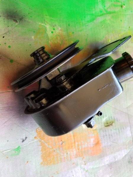

Painted.
Ran out of time. ..I'll reinstall it tomorrow.
Painted.
