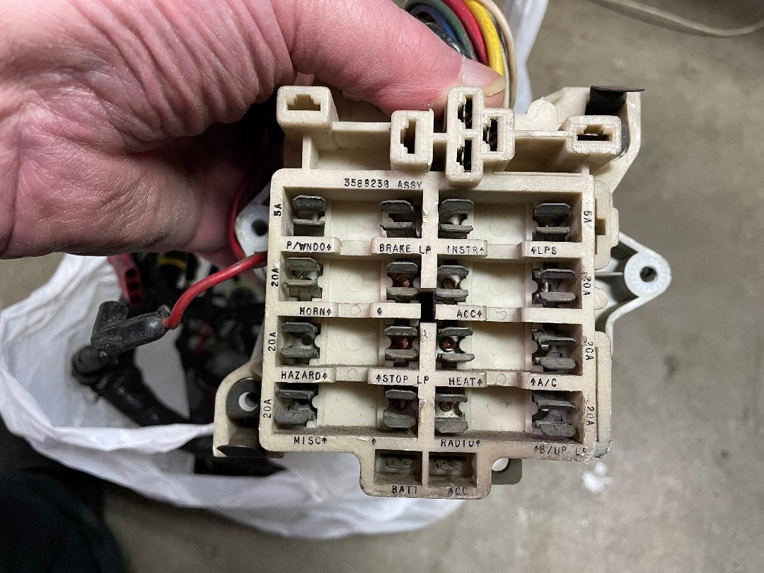

If it's not missing it will be under the dash near the instrument panel, I believe. I never had an E-Body with power windows! It has a very unique folded bracket.

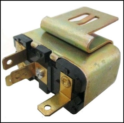

Thank you for the Info & the photos. The Relay must be missing because there is not one attached to my Fuse Box as shown in the photos provided by Slotts 👍. I ordered an upgraded Window Relay (100 amp) that is claimed to work and a be better Relay of Fleabay. Hopefully this will work. The photo of the Relay on the fuse box was great. Any photos of the harness attached to the Relay would be helpful too. Thanks for the support! 🌴
