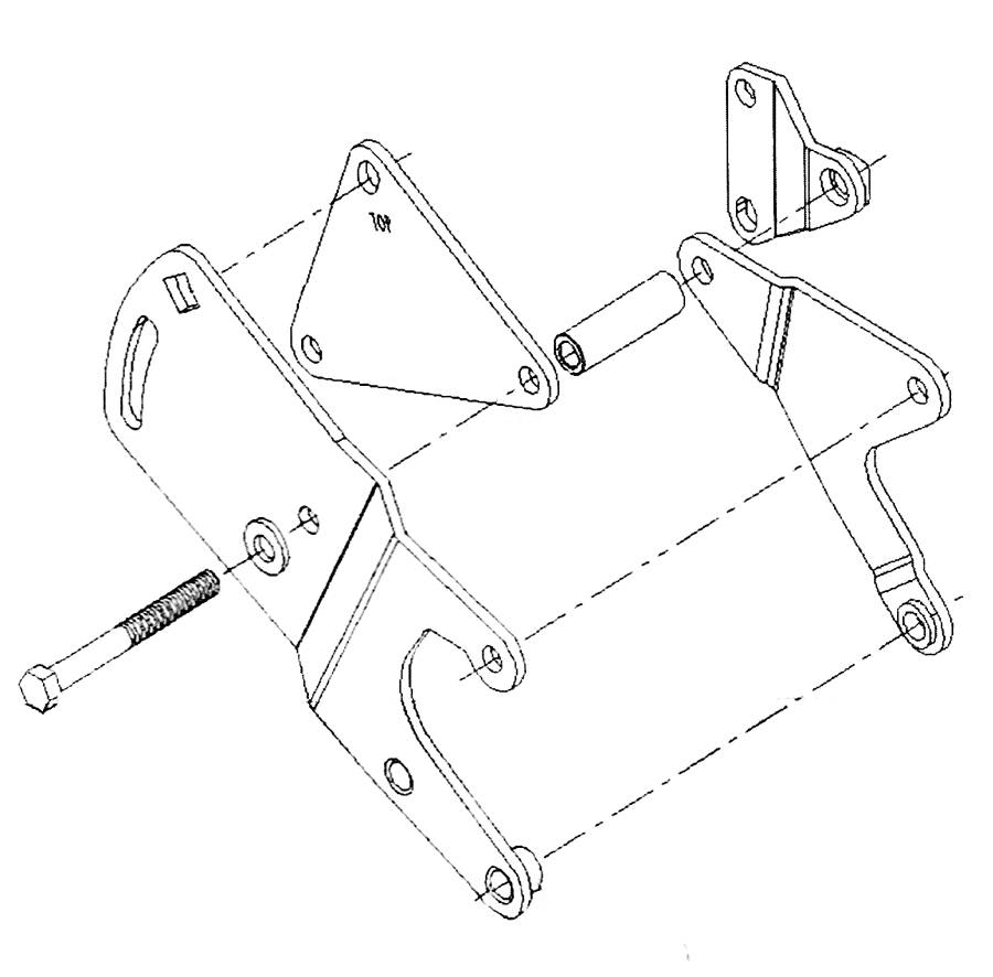

Looking to assemble PS pump, AC compressor and Alt on a 340 on a 1972 Cuda...anyone have pics of the related brackets and where/how they are bolted to component and engine....or a parts book illustration?

Here's a good picture of the power steering pump brackets.
The illustration shown is ONLY the SAGINAW pump... the preferred pump for proper assist during performance driving (i.e.: hi-rpms).
The brackets are different for the FEDERAL pump... which should be avoided as they do NOT provide proper assist during hi-rpms.
