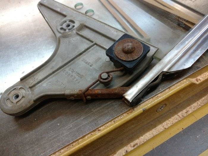

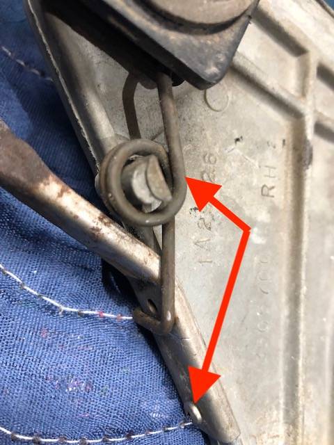

Does anyone know where I can find the springs and very small screws that attach the chrome trim to the quarter glass?

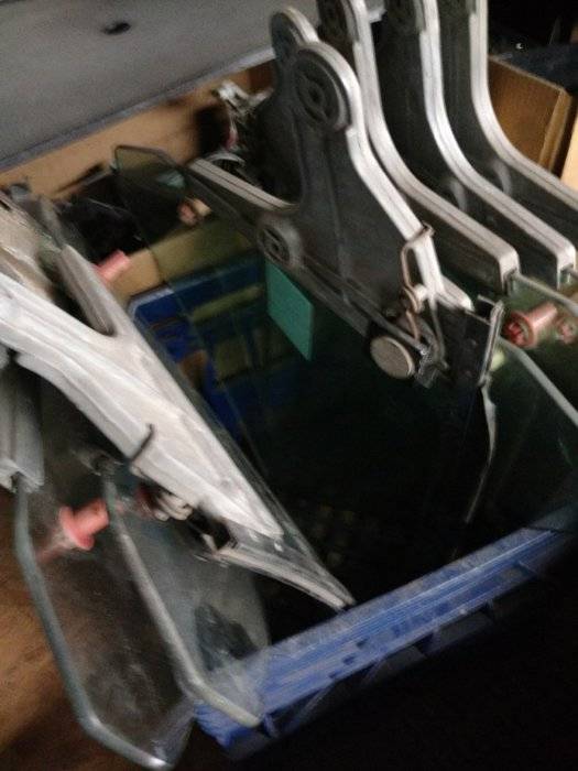

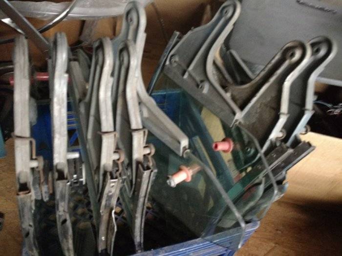

I can’t separate the small screws from the one unit I have that actually has them but I would be happy to help you by pulling one and giving you the details as far as thread count and Length.

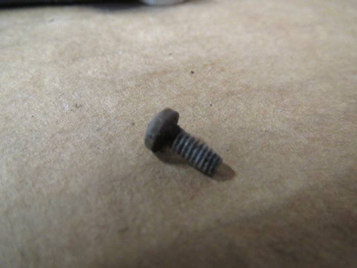

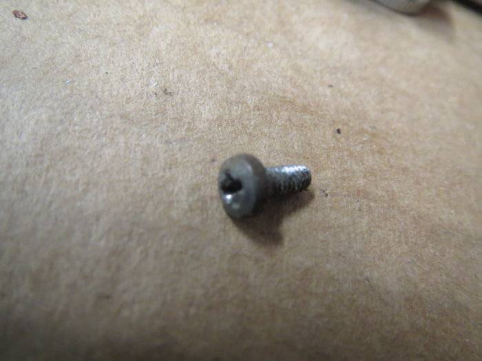

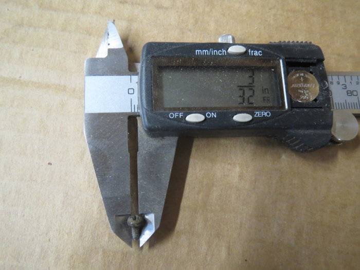

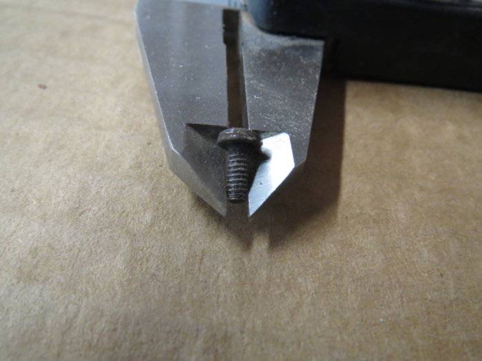

The threads are a hair under 1/4” long.
There are about 10 threads in a quarter inch which would translate to 40 per inch and the diameter at the top of the pitch is 3/32” as sown in the pic.

I have thread pitch gauges and to be honest with you my eyes aren’t what they used to be. 32 looked a little course.

Thanks guys,. I will try a 10/32 machine screw. Moparleo, will you be at Woodley Park tomorrow??
