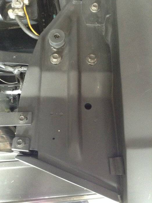

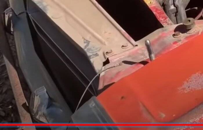

This is the hole in the fender that the pins are mounted.

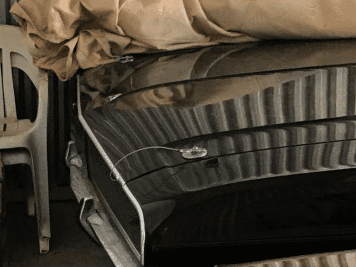

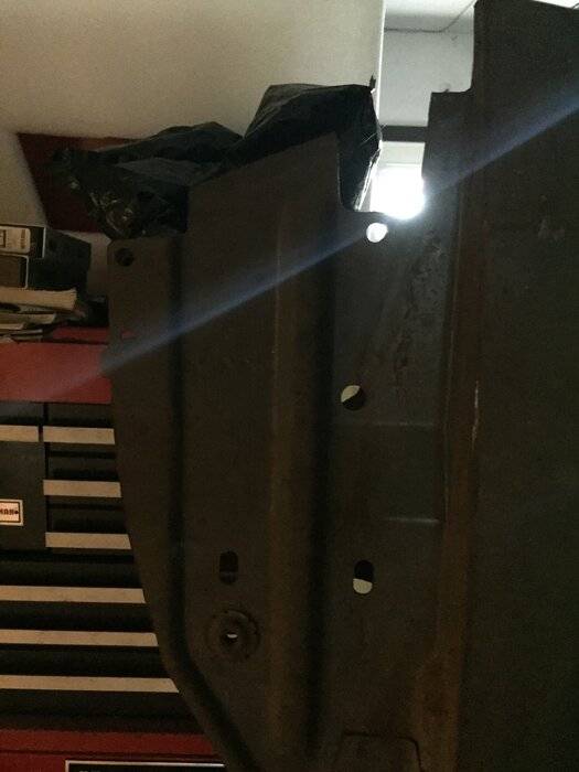

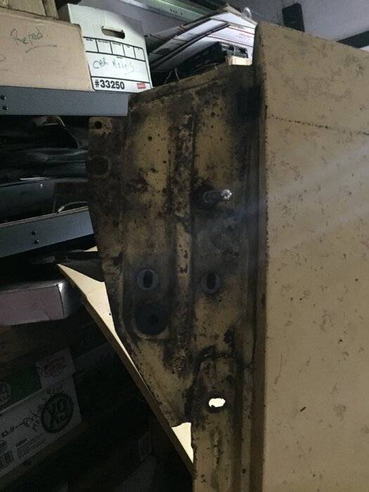

Here is a pic of my original, early 70 Challenger fender; I added the pins. Fender hole was there; had to drill the hood. And a pic of an NOS Challenger fender I bought in 1980.

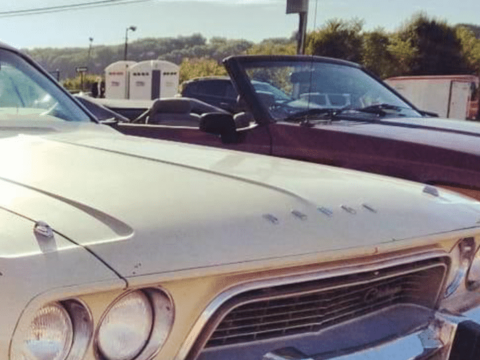

I own a very early LA built base model ‘70 Challenger. I noticed that the drivers side fender was drilled for a hood pin and a hole for the pin lanyard. The passenger side was not drilled as such. I ended up finding a flat hood car with factory pins and bezels and no pins or lanyards here in town and bought everything from that car for one dollar. Shortly after I purchased a power bulge hood so I already had the pins in place. The pic (not my car) I posted shows a flat hood with hood pins in place. So if they were ordered the factory installed.

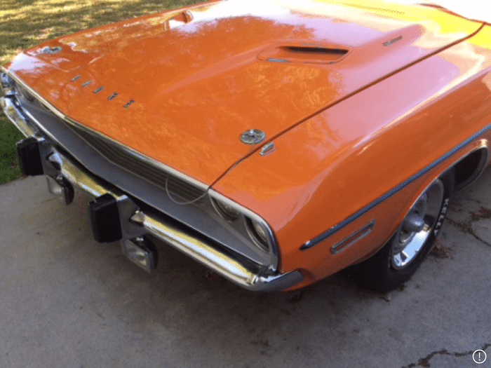

/sixchall here again, yes a dollar for OEM parts is pretty cool. But, there were other things on a base 318 ‘70 Challenger in a guys backyard. A buck for the OEM hood pins was just one deal off that car. It was a green exterior green interior car, many moons ago. I had these installed in my flat hood until I scored the power bulge hood. Remember my car, like John Griffiths car is a Slant6 car from day one. Pic is hood of my Challenger.

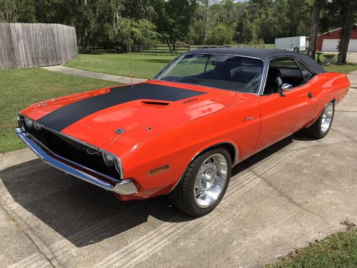

I have seen the smaller fender mounted turn signal indicators in paint as well as chrome. The smaller ones are fastened from underneath where the larger ones secure from above. Mine seem to be positioned as the ‘73-‘74 Challengers. Why this is I not sure of, I’m posting a pic (not my car) of the later positioning. Mine were like this when I bought it, so I gave it no notice until now.
