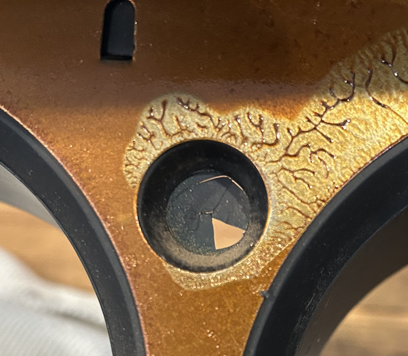

Currently replacing the woodgrain overlay on my '73 Cuda. Went to wipe off the turn indicator lenses and one just crumbled. Trying to find replacements like this one:

OK, I found and ordered a set of these:
The link in my first post states they include a new strip of plastic to "weld" the new lenses in carefully with a soldering iron. Not sure if the lenses from Dante's includes this or not. Open to suggestions on how to "weld" in the new lenses when they arrive.

The lenses are melted in place from the factory. So when you remove the old worn out ones, you'll take some of the plastic with them. So, yes, you're going to need to solder a couple of small dabs of plastic to secure the new lenses.
