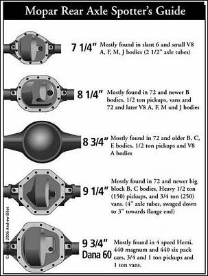

Rear axle ID chart
ramenth
Oct 7, 2009
2,106
107
Beaver Dams, NY

Hello ramenth, Thanks for the informative post. My question is about the 7 1/4" rear axle and I hope it is up your alley. I have a 1970 Challenger 318 V8, auto trans. Would you happen to know what the standard gear ratio was? Were other ratios optional on the 7 1/4?
