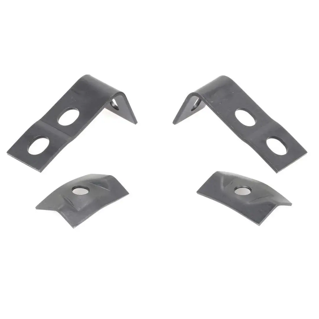

Hello,
Swapped my 73 to a 71-72 bumper/valance combo with bumperettes but I want to verify how theyre meant to mount. All AMD parts (for better or worse) and didnt come with any explanation, bolts, etc. I have the 2 piece brackets for each side but want to make sure I bolt em up properly. Anyone have pictures or can explain? Thanks

I dont have a pic on hand, but here's a pic of the brackets. I guess im trying to figure out how the 2 different brackets are meant to be oriented and mounted.

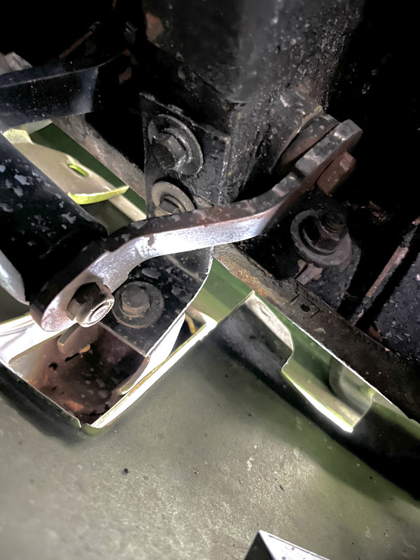

Look at the frame rails, the 2 bolt section bolts up there. The other end, goes to the bumper guard. I'll try to get a pic.
