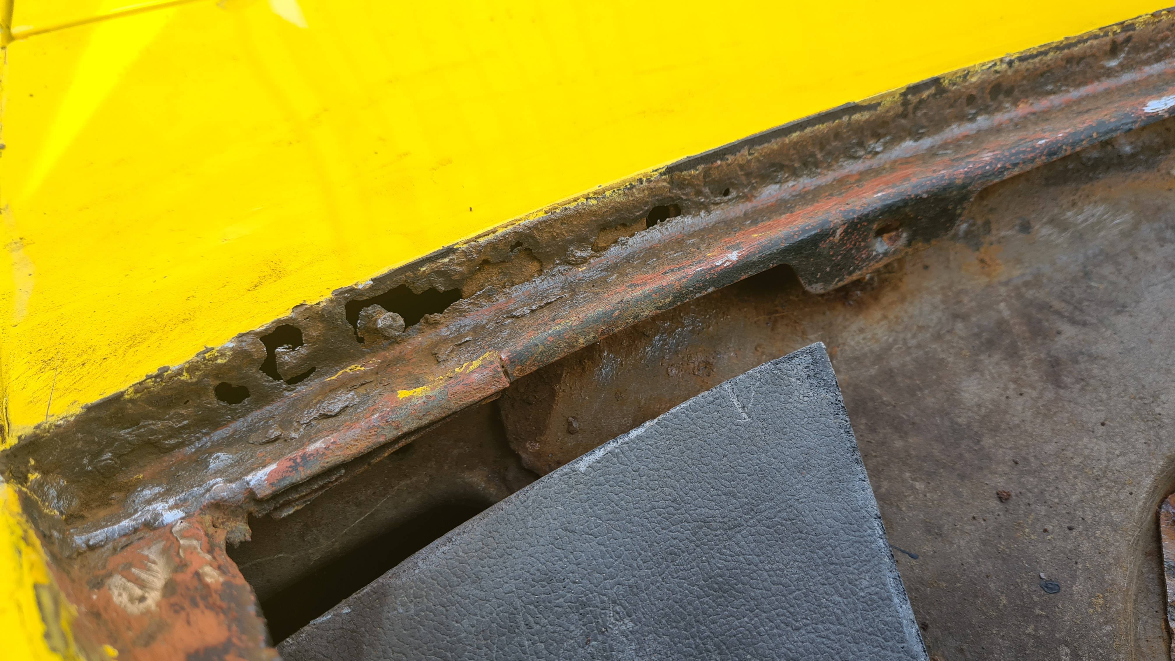

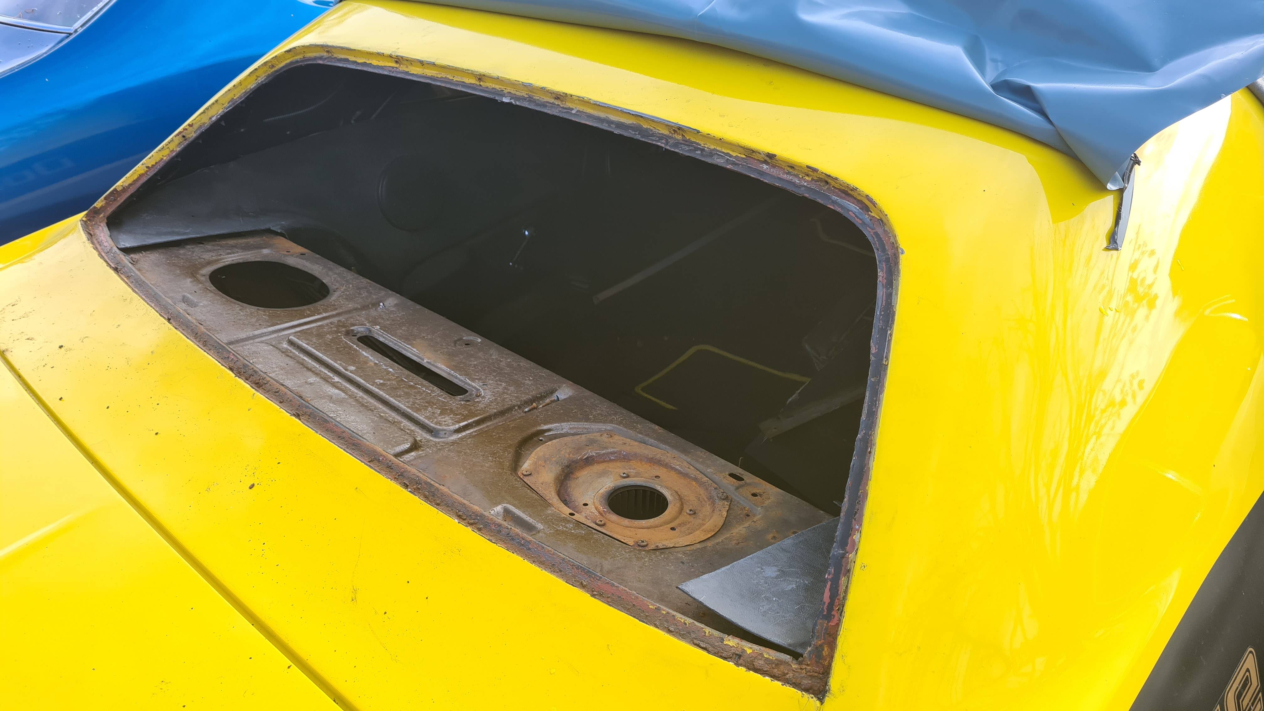

I cleaned the bottom channel on my Cuda really well and coated it with POR-15 before putting the back glass back in. That bottom channel has nowhere to drain and if water gets in there it just sits there, eventually causing it to rust out. Quite often, that's how water ends up getting into the trunk and eventually rusting out the lower quarterpanels and trunk floor. I did this about 20 years ago and I have not had a rust problem since then, even after the car sat parked outside for 3 straight years.
Thanks. Yes, I did that, it was getting really nasty.
Any special tip on how to sit the glass? Just apply the sealant and sit the glass on top?

That's really bad, I would recommend replacing the whole dutchman panel before putting the back glass back in! That looks a lot like mine did when I got my car. I didn't put my back glass back in myself, my buddy at the bodyshop did it. If I remember right, he put a couple of little rubber spacers at the bottom to keep the glass in the right place while the urethane sealer set up.
Fix the rust first, don't just cover it up. Liquid butyl rubber is the trick. The local Tint shop used it when removing rear glass for tinting on older cars. No leaks on all of the E-bodies I had over the years with it.
Yes, i spent a good time brushing, sandpapering applying body filler and painting already. It's all good to go! :D

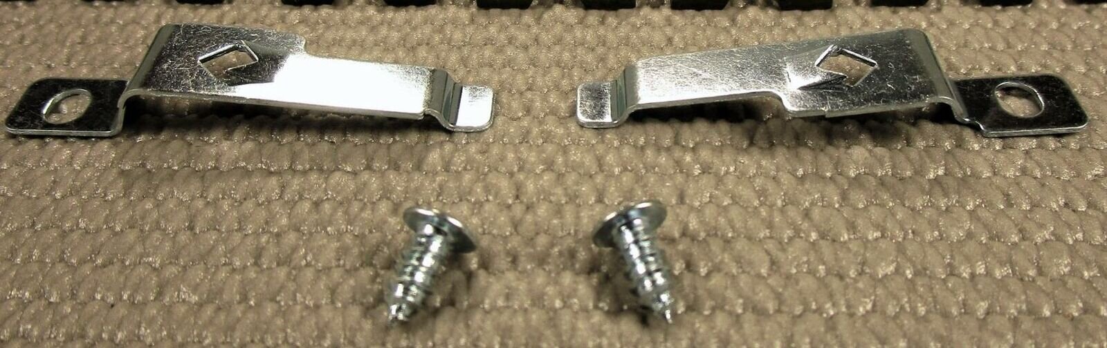

Don't forget to put in the moulding clips before you set the glass.
Will do. If not the sealant might prevent it to set in place?
Top and sides ones are OK, 3 missing but nothing at the bottom.
Had some screws in place and no clips so I got rid of the screws and filled the holes.

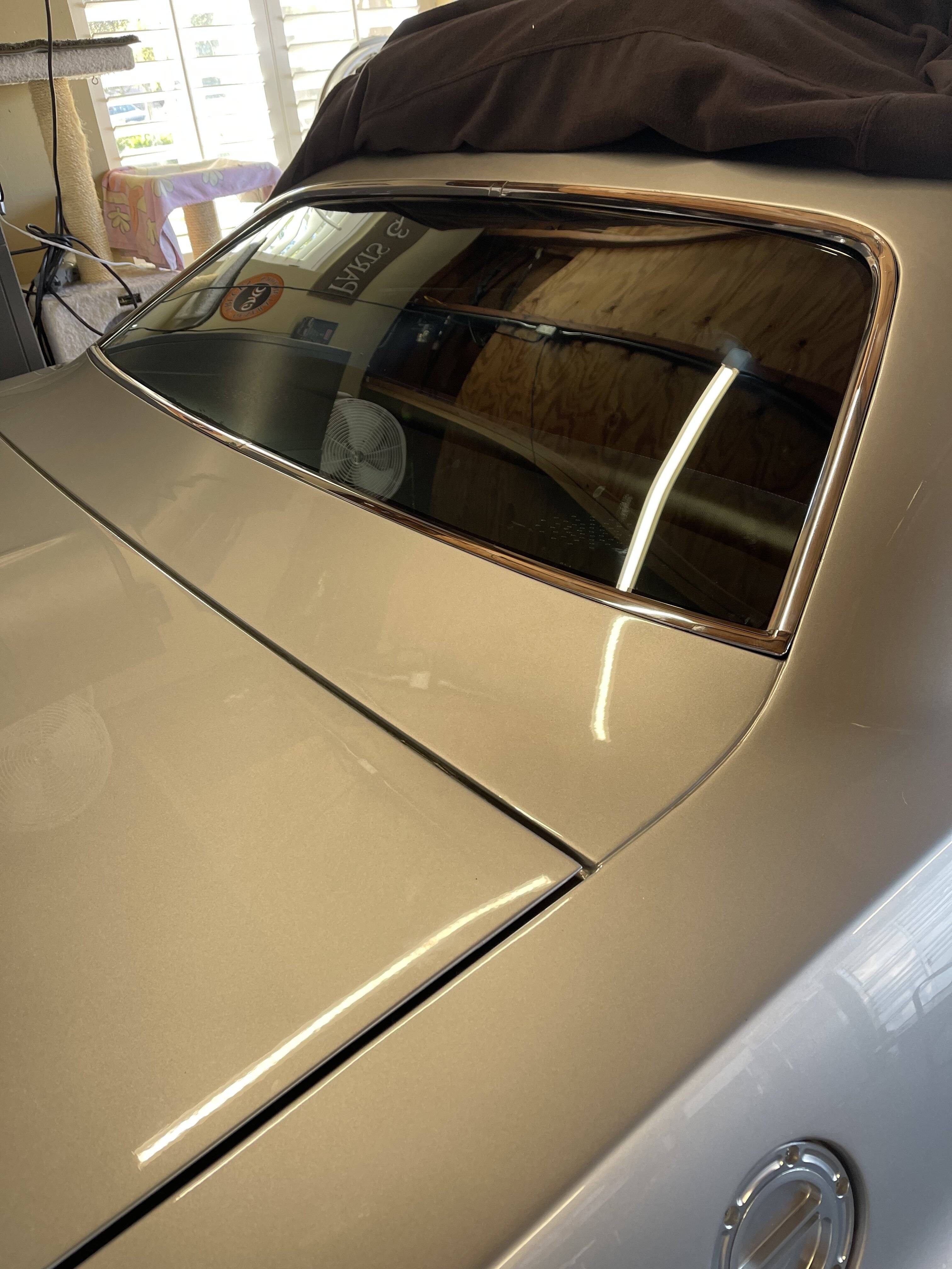

I would say to use the butil tape , this way you can move the glass a bit if needed also it’s a cleaner then the glue . I just did this and i had to slightly move the glass around
View attachment 87421I would say to use the butil tape , this way you can move the glass a bit if needed also it’s a cleaner then the glue . I just did this and i had to slightly move the glass around
Looks neat!
Thanks for the tip, didn't know about that tape. Can order for tomorrow. So just use the tape around and sit the glass on it? Apply the sealant around it after or not even that?
Body filler should not be under glass. just grind clean weld in bad areas. treat prime and paint if you want. place metal clips use rubber wedge to adjust widow placement. other above advice is good!

No sealant needed with the tape
And yeah put the glass in the spot where you want and push it down it’s a real sticky kinda tape but works great , you can also get it in certain thickness i believe i used 5/16
