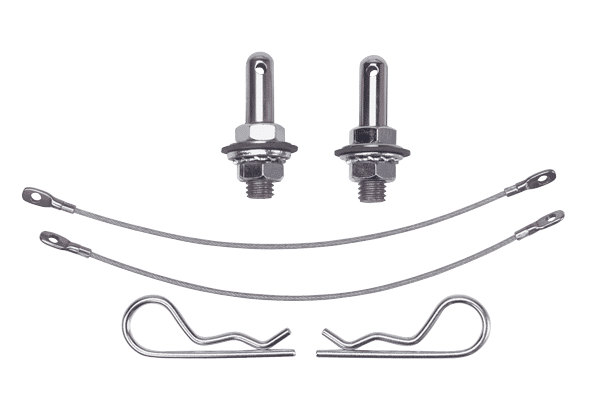

My Challenger is coded for the rear window louver package. The louvers are present, but I'm missing the small cables that attach to the clips (much like a hood pin) & keep them from getting lost. My question is this: where do the other end of the cables attach? Any help would be appreciated!

One end feeds on to the clip and the other end attaches to the louvre strut with a small self tapping screw. About were the first louvre meets the strut.
