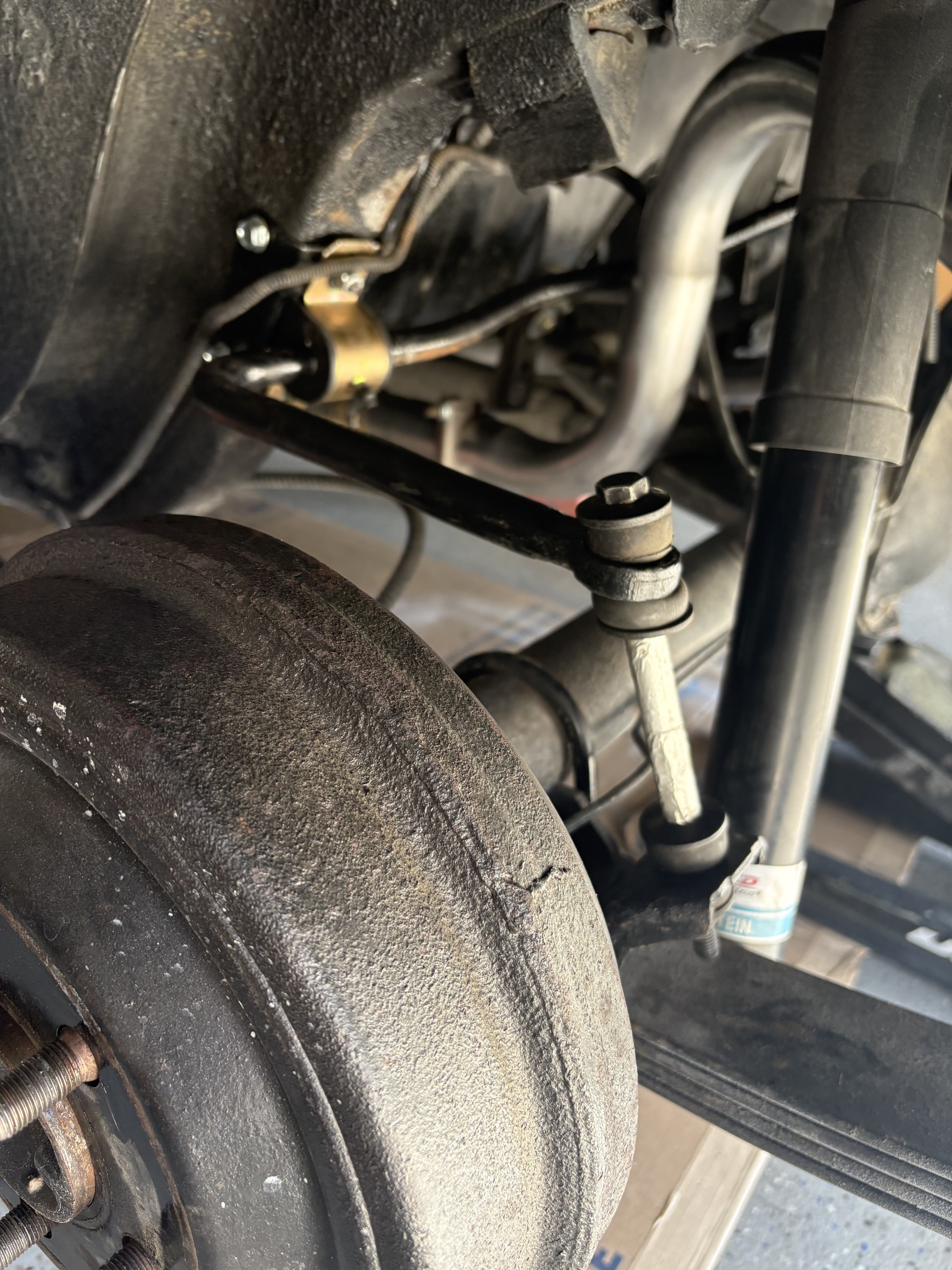

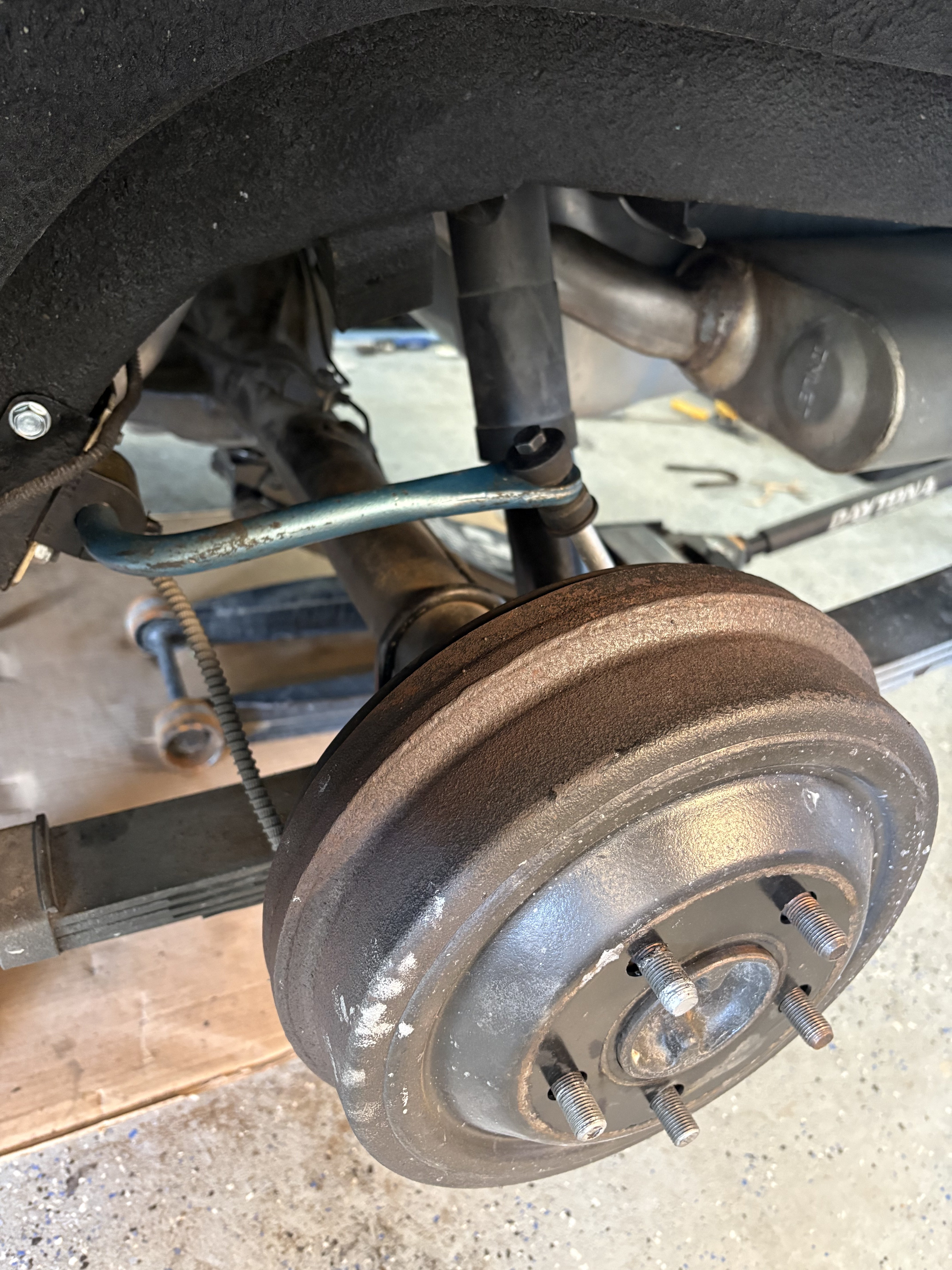

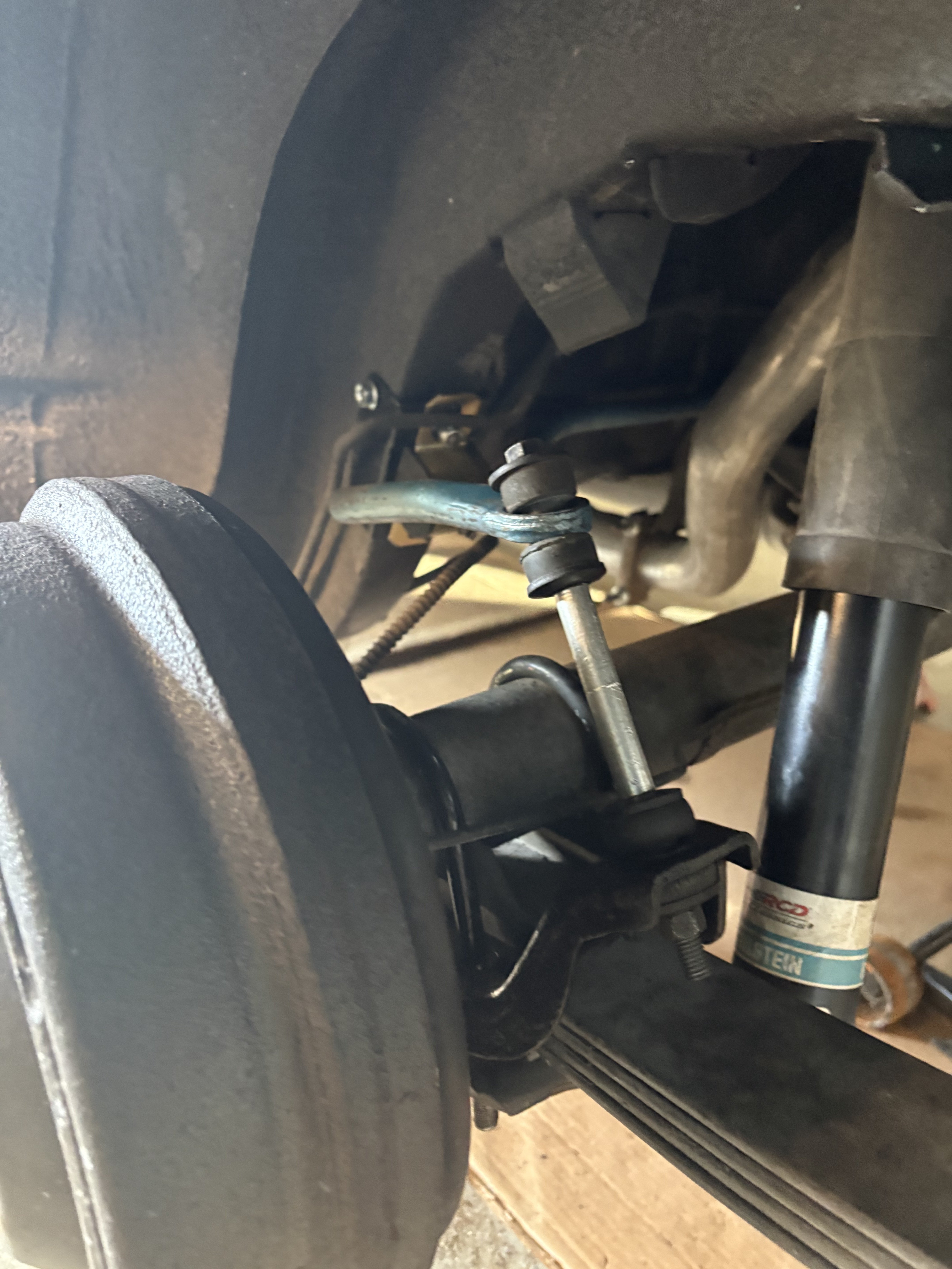

I sourced and installed an old origin rear sway bar in my fish. The Sway Bar is level with the car but the end connector holes do not sit over the axel bracket holes. So the end connector/bushings sit at about a 15-20 degree angle rather than straight up. I attached the frame mounts using the 10” diagram from the bottom of the frame to the first hole on the bottom of the mount as indicated. Here are a few photos of my end bushing position. It functions as mounted but may not be right. Any info or input on this would be appreciated. 🌴

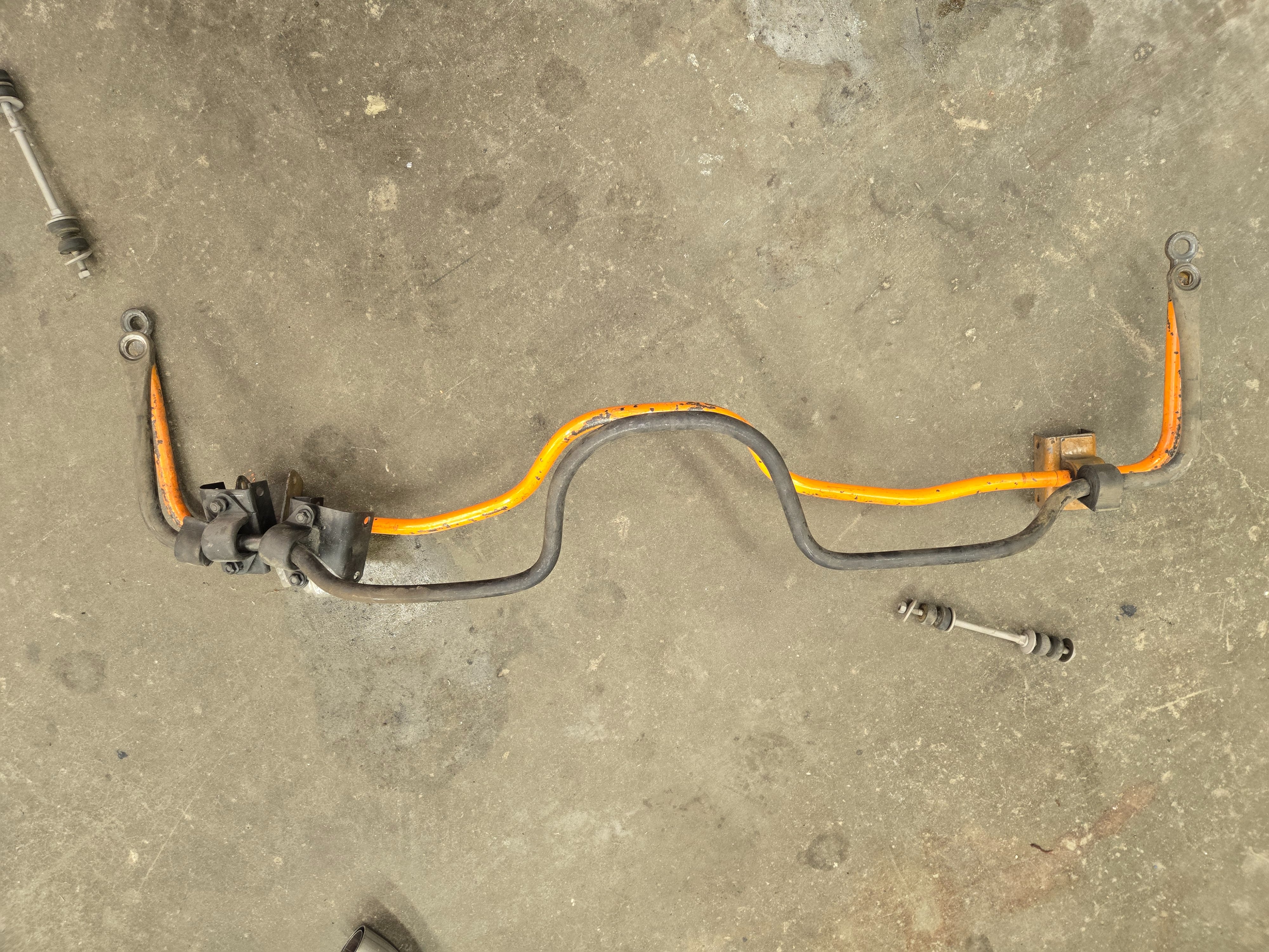

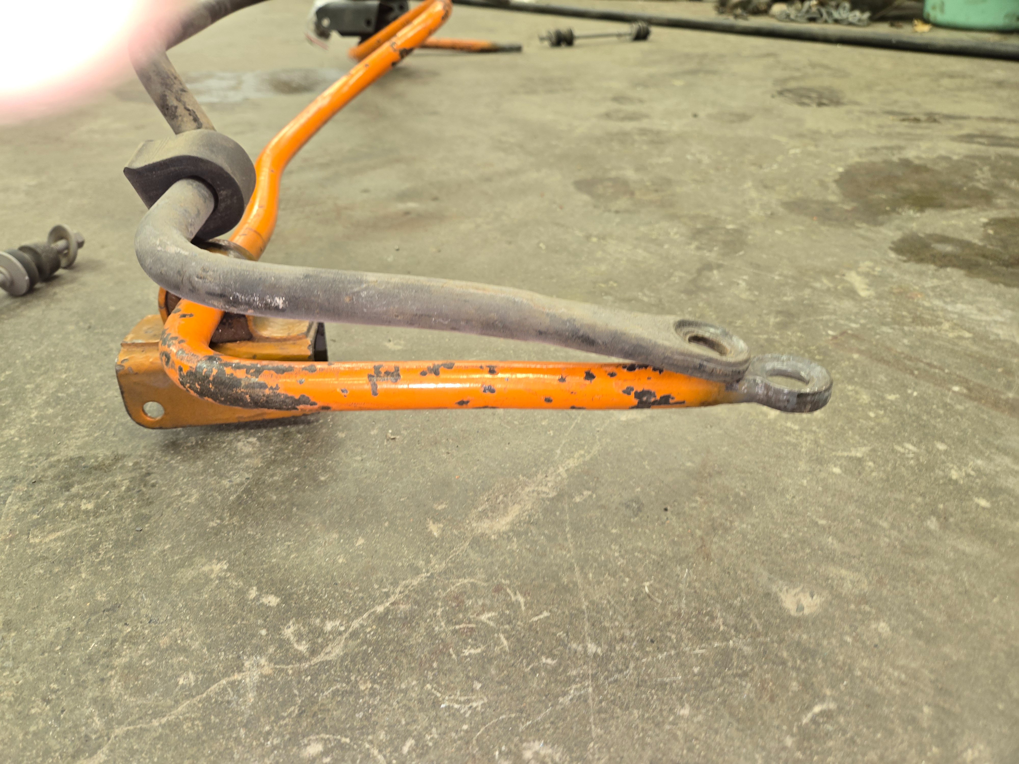

No the bar was positioned correctly, but it was a B Body Sway Bar not an E Body. That’s why it appeared odd. I just sourced an E Body Sway Bar so I’m good now. Here is a photo from MrCuda showing the difference. The Orange one is an E Body bar. 🌴

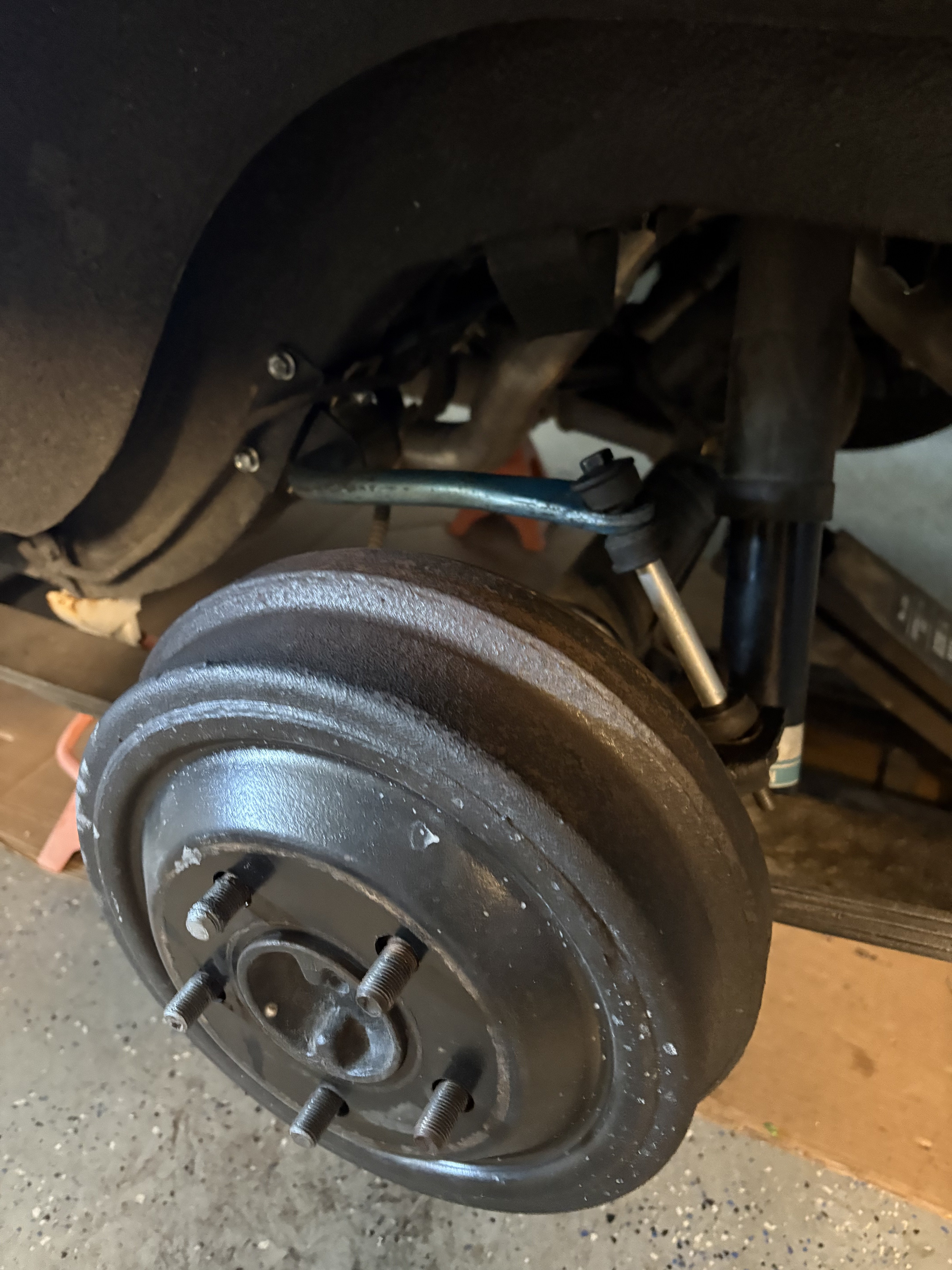

Just following up on my rear Sway Bar install. I finally got some time and finished the installation. Photo attached. Thank you again for all your input and sharing your knowledge. 🌴
