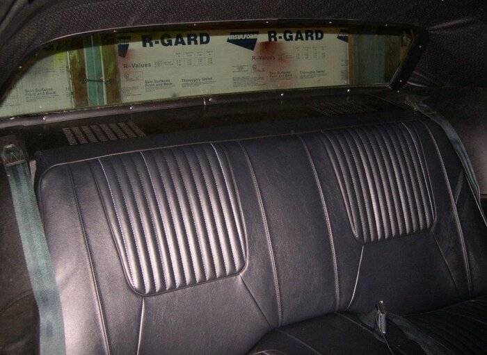

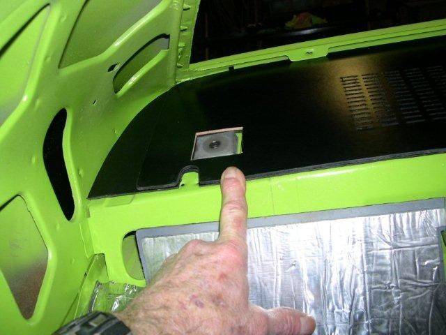

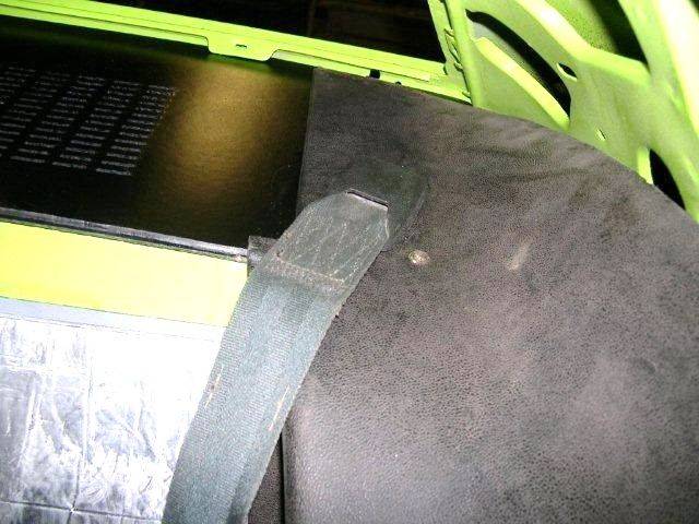

Rear seat shoulder belts for coupes were available in1970 (C14), as were front shoulder belts for convertibles, both extremely rare options...
