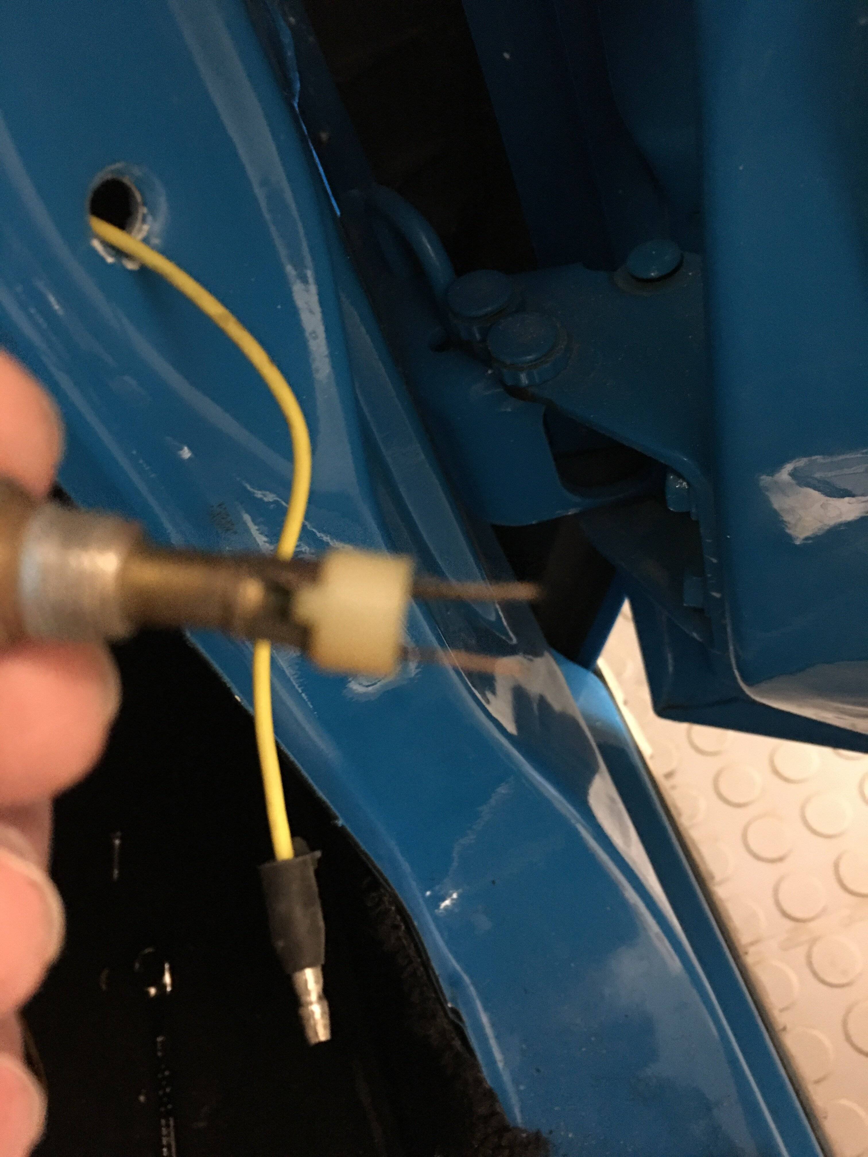

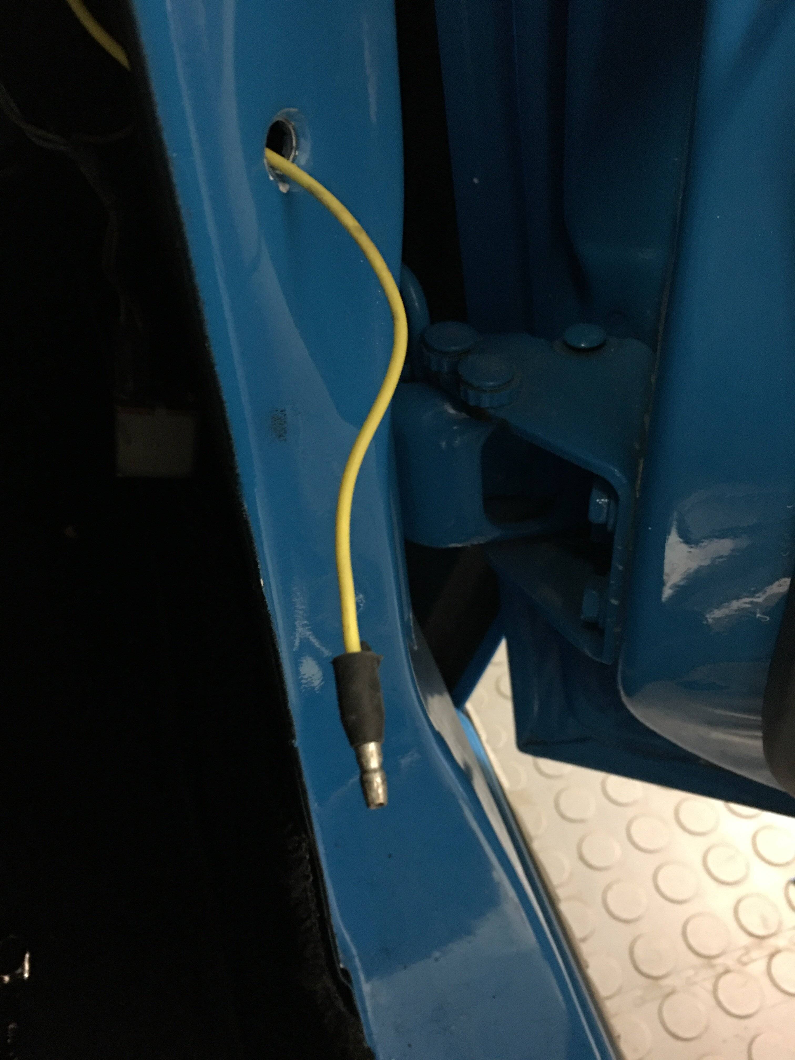

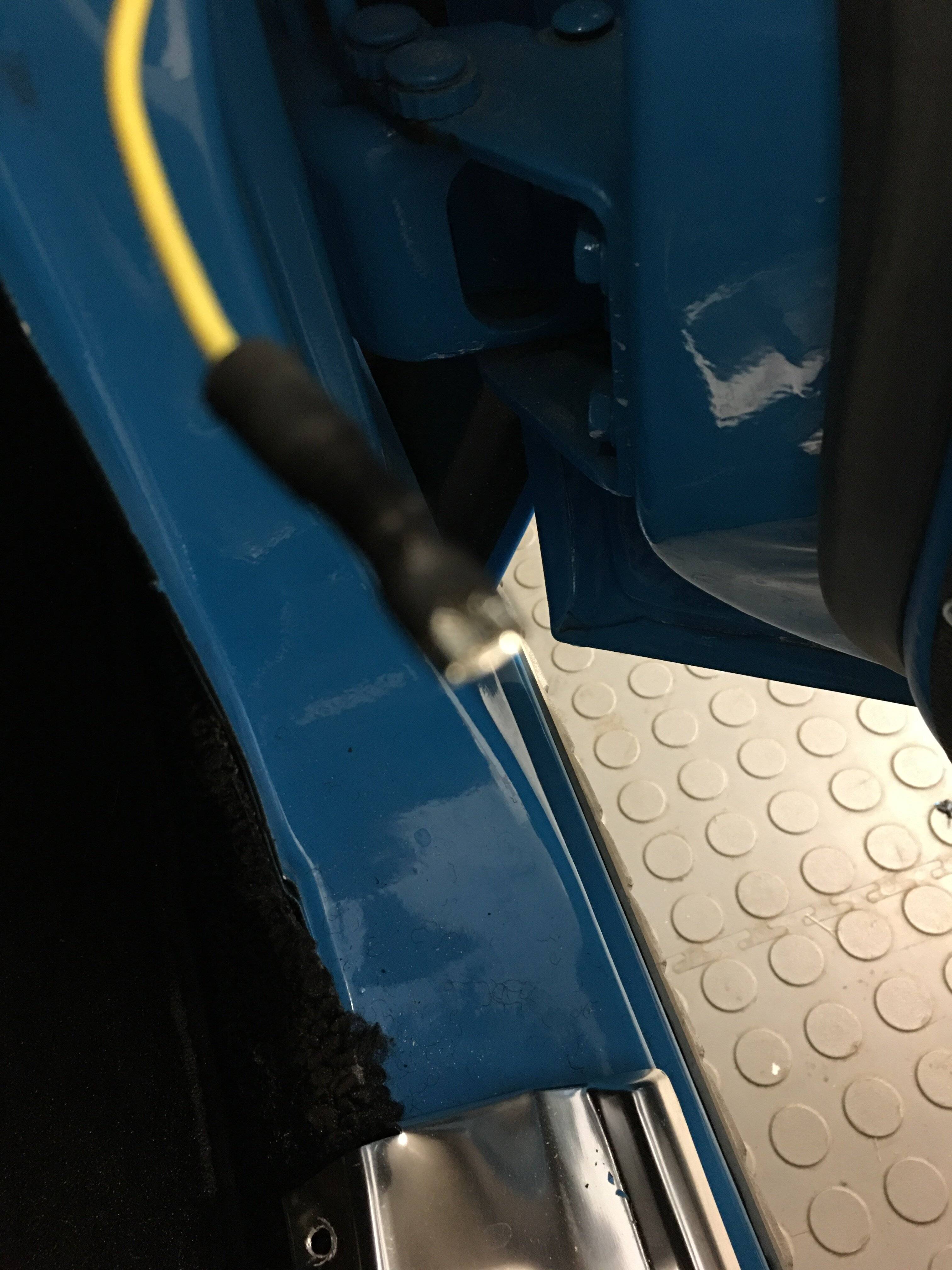

Decided to fix the RH door courtesy switch today. The yellow wire has a bullet connector on the main harness. The switch is a spade type. LH side has the spade connector. And the EWD shows that as well.
Did I miss something here? Or the A/M harness from Yearone wrong? I just heat shrunk a spade terminal on the bullet connector. Just wondering. Thanks

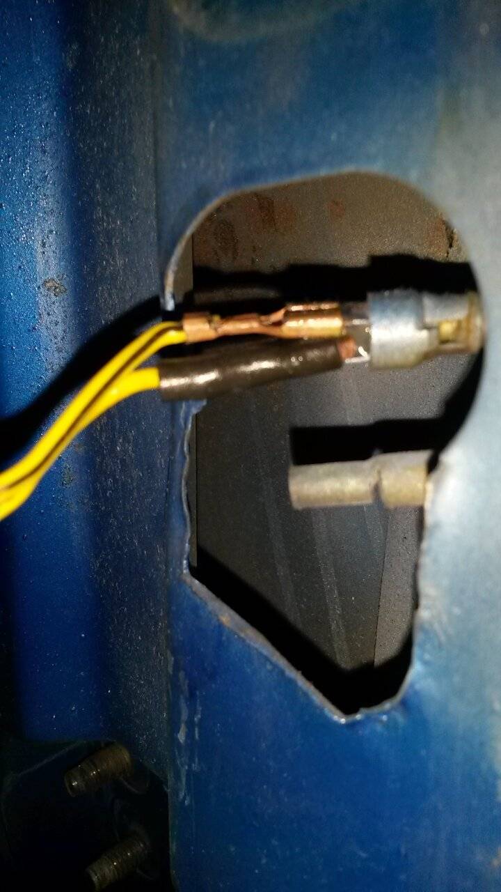

Thanks for the pic. My LH side also only has one wire connected. The yellow spade.
Mine works fine on either side now, but that bullet connector threw me off, as my switches have two blade male connectors but, only one is used. ?? Maybe yours have the time delay….

Yes mine has time delay. and I recall drivers side has pins.
