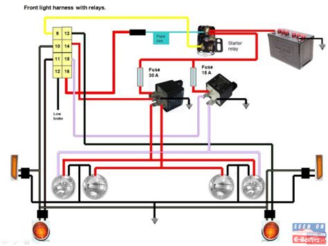

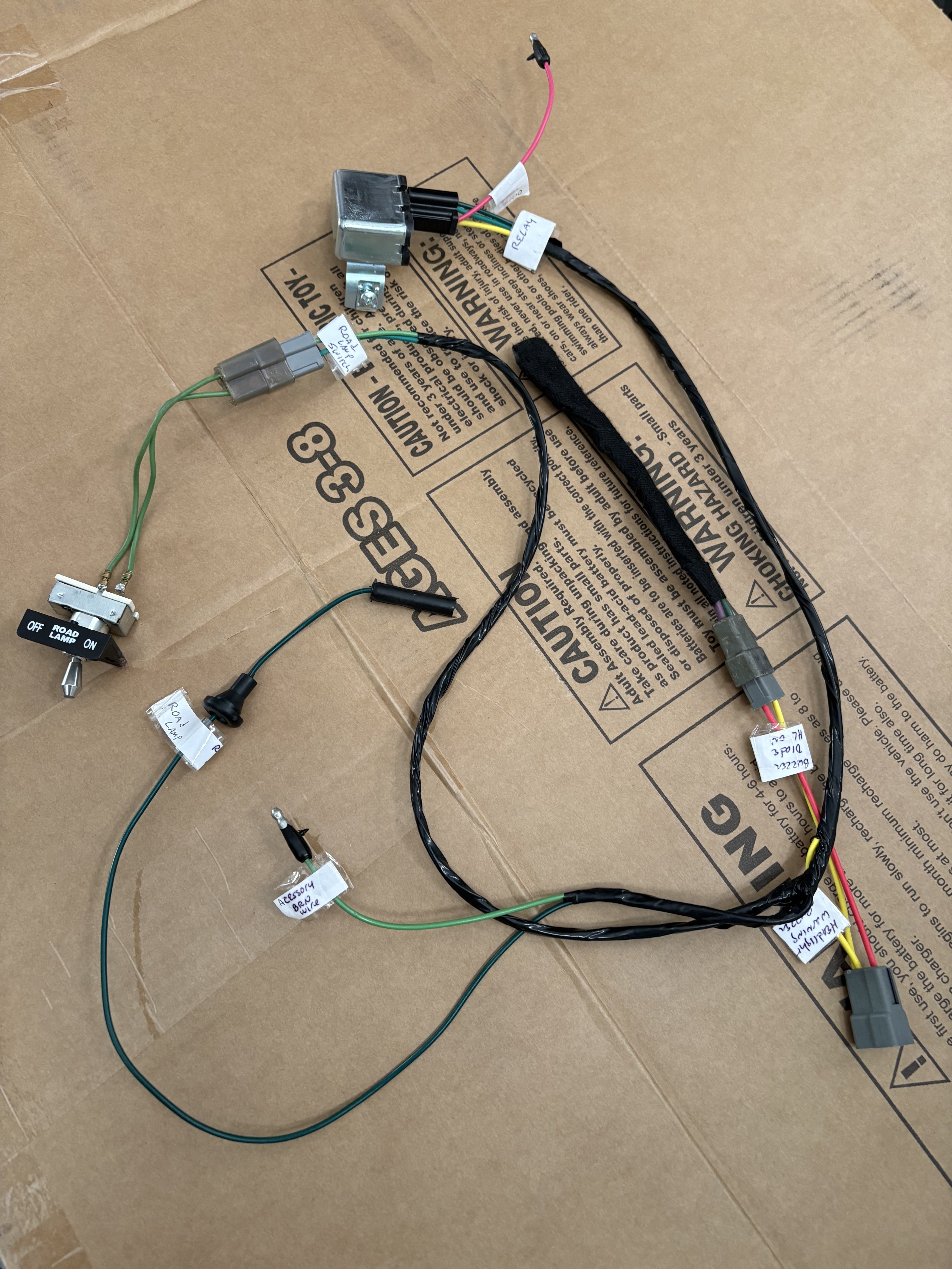

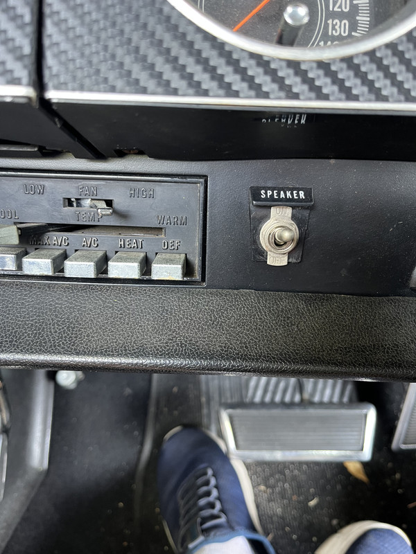

Just installed road lamps this weekend, wasn't easy because p&g classics shipped the parts 4 times before everything came.Saved a lot of money making my own harness and using a Bosch relay and a switch so only paid 445 thanks to the xmas sale.

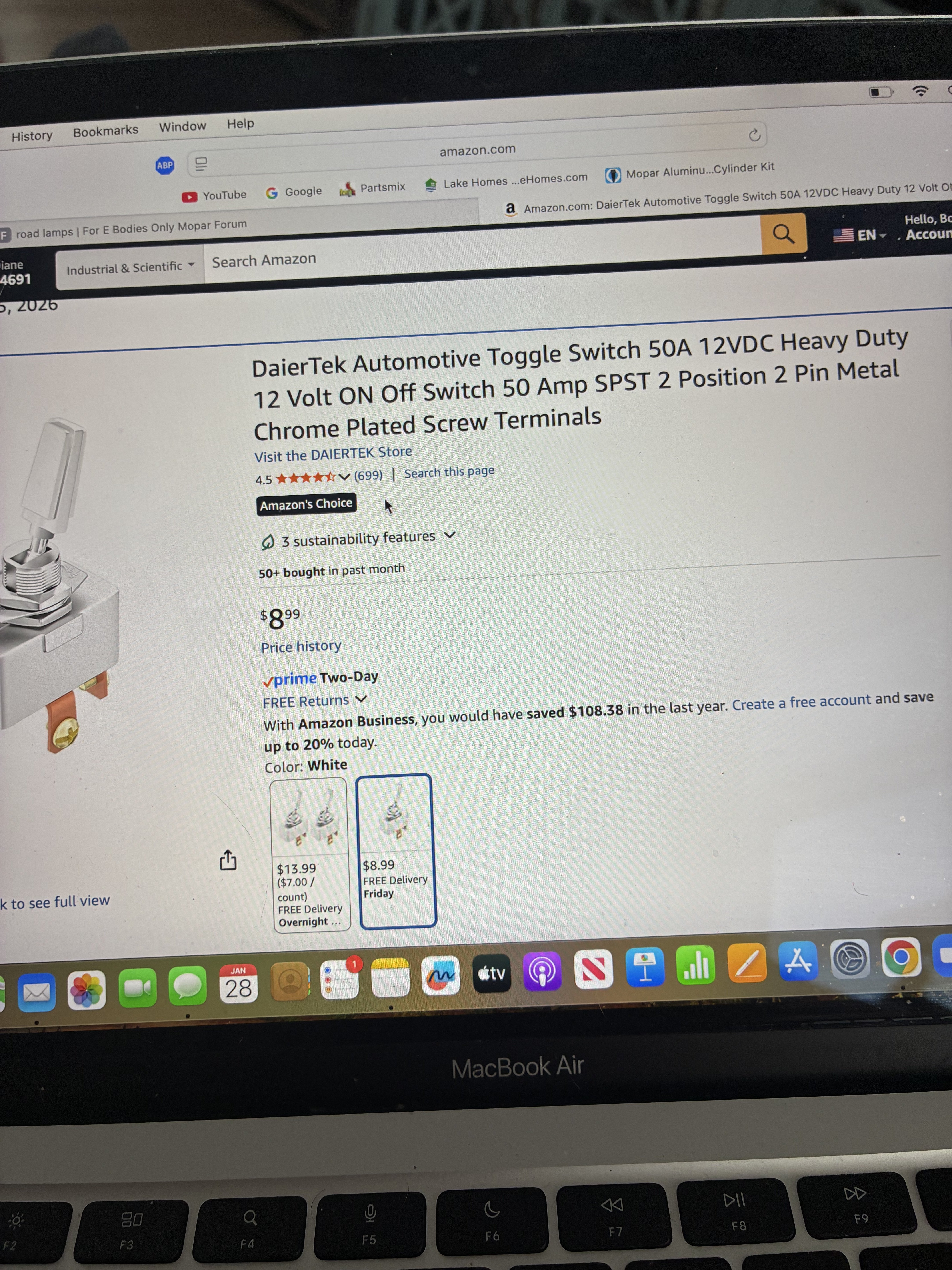

30/40 amp relay you can get on amazon Bosch is very good and the switch from amazon also.
also use a plastic harness connector for the relay so the wires don't short out or get mixed up.also use two fuses one under the dash and one from the battery to the relay.good luck.

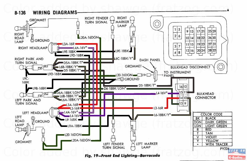

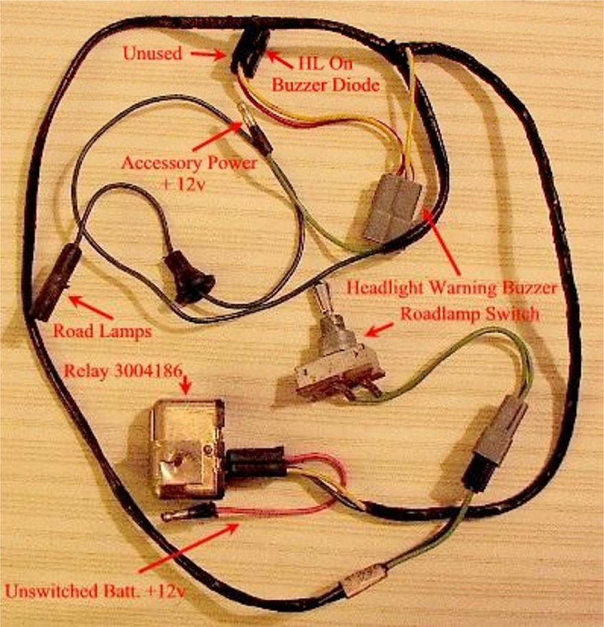

Thanks for info. I’m curious what did you use for Relay 3004186 shown in attached diagram? I made a diode as seen in the attached photo. Once wrapped in cloth tape it looks original. I have completed a road lamp harness except for the Relay 3004186. Maybe you went another route. I would like to hear how you made your harness if different from the diagram. Also very NICE Fish. 🌴
