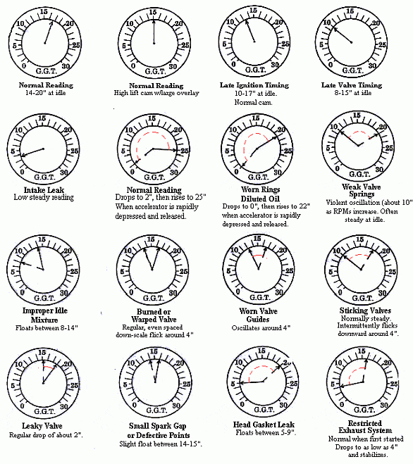

Maybe I missed that you said you had a steady vacuum reading. I had engines run like that. Burnt, bent, sticking valve or other. Use an vacuum gauge to diagnose. Process of elimination before you tear into it.

Maybe I missed that you said you had a steady vacuum reading. I had engines run like that. Burnt, bent, sticking valve or other. Use an vacuum gauge to diagnose. Process of elimination before you tear into it. View attachment 139917
I haven't checked the vacuum advance. The vacuum is steady at 15, at idle. I'll also try the wire swap. Thanks
