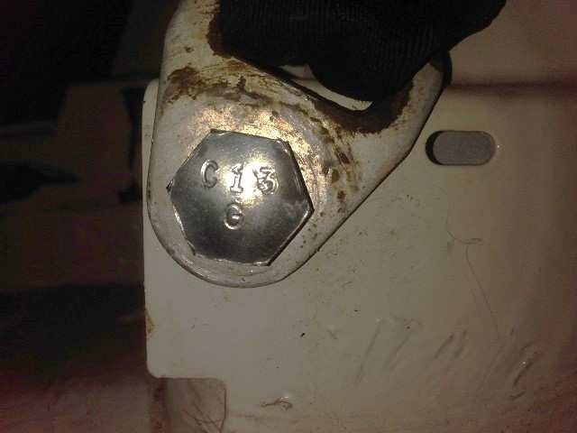

I copied this list form another forum. Strangely, my late production 1970 Barracuda convertible has 4 C13's. This info might help in getting the right ones for your car.
The Seat Belt Bolt number is stamped in the head of the bolt.
1970 10 bolts needed
  • C01 (Qty 2) Front Retractors (full threads)
  • C11 (Qty 6) Front Shoulders & Back Seat
  • C12 (Qty 2) Front Buckles
1971 10 bolts needed
  • C10 (Qty 2) Front Retractors
  • C11 (Qty 2) Front Shoulders
  • C13 (Qty 4) Back Seat
