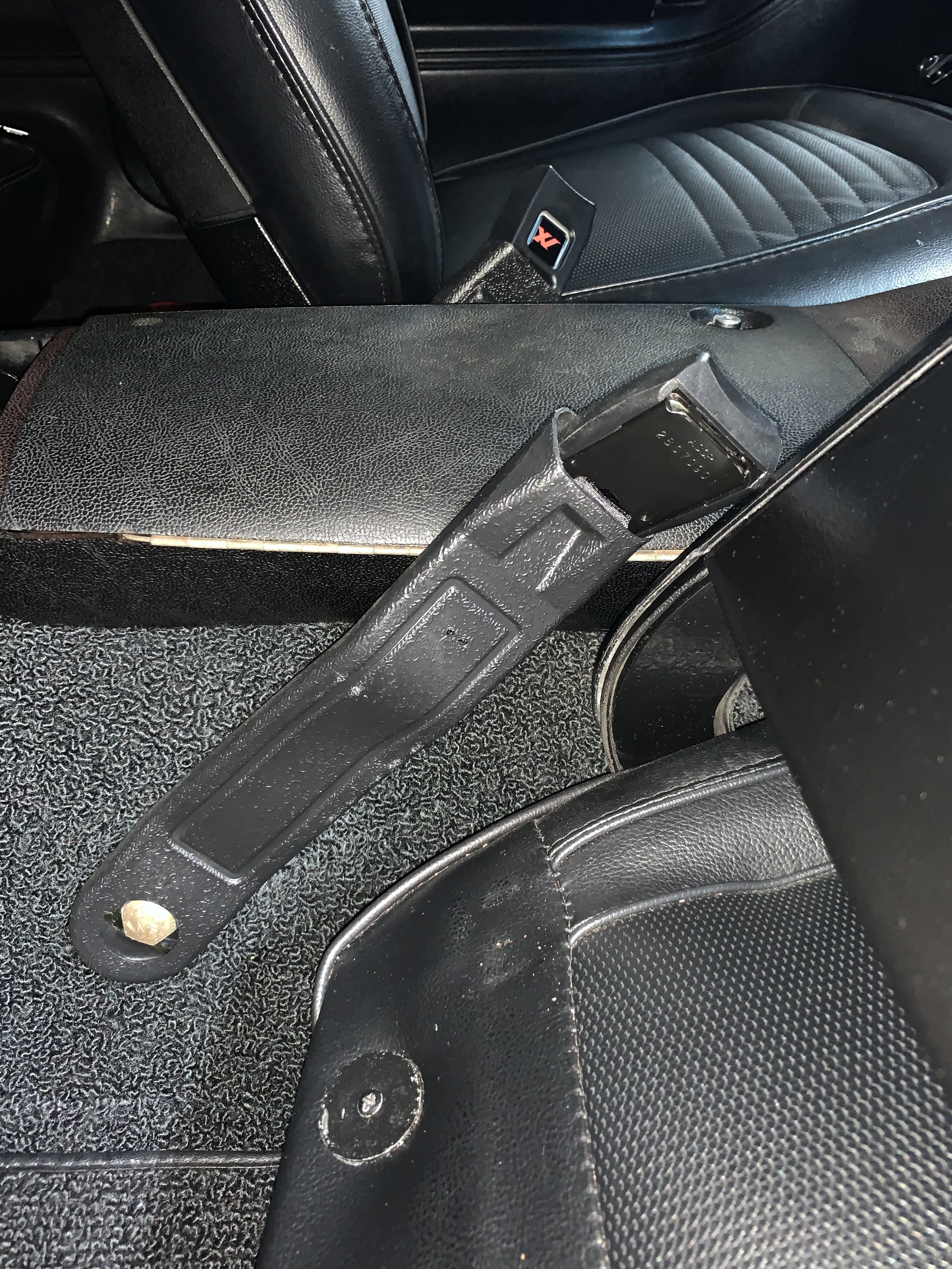

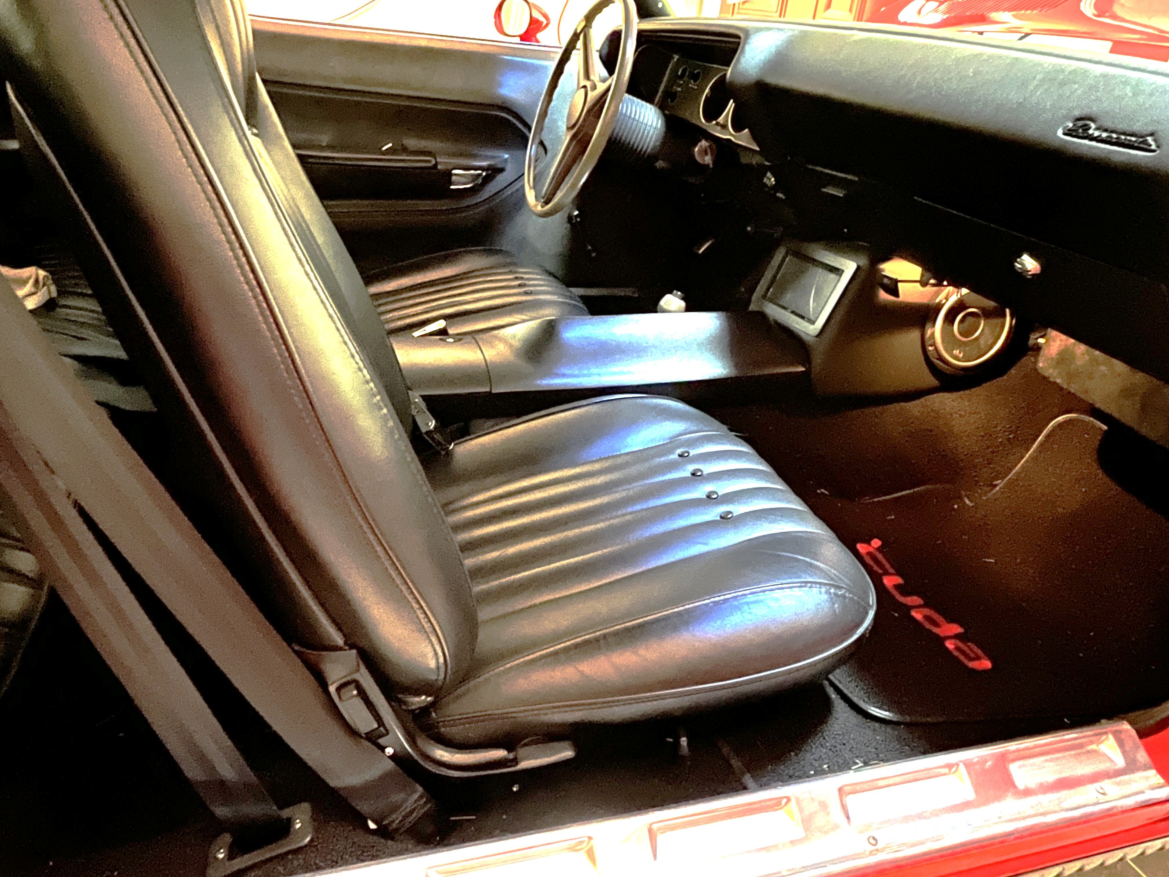

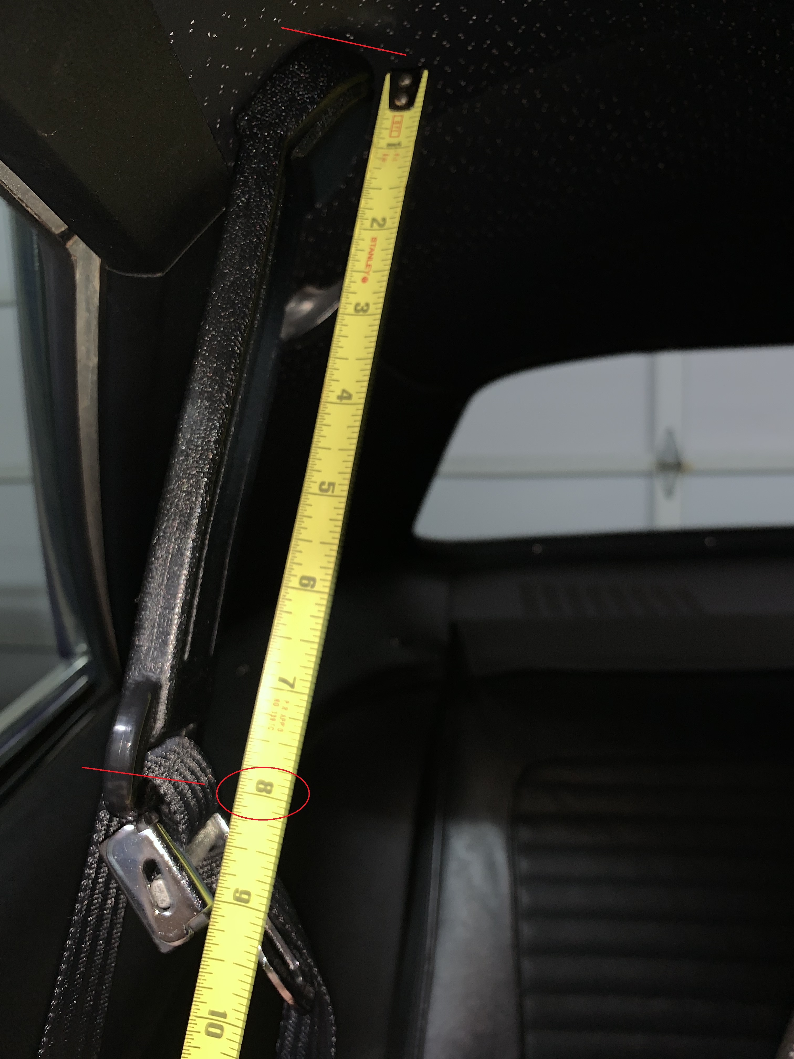

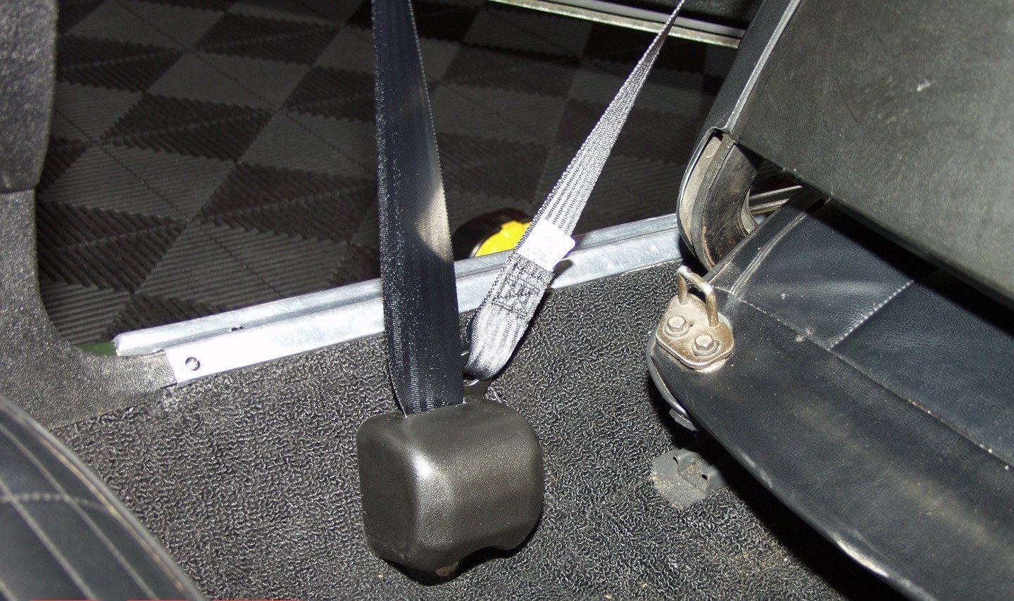

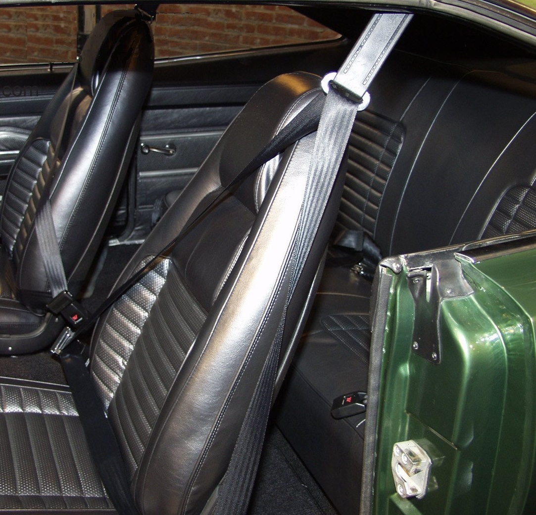

I used the aftermarket ones similar to what pschlosser posted in my Cuda. I welded a tab inside the rear side panels and mounted the retractor there out of sight with the shoulder belt coming up through the hole in the rear panel where the little ash try was. I definitely suggest you get the belts with the longest drop sash guide you can find to keep the shoulder belt from riding your neck when you use them.
