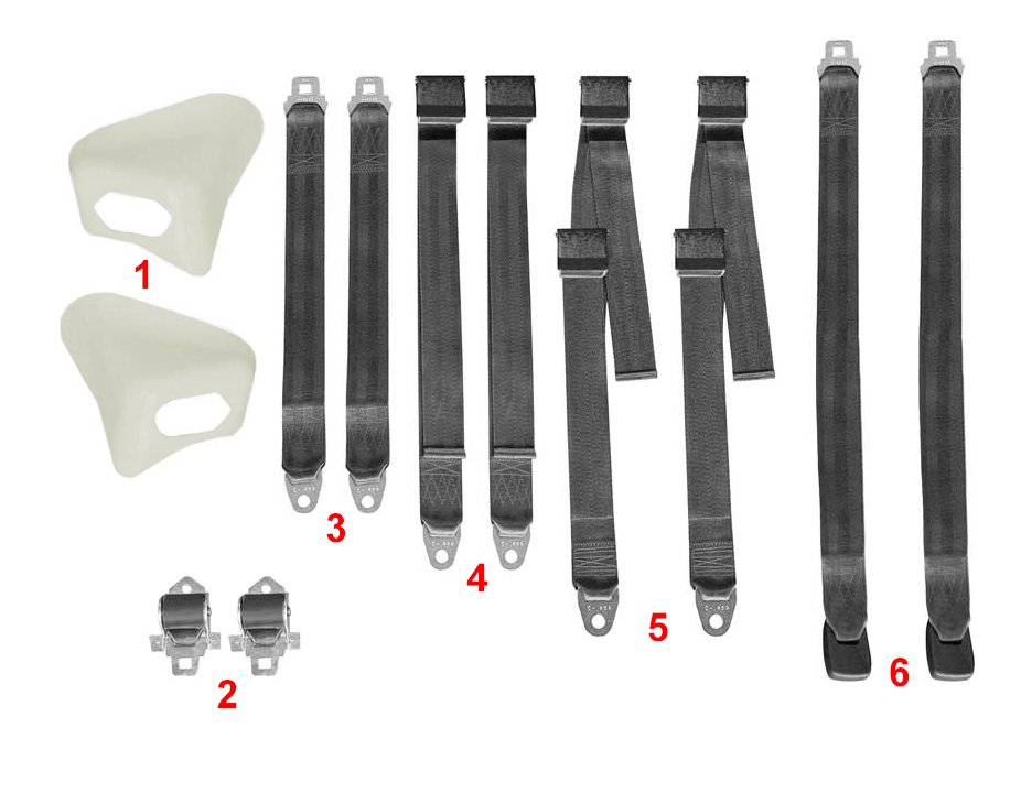

Pulled all my seat belts out of the car 20 years ago, the back seat belts were shot due to the mouse nests rusting everything. Now am trying to piece together the missing pieces and would like some help to identify what I am missing. Below is a repo set for purposes of identification, I tried to fill in what I know. Thanks,
1. Front bucket seat belt retractor covers
2. Front bucket seat belt retractors (outside back corner of bucket seats mounted to floor)
3. ???
4. ???
5. ???
6. Front bucket seat shoulder belts

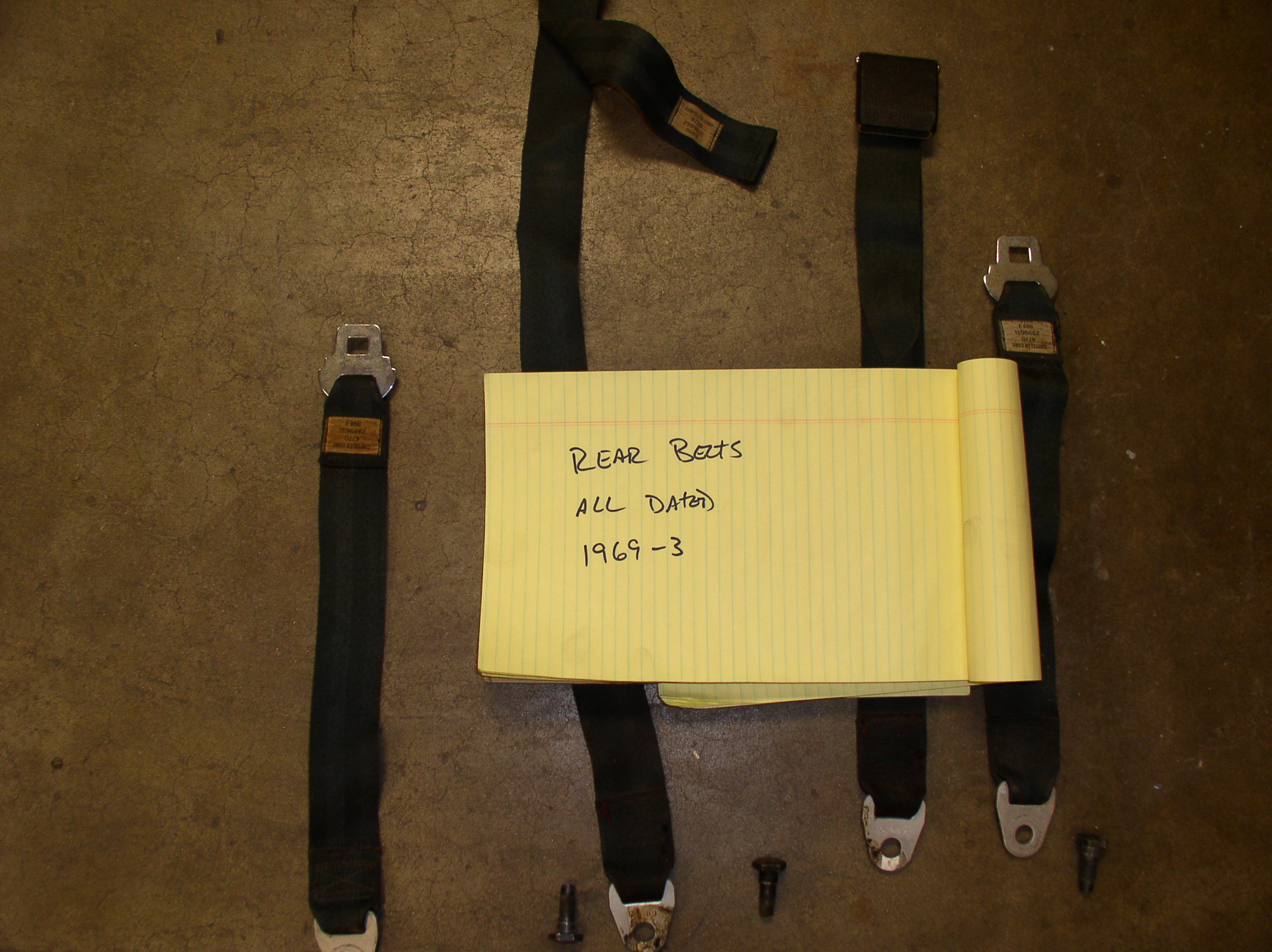

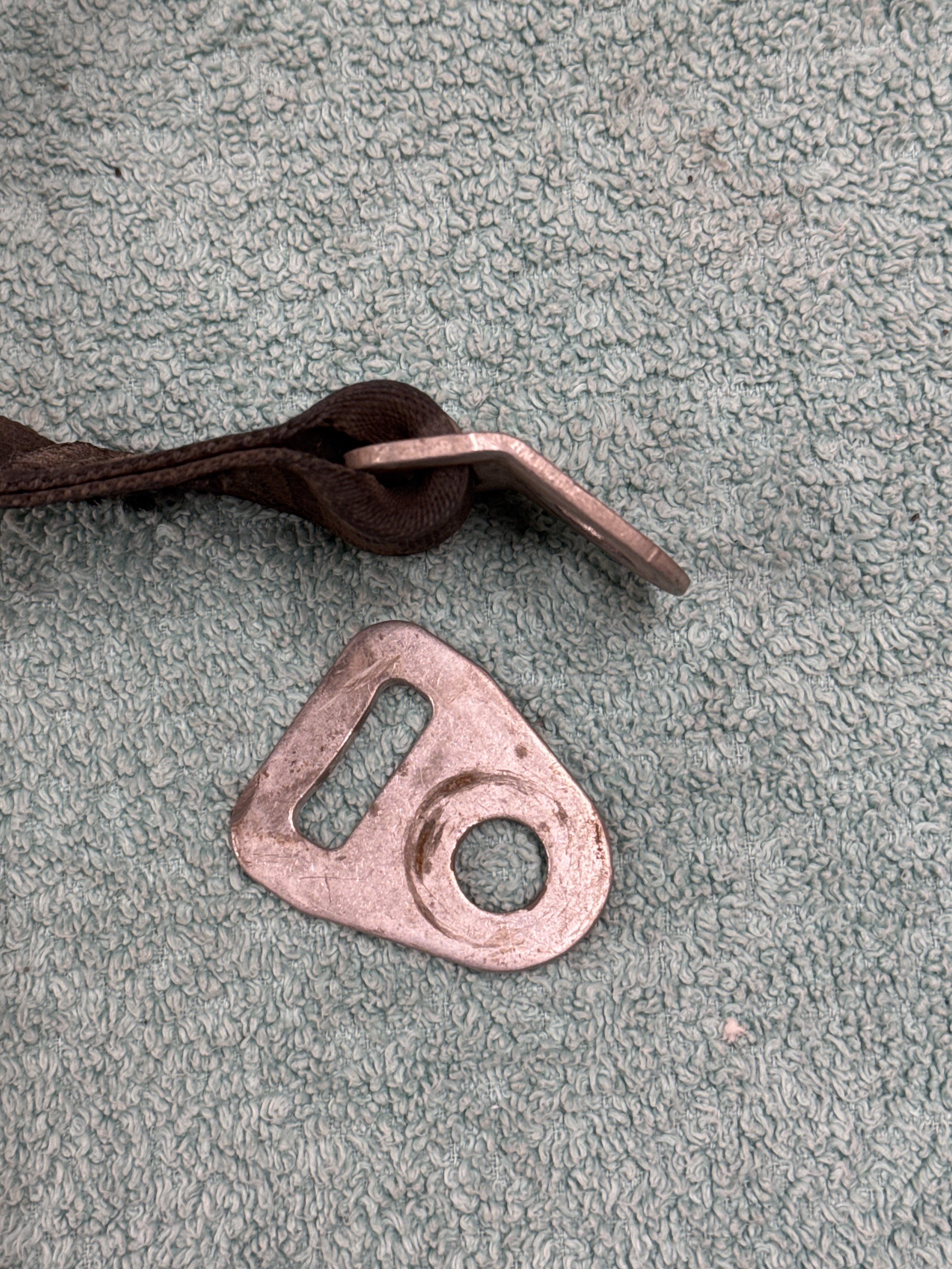

Another question, should the back seat anchors be the flat or angled type?

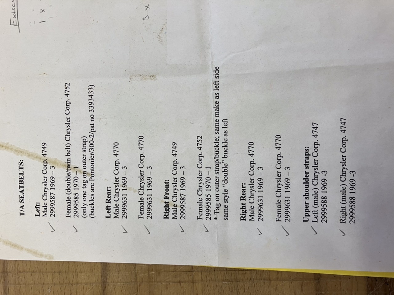

@Lunchbox Levi, I put this list of numbers together for my 70 Challenger. Might be helpful.
On the flat vs bent back seat anchors. See pic below from an original T/A = flat
@floyd Thanks Bruce! Exactly what I was looking for. Looks like ow have a compete set of parts to rebuild my set.
