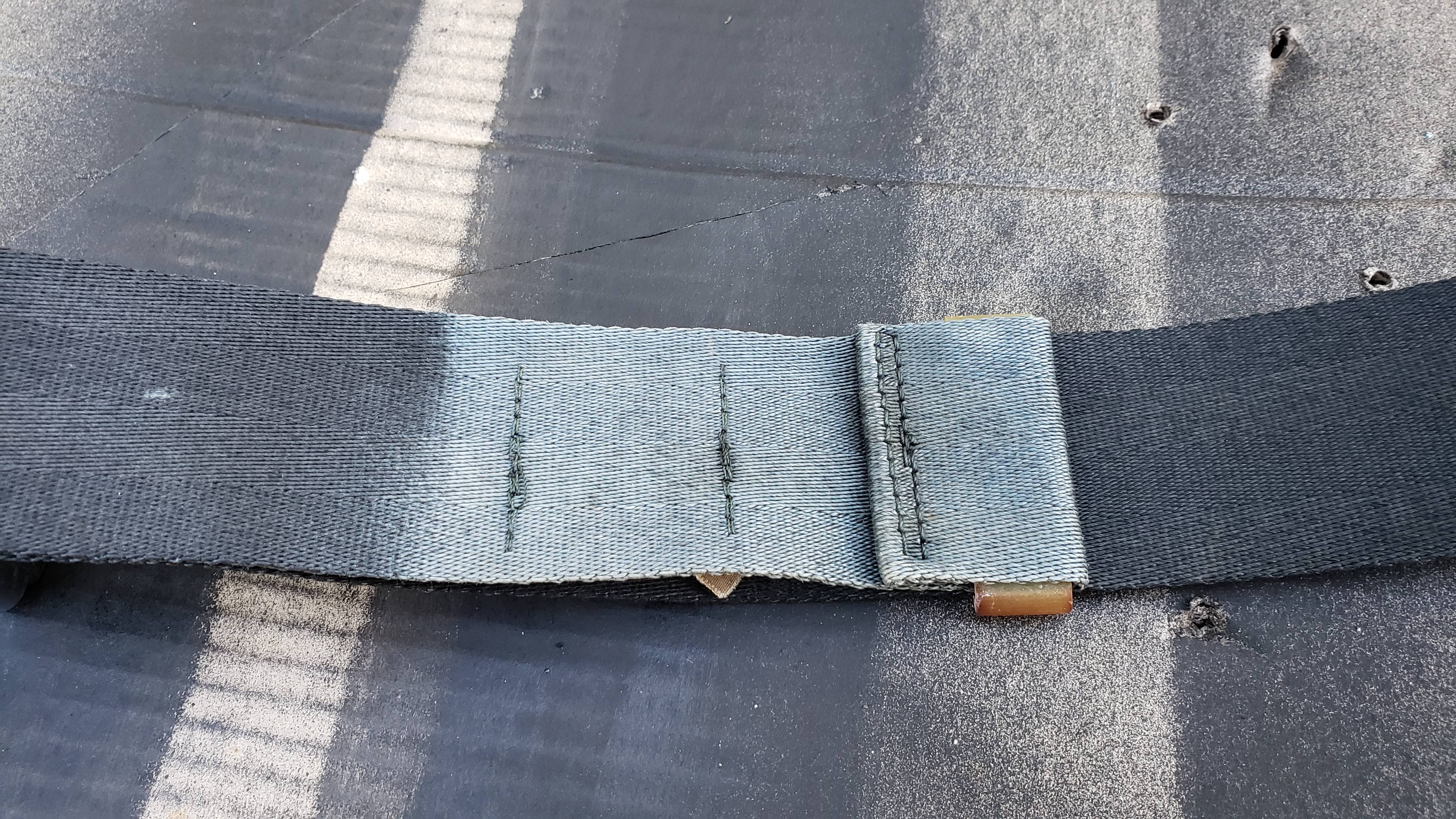

My belts were very faded/dirty. I boiled them with several water changes, until the water was clean. Then I "fogged" them with black spray dye and wiped the excess off which allowed the pressure to "push" the die into the fabric and also preventing the stiffness that comes with spray dye. The results are original looking FANTASTIC. I am so happy with the results. You can see the before and after in the picture.
