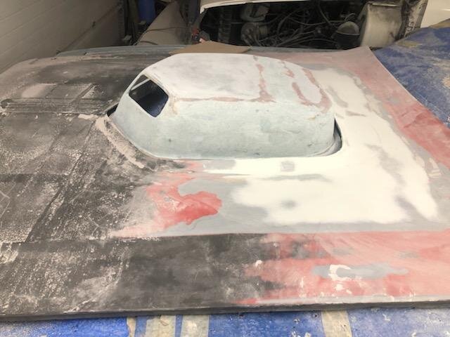

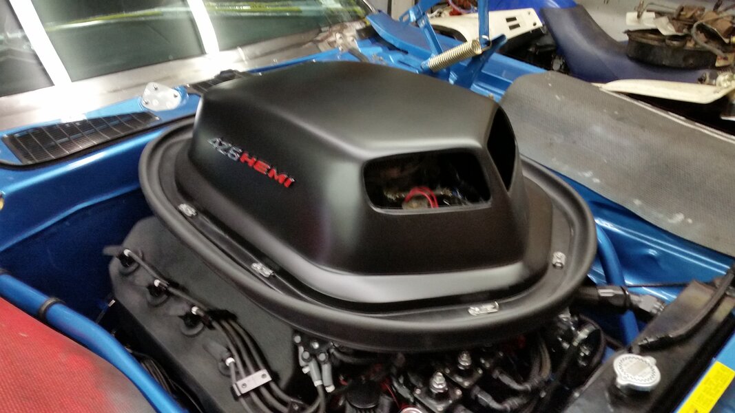

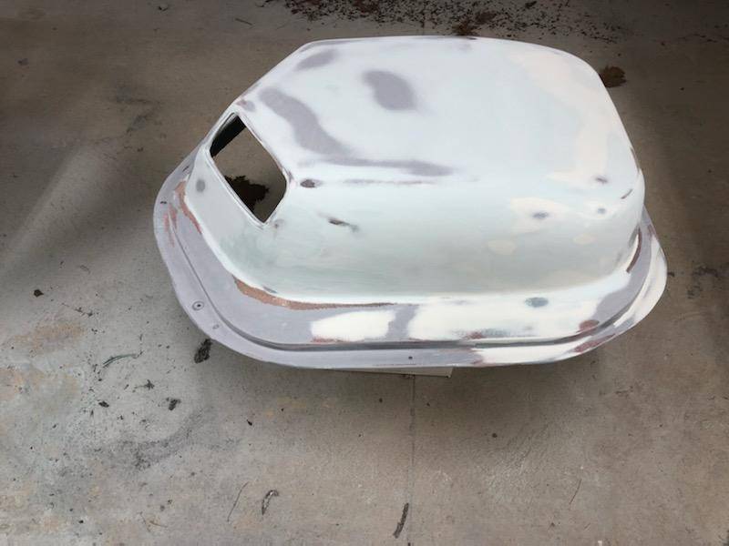

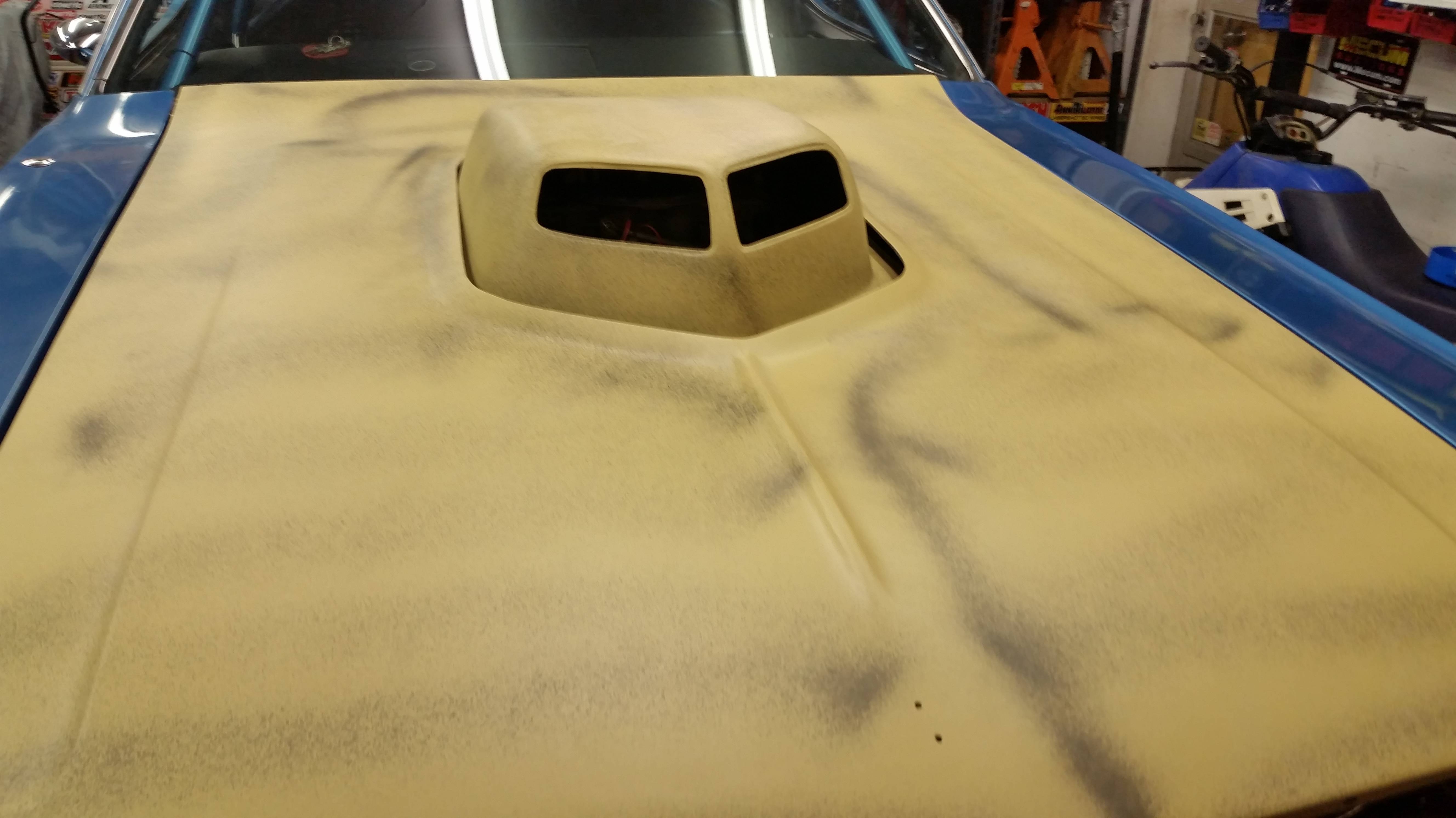

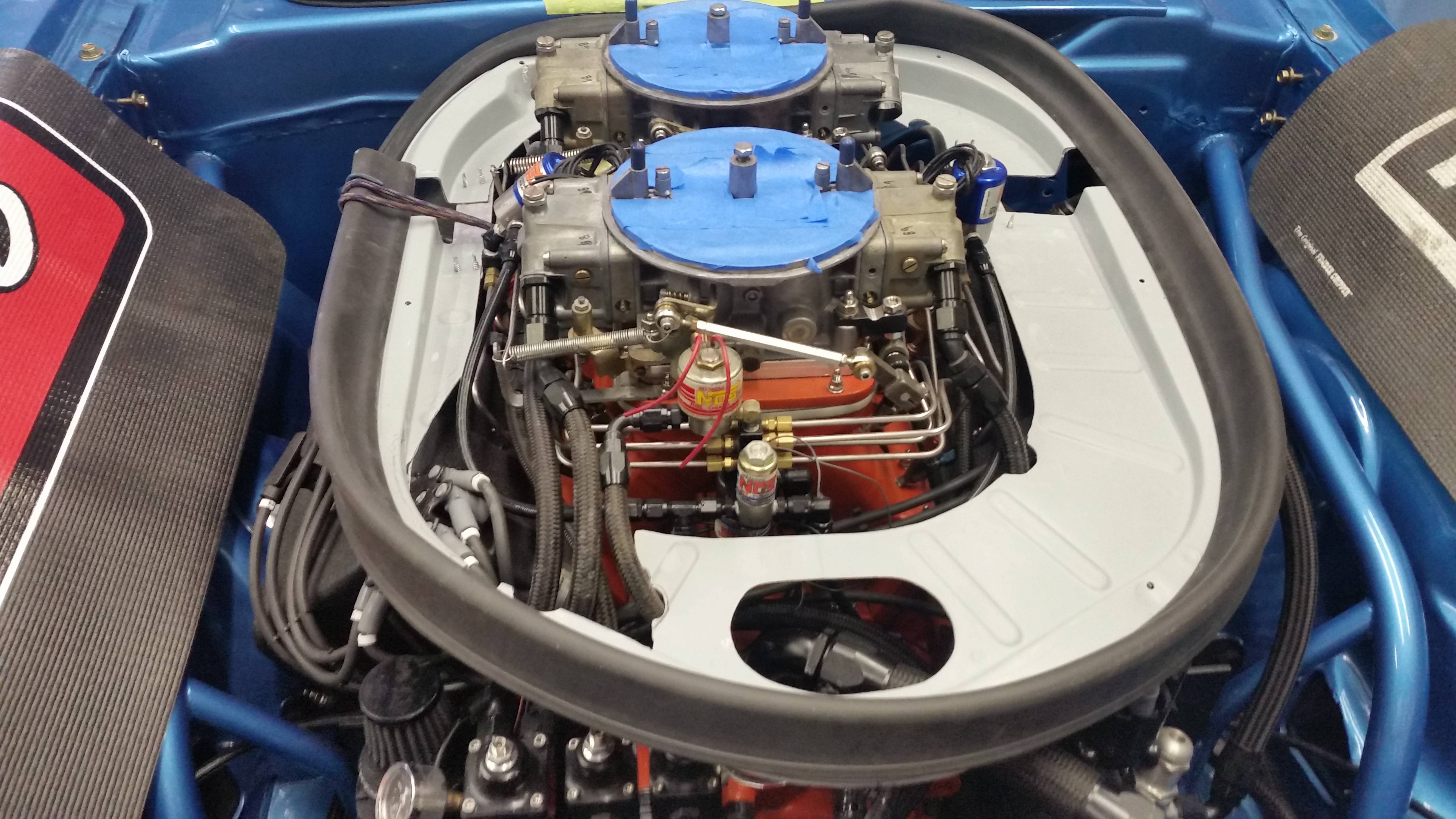

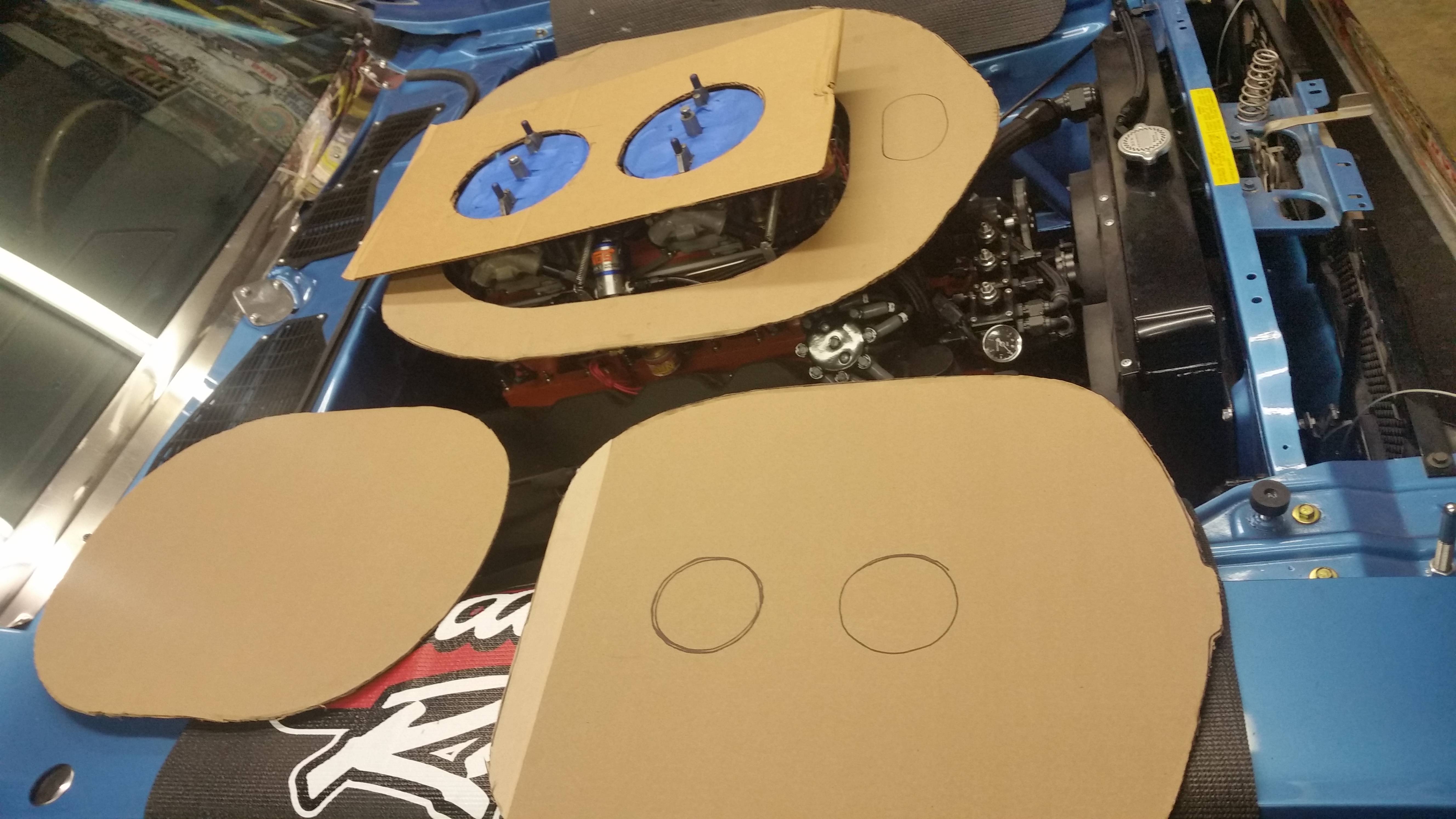

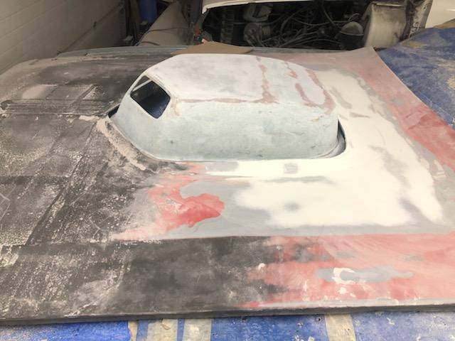

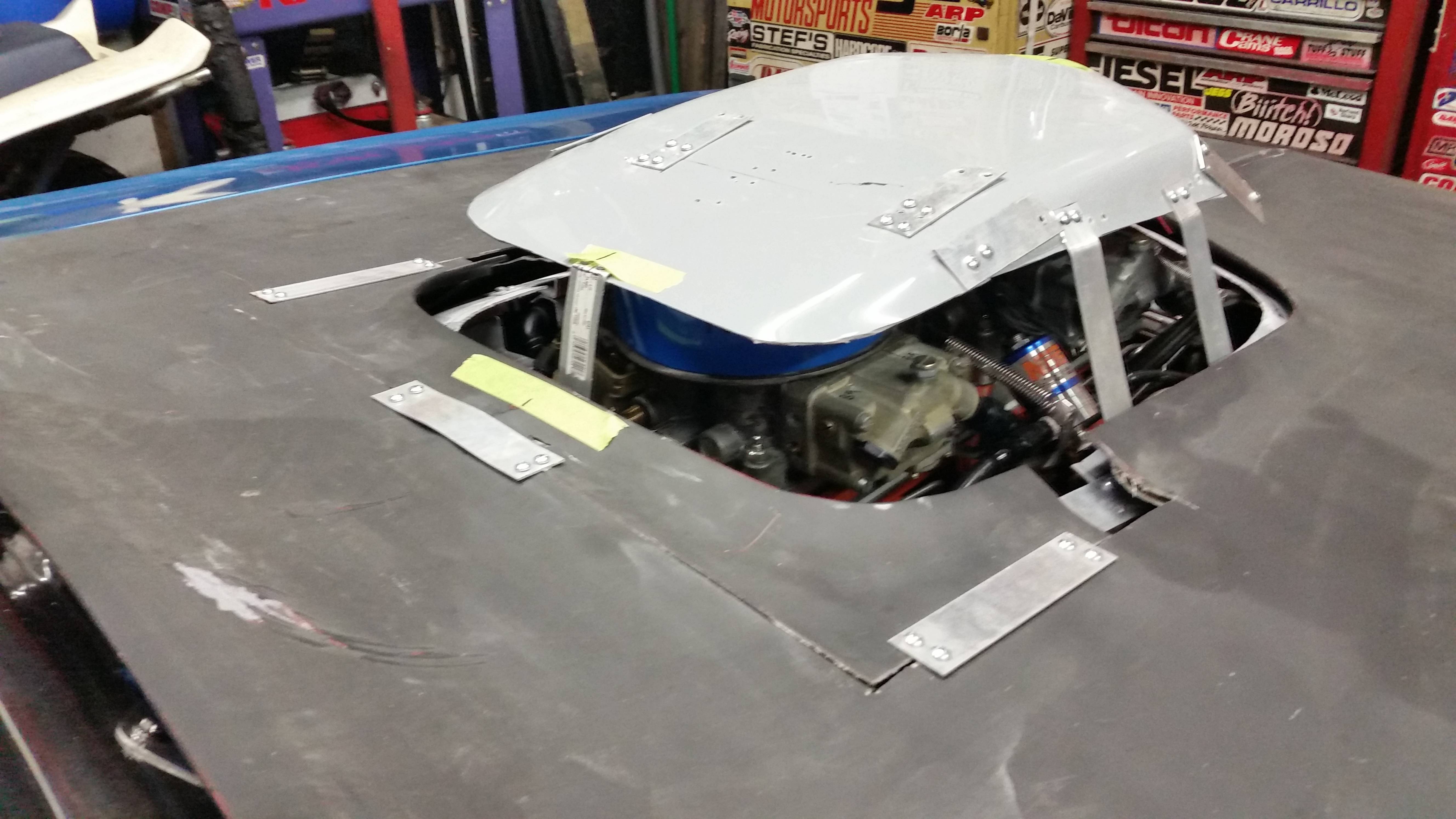

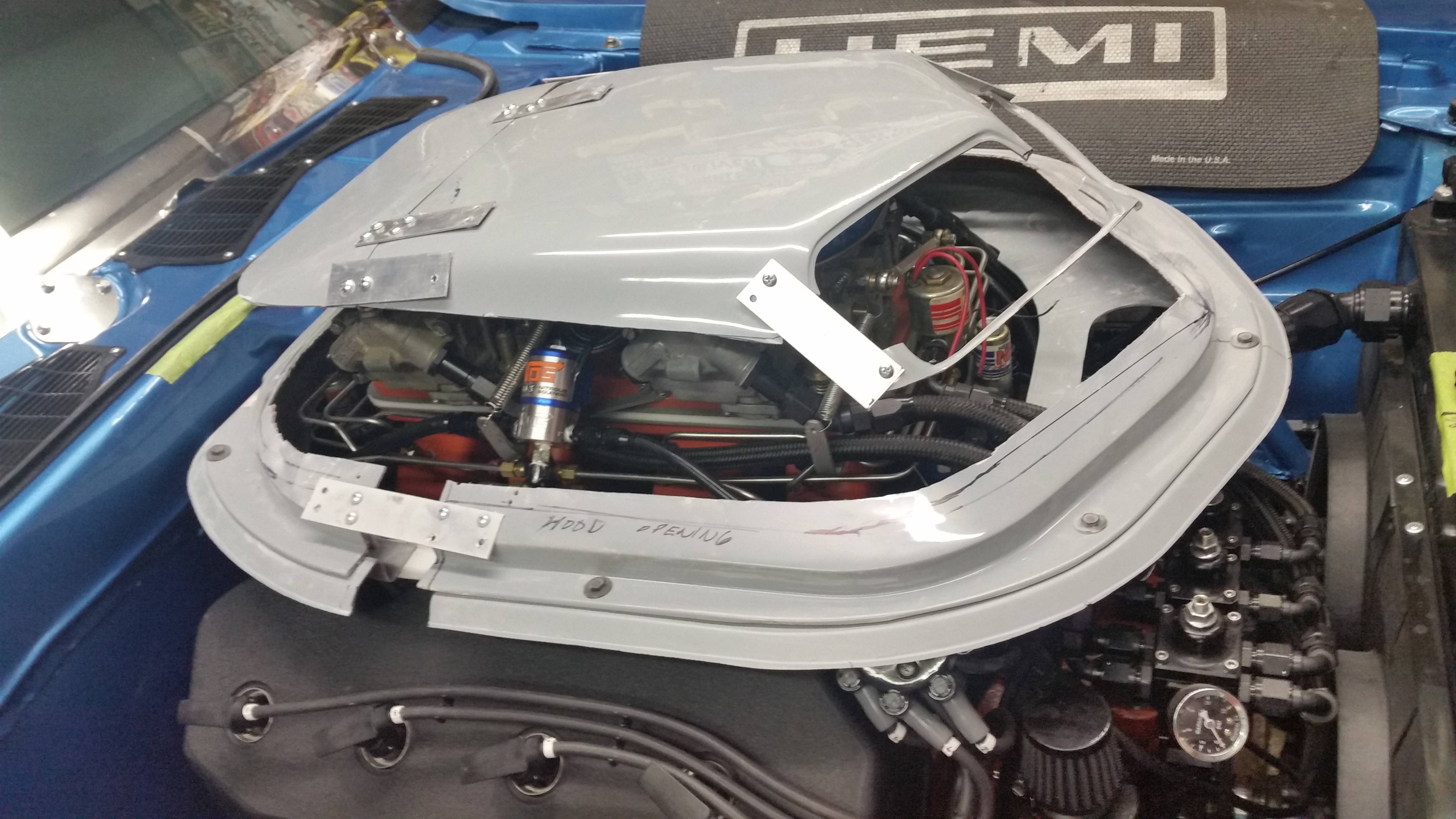

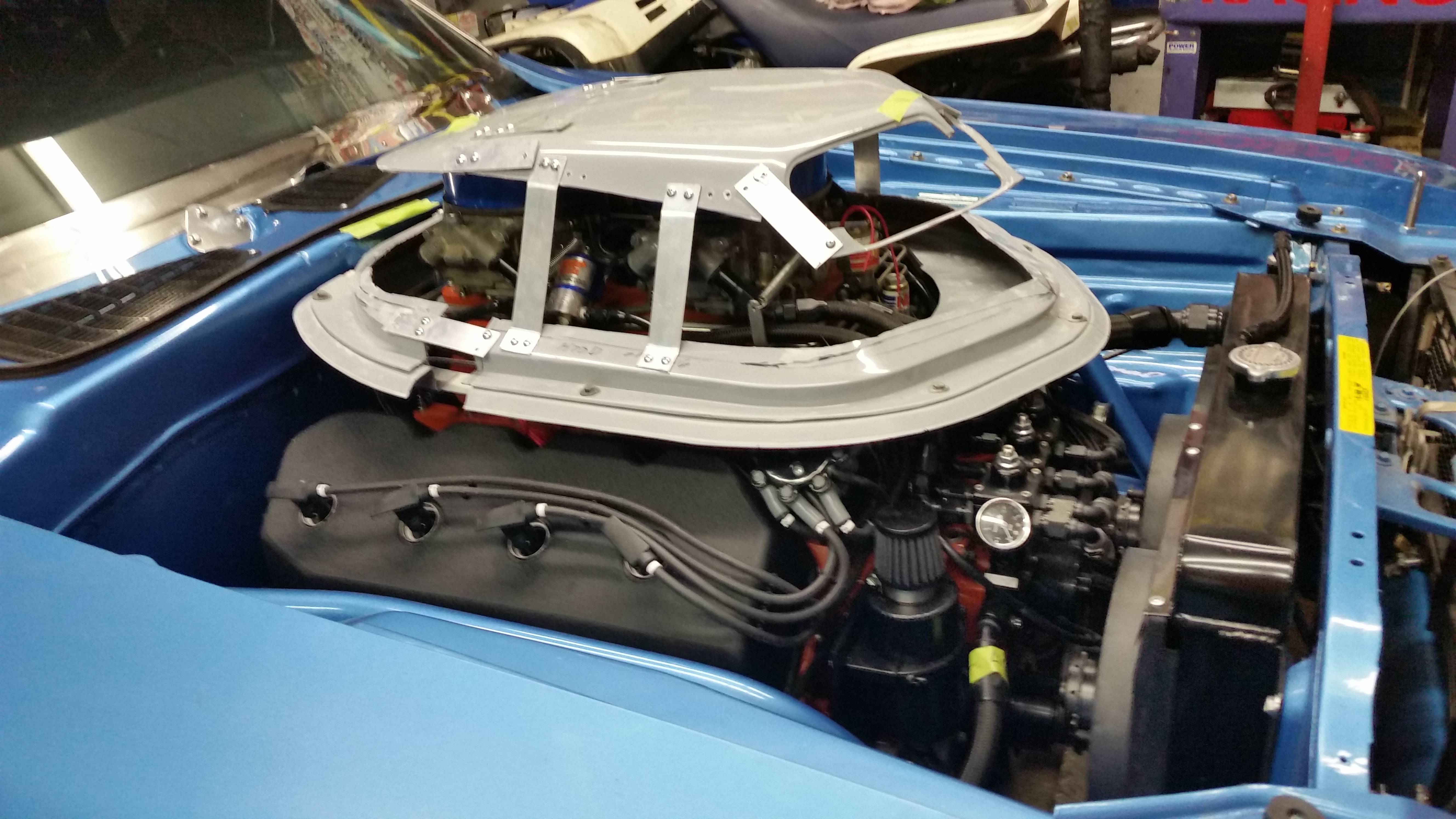

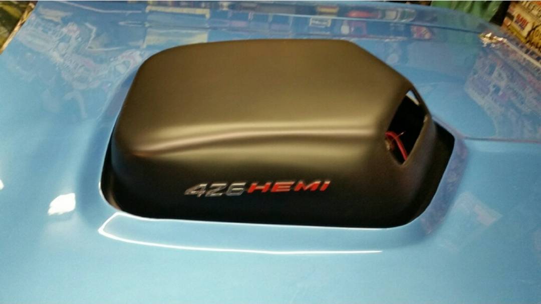

I bought reproduction pieces for my super shaker conversion. I stretched to hood opening, scoop and base 2" longer. Raised the bubble 4-1/2" and opened up the notices 2-1/2" tall to clear my two 1050 Dominator carbs and tunnel ram intake on my Hemi. I think the end result came out great and is different than everyone else cowl induction hood on every other car.

More of the progress.

In body work stage.

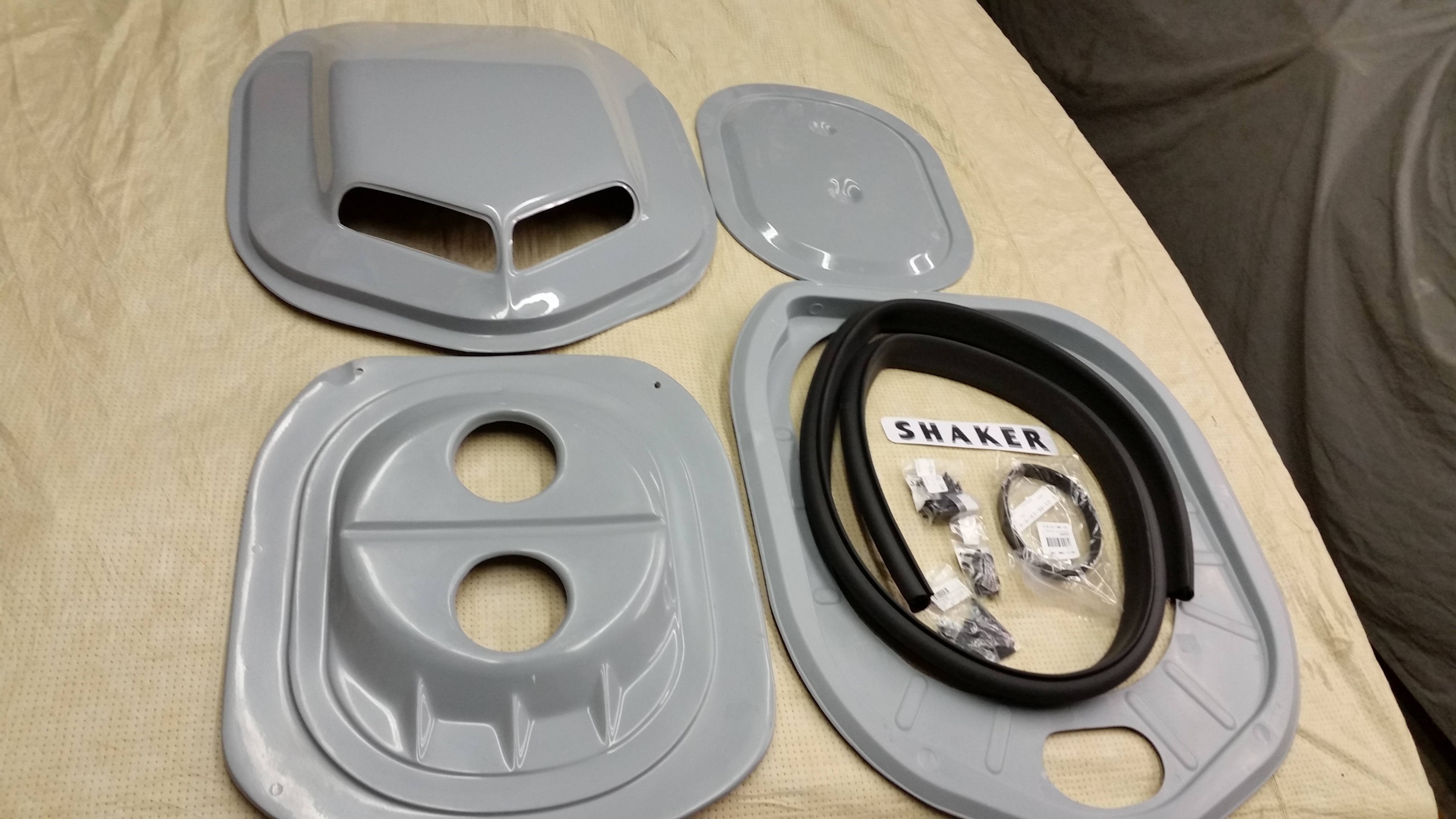

I'm wanting to put a shaker hood on my 70 Challenger. Has anyone got some information on complete kits and where to buy quality parts?
Really in the dark on this set up, seems like a lot of parts.
I did the swap last year. Went from the RT hood to shaker. I got the hood from AMD. It is NOT a bolt on fit. The trim ring did not fit at the back. I had to raise the rear reveal (I use lead) to make it fit. I have an RB running Sniper EFI, I had to modify the shaker base to lower it to fit. I bought the shaker kit from www.shakerhood.com. Very nice quality parts. Probably the best avail. Not a cheap upgrade tho! Do not buy the fiberglass junk out there. The end result is great. Looks close to factory if you ask me! I have a lot of pix if I can be of any help. Jeff
