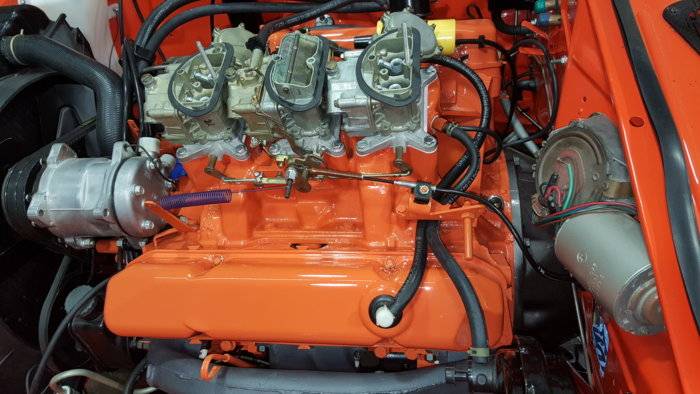

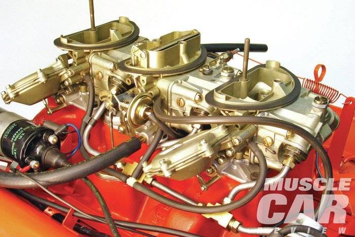

Hello I ordered a book for the six pack and I am working on getting the dealer six pack supplement info. But I want to order parts now lol. Most of what I see in pictures is the center carb t’ed to the outer carbs. What other vacuum lines are needed?
Where does the pvc go?
Should I have a single outlet breather that goes to the air cleaner.
Thanks for any input

Big hose goes to PVC valve on the valve cover. You can see the other end of the hose on the opposite side not connected to anything. Top small vacuum hose on center carb goes to vacuum advance on the distributor. Small hose in the center of the center carb goes to the vacuum port at the base of the center carb (I believe).

You also will have a hose that goes from the valve cover breather to the base of the air cleaner.

Thank you very much those are perfect. There is a threaded port above cyl 5 looks like about 1/2. Any idea what that is?

That’s what I was thinking. I have manual brakes so I can just plug it right?

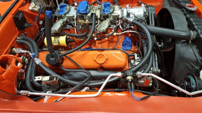

Here’s mine. I had a factory A/C car I put a six pack in. Also was a California car and had a 3 nipple valve cover breather. Power brakes and a/c vacuum lines come off the manifold.
