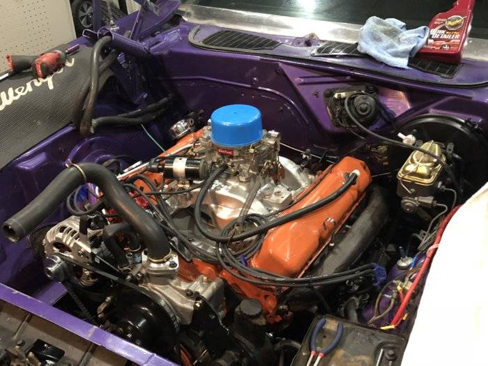

Running into a snag, used my old power steer pump on new 440 source brackets and it is about an inch from lining up to the crankshaft pulley. If anyone has experienced this let me know if you have a good fix.

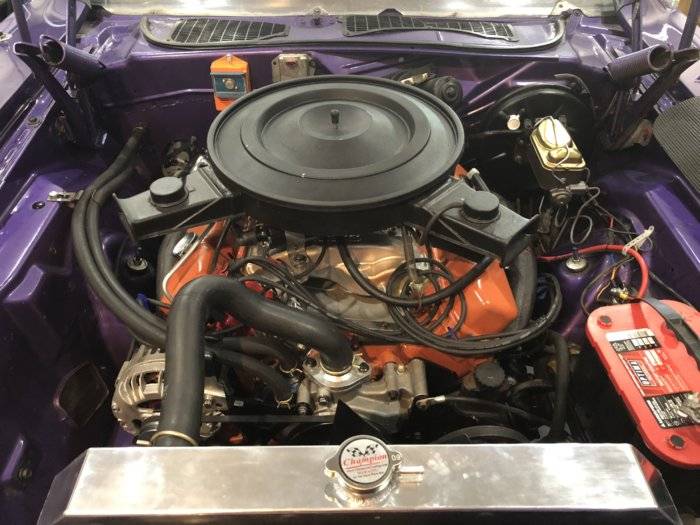

Ok, Engine is in its home, trans bolted in and everything hooked up. Will post some photos Saturday.

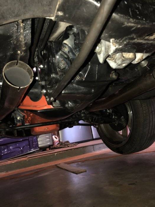

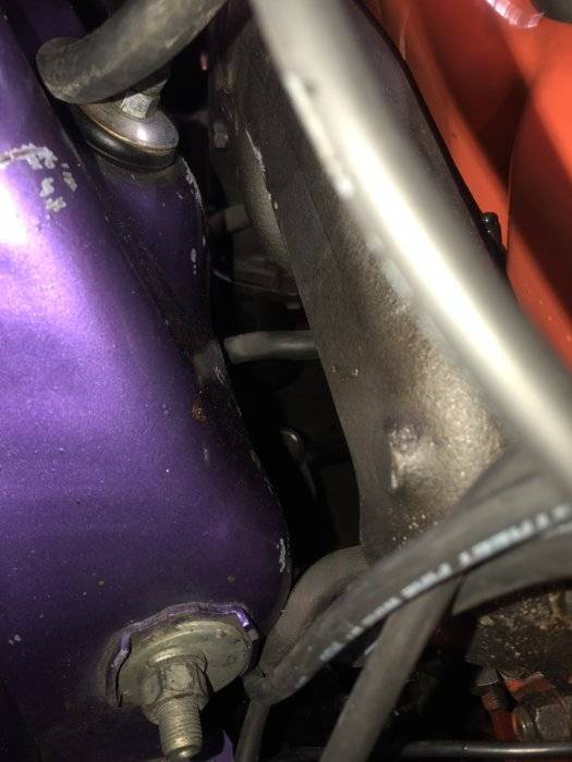

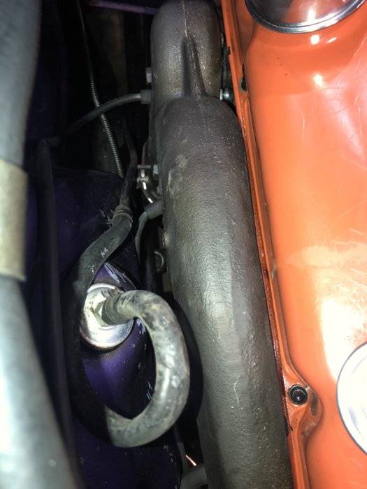

Just curious how is the clearance on the pass side to get to the spark plugs? 4 and 6 on my dart are horrible, really thinking of drilling holes to get access to them.
Update .... As soon as I get the parthound wiring harness from Tommy. I’m ready to fire it up. Need to swap the rear end and cut down the driveshaft yet!!!!! Damn Holliday travel will put me on hold a few weeks. :-(.

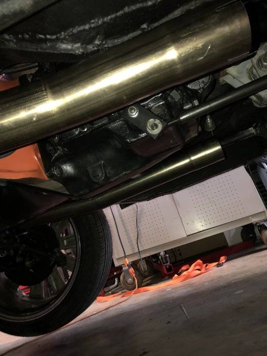

Looking real nice. Have you run your 4 speed thru the gears yet? It looks like the reverse rod bracket is up side down. How did you come out on your power steering belt alignment?
Thanks Lee. I will flip it. It looked weird but did not shift yet. (Can’t find my Hurst shifter ). I shimmed it with washers like you suggested. I wanted to keep the slant six pump because it has less assist tha the V8 pumps according to Adam

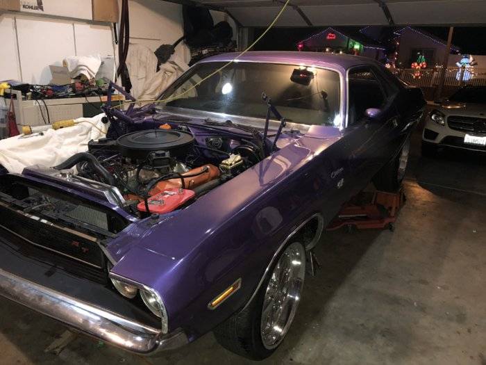

Ok, fired her up today after installing my new harness from Tommy @ partshound.net. He makes AMAZING wire harness exact to the OEM. Now have to get the driveshaft cut down.

You'll probably need to get the 440source pump pulley and possibly crank pulley. I just did a conversion with their parts and everything lined up perfectly.
