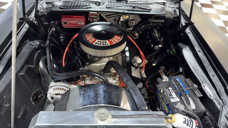

Are you running headers or manifolds? If the headers wrap close to the starter, they will overheat the starter. Also make sure the starter gear is retracting fully and not spinning once the engine starts.

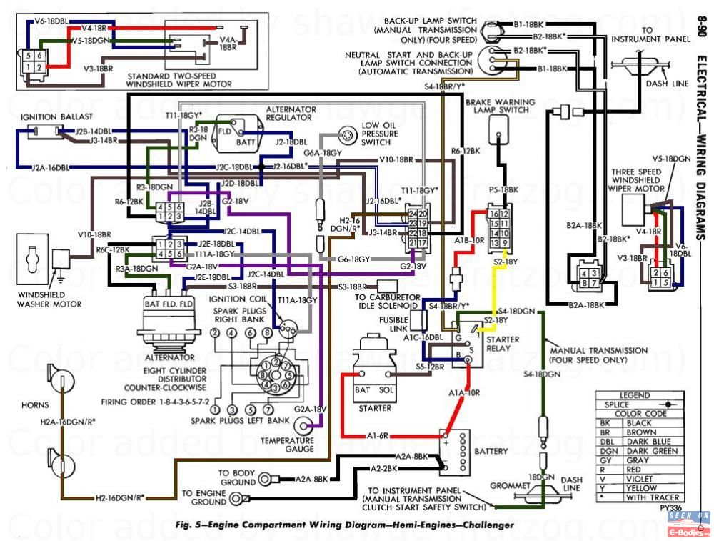

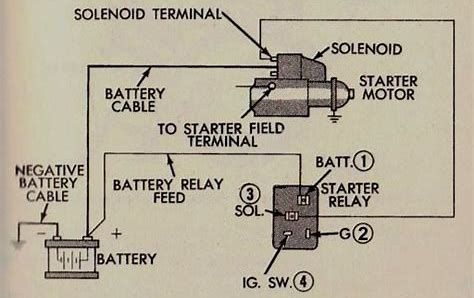

Stock wiring, manual or auto? If it happens again. Make sure out of gear or in park. At the starter relay. Jump power from red Batt power to yellow ign terminal. You don't need the key on. Just see if it turns over. If noting happens. Remove ground wire and use a jumper to good ground. Then try again.
Automatic w/headers
Both suggestions were great. Think I’ll try either heat wrap or a heat shield on the headers and the wiring suggestion is spot on for diagnosing should it happen again - this forums people remain awesome
