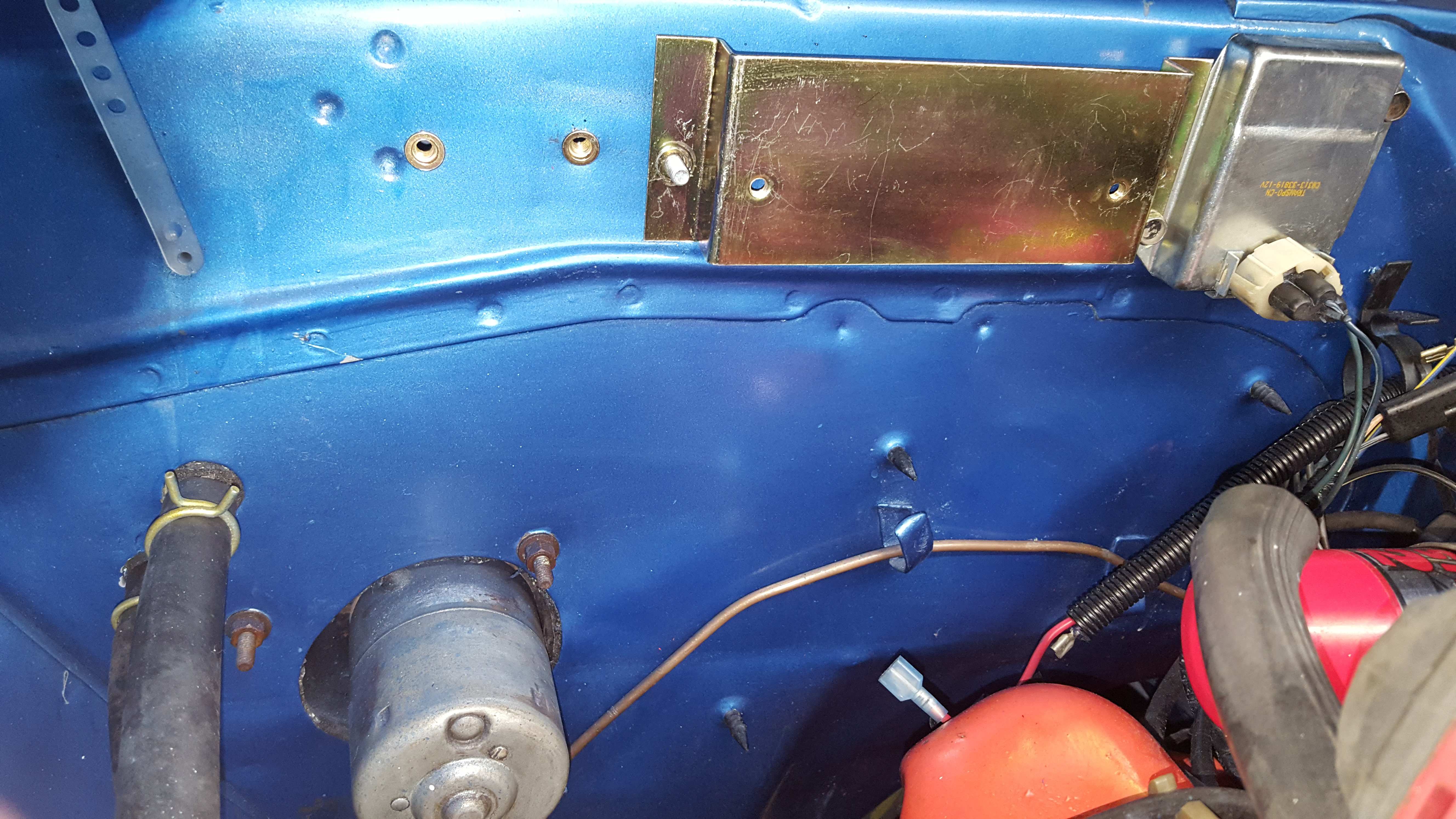

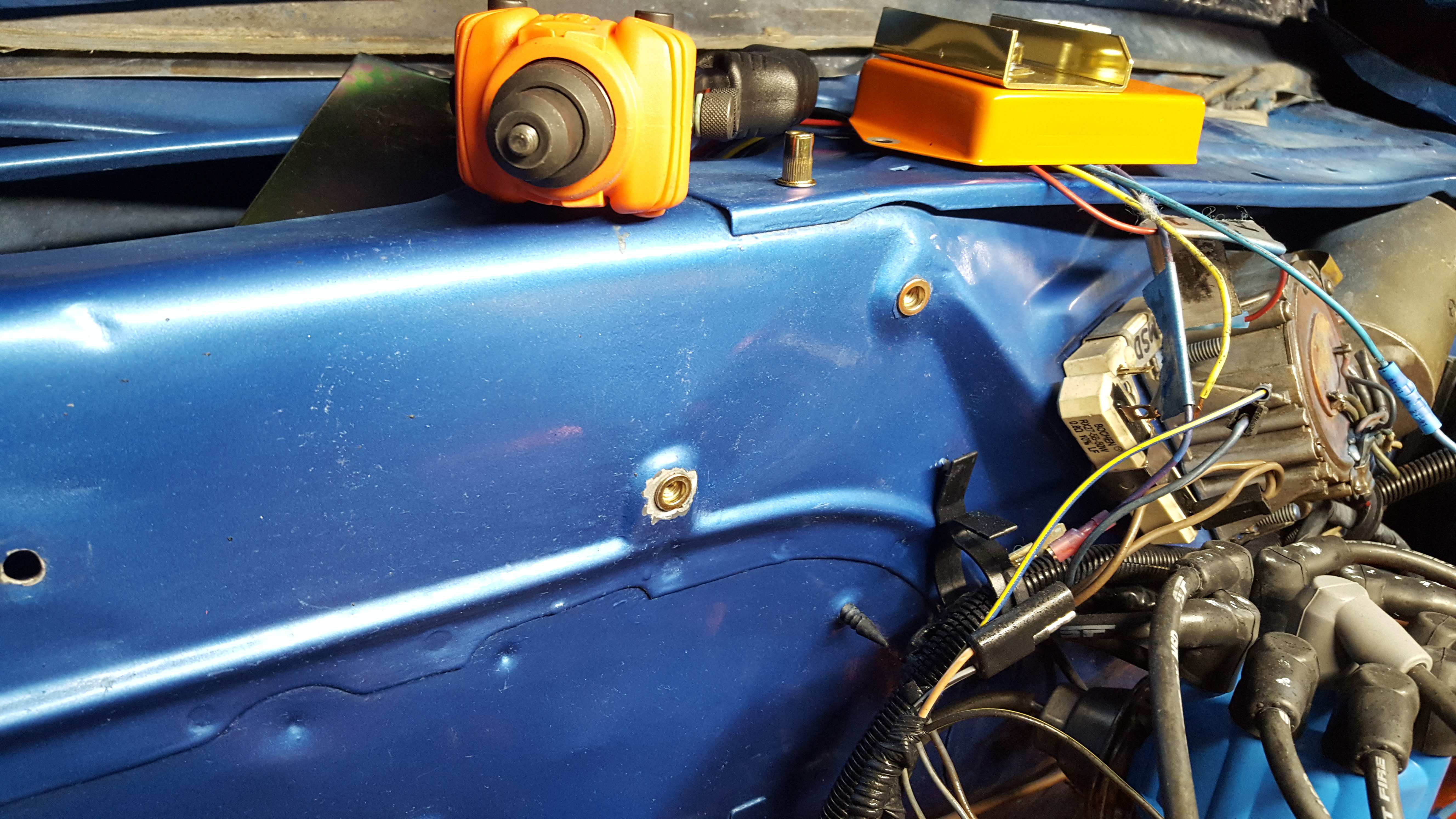

I also did the starter relay. I can be problematic. A smaller nut, bolt and washers can also tighten the hole up.
