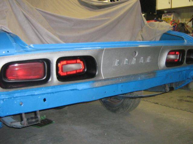

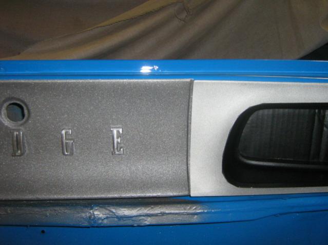

Hi i did my back 73 challenger whit paint i got from AJS resto the gray is daker the the eastwood and look pretty close to the original color .It hard to see ib n the pic but it close The pic of the two gray is one eastwood and the other from AJS .He sells them for about 26.00$ a can plus shipping .If you whant his email let me no.

That darker color really looks great. The light stuff just doesn't look right on the back of these cars.
One thing I will tell you though...if you are going for a stock look. The argent wrapped up into the trunk lip about an inch. It wasn't masked off where you did it. It needs to extend about another inch tward the trunk opening. I thought I had a picture of my car but I couldn't find it.
