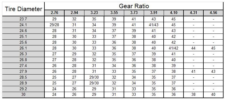

Jul 29, 2025 #1 B5blueGC Well-Known Member Joined Nov 15, 2024 Messages 130 Reaction score 48 Location MD Is there a calculator to determine the proper tire size? I have a 904 transmission with a 32 tooth speedo gear. What size tire will give me the correct speedometer reading?

Jul 29, 2025 #2 Katfish Well-Known Member Joined May 14, 2022 Messages 1,022 Reaction score 713 Location Palm Bay, FL https://postimages.org/][/url]
Jul 29, 2025 #3 B5blueGC Well-Known Member Joined Nov 15, 2024 Messages 130 Reaction score 48 Location MD Katfish said: https://postimages.org/][/url] Click to expand... Thanks. I found one here. https://www.tciauto.com/speedometer-gear-calculator

Aug 3, 2025 #4 mayhem Well-Known Member Joined May 21, 2021 Messages 161 Reaction score 56 Location Pacific NW Katfish said: https://postimages.org/][/url] Click to expand... Very timely as I'm planning the drive train/rear gearing/tire size for my current project. Thanks for posting.
