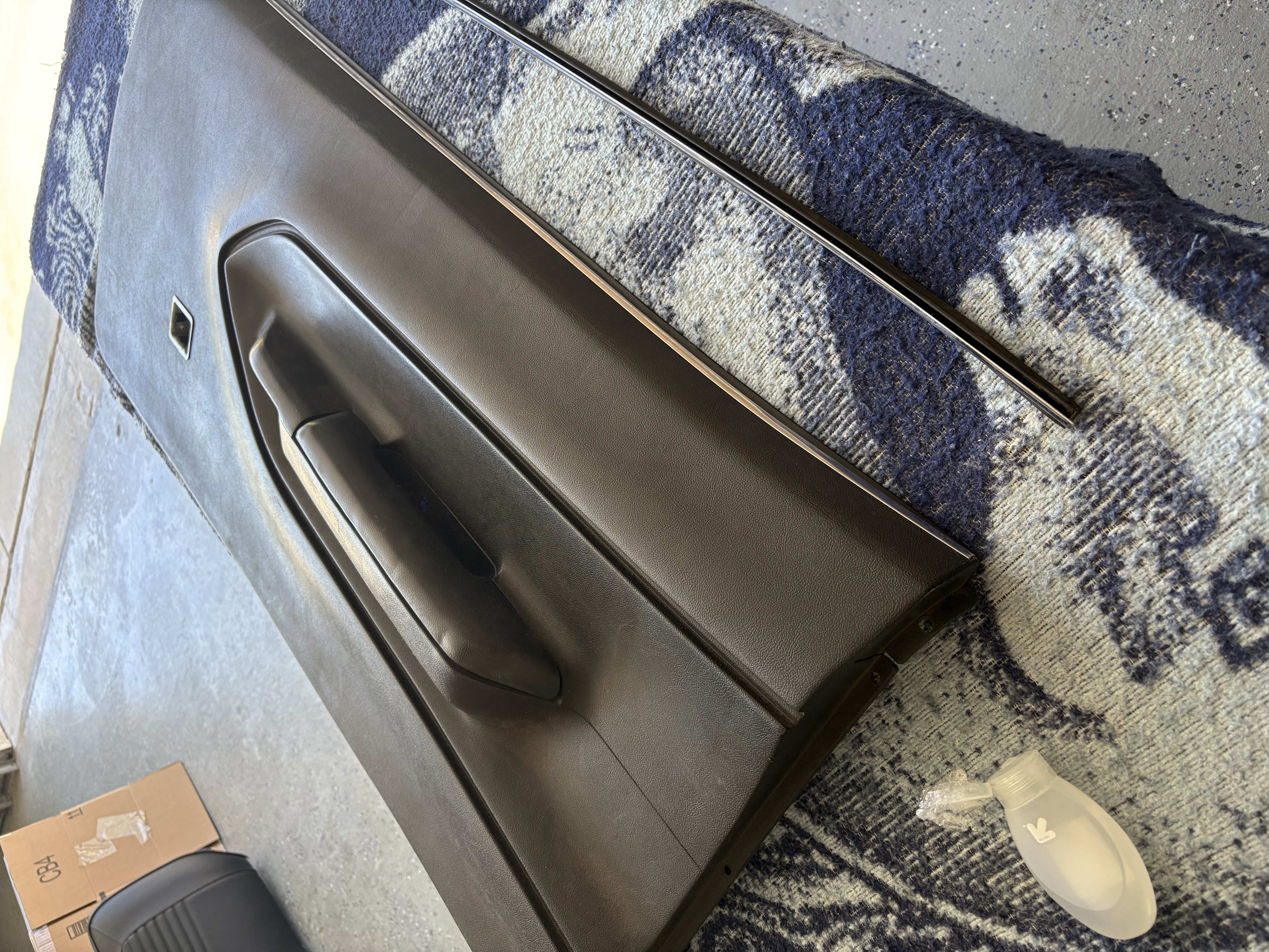

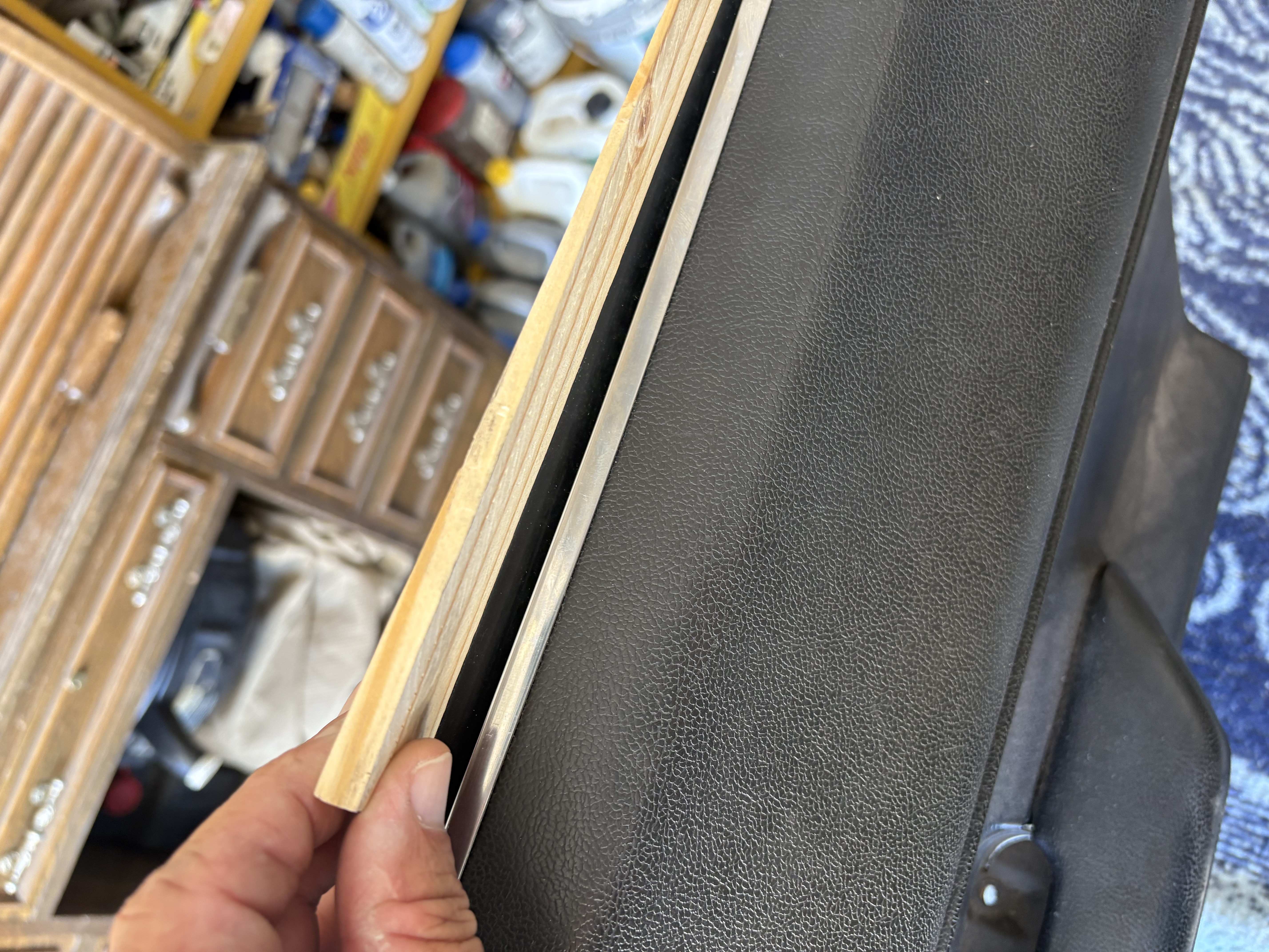

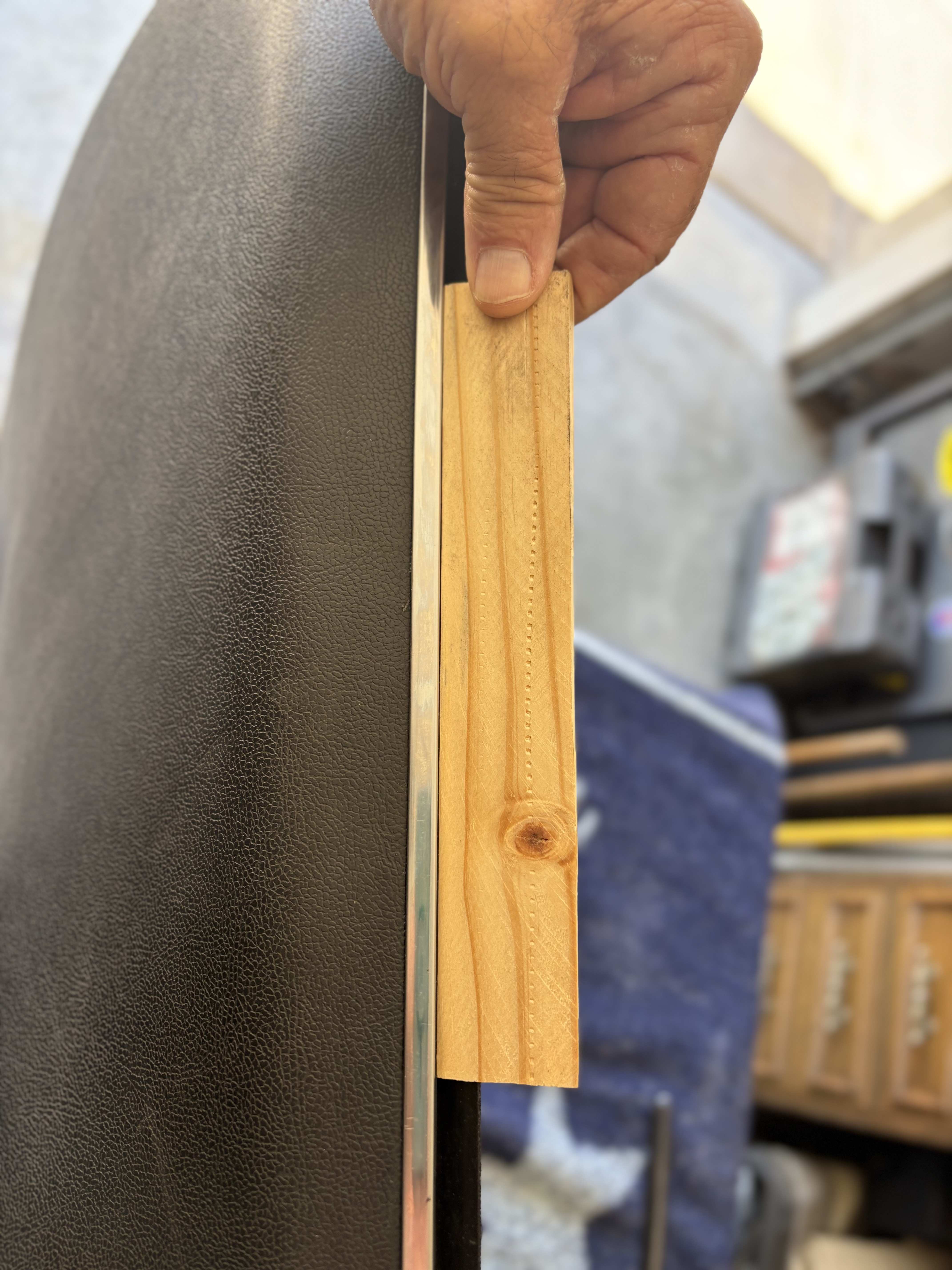

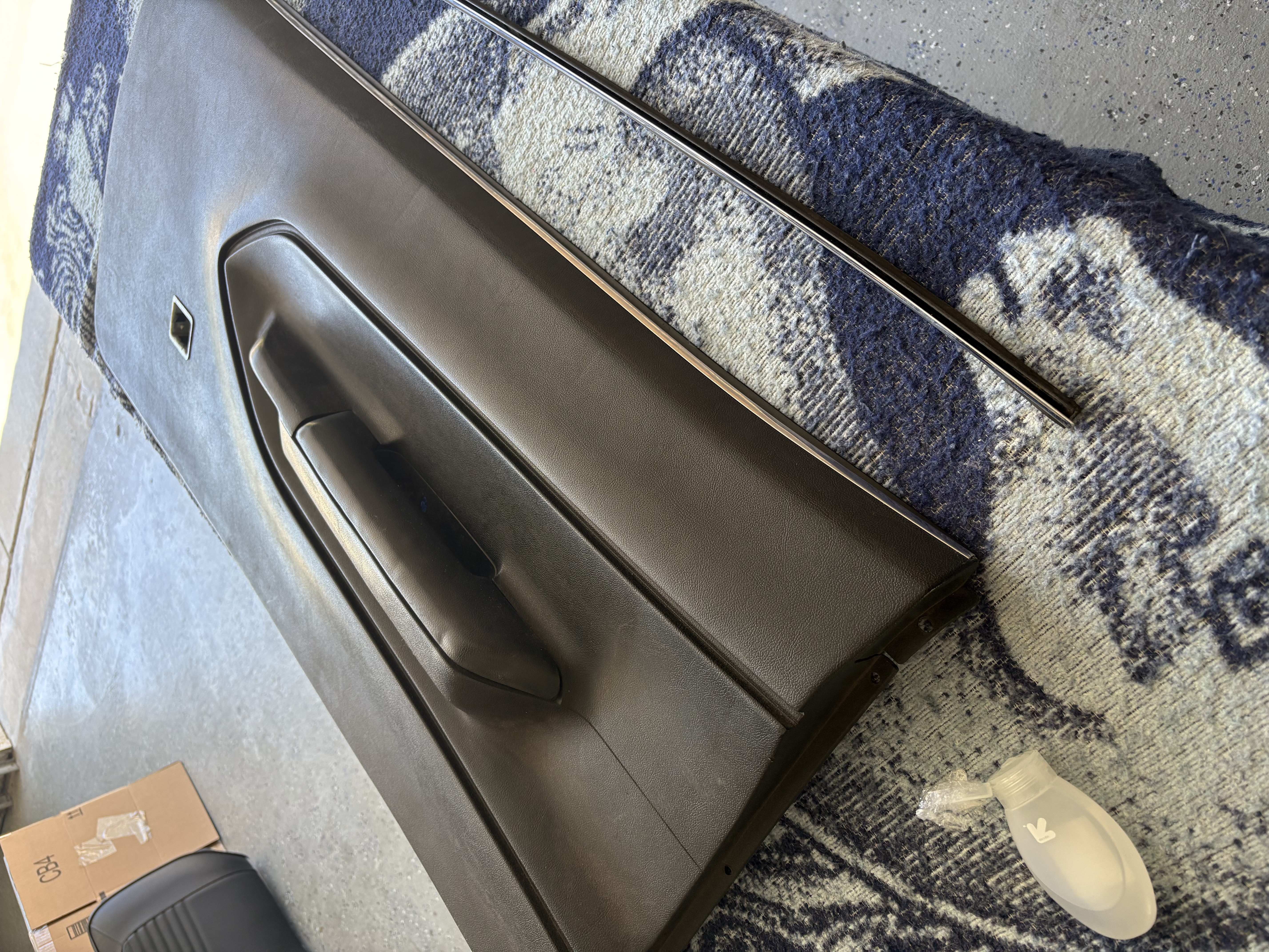

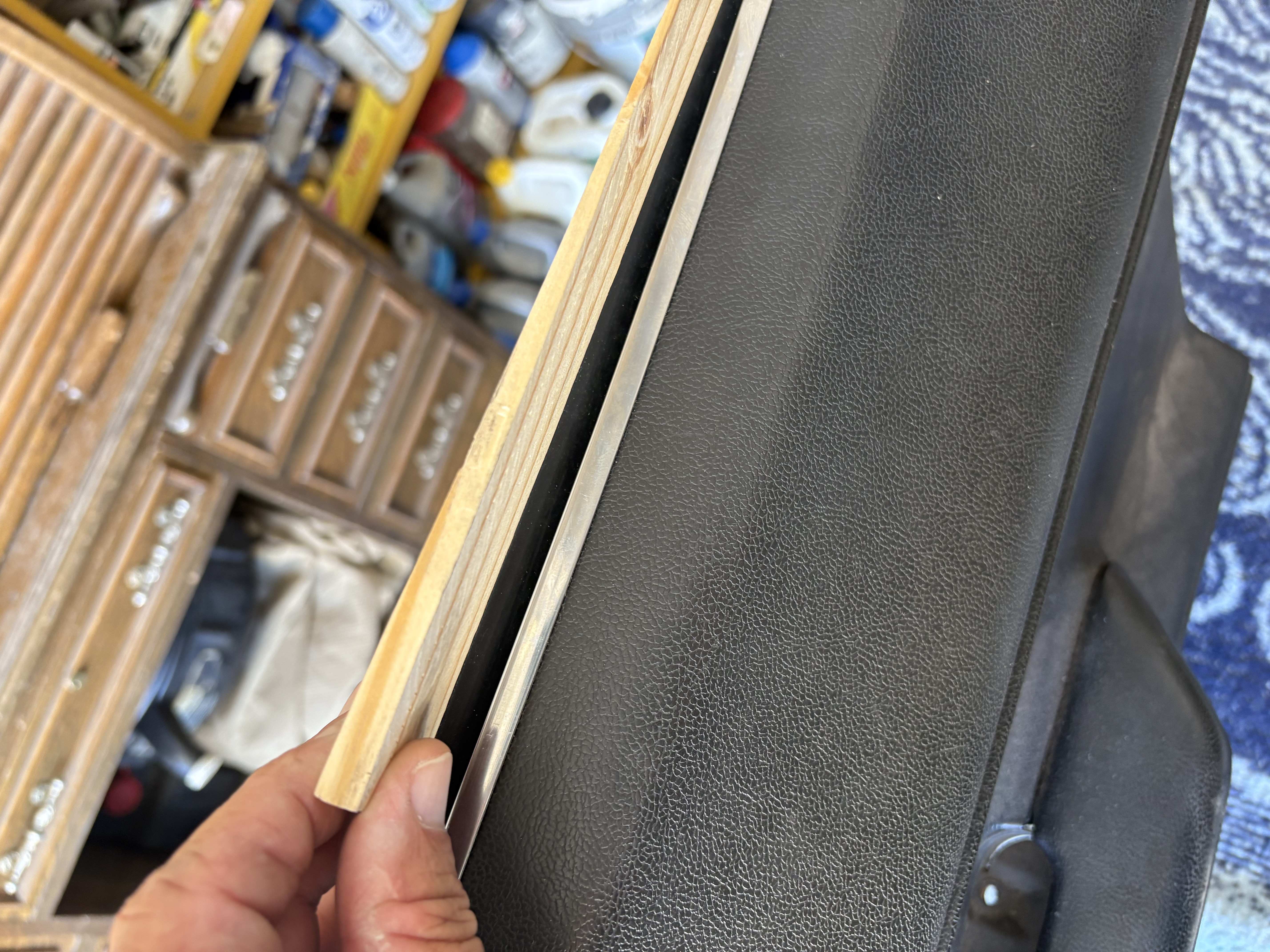

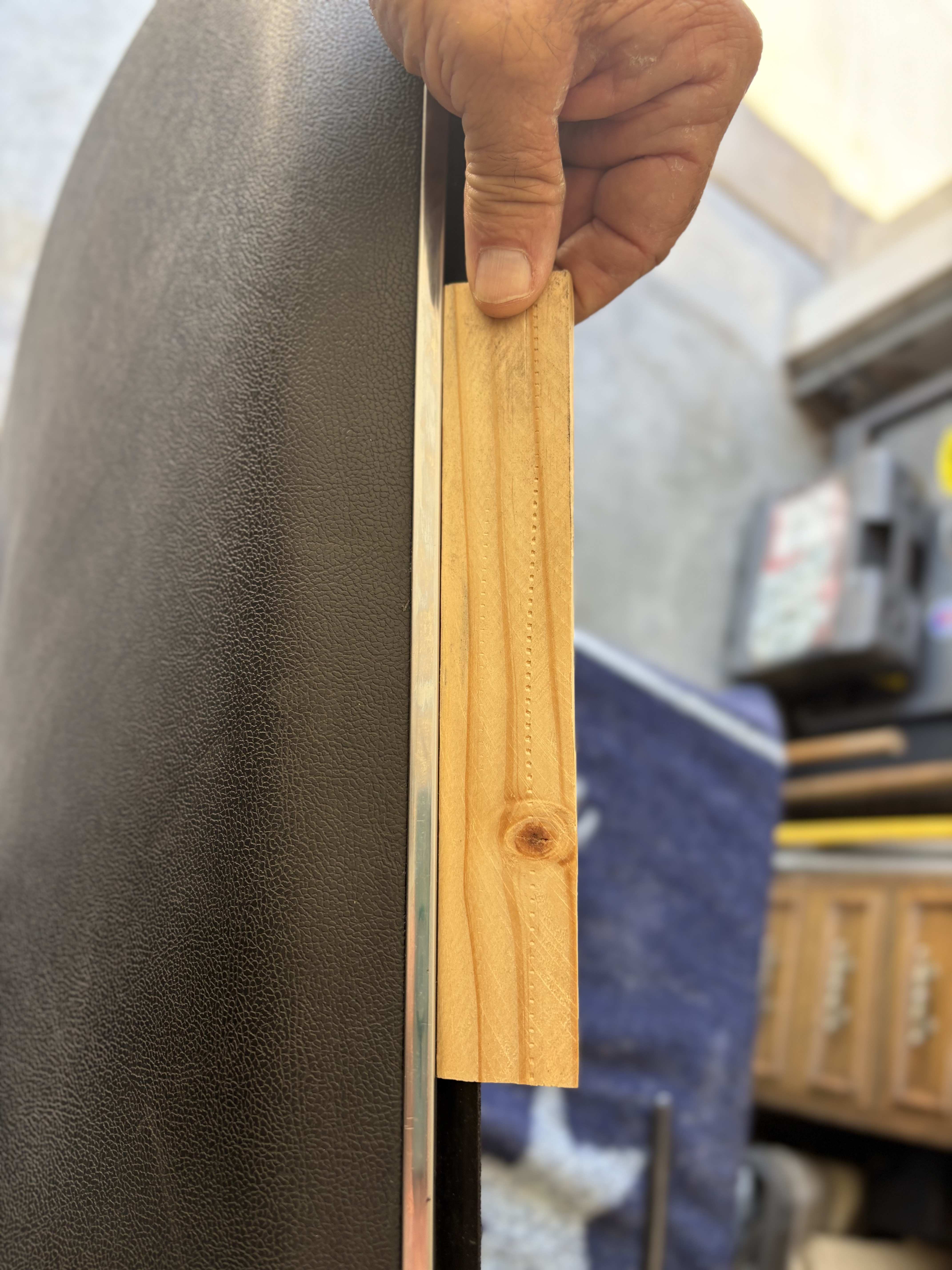

Yes! Yes! Yes! Thank you all for input & ideas on mounting the door panel whiskers. Excudame, the KY helped tremendously. So here are a few photos to paint the install picture. I used the lubricant and a wooden wedge to pop them in with a rubber mallet. Also I started at the curve because there is a stop lip on the door panel on this end for placement. They went on so easily it was enjoyable! No head banging and saying WTF! The Top Catwhiskers were a bit $$, but worth every penny. These are quality Whiskers and look awesome. Again TY! 🏝

It looks like the top of the back edge of your panel has split. Have you decided if you are going to repair that or install as is?
Terry W.
Hey Terrywalker, must look like it photos, but no splits or cracks in my door panels. They are pretty close to being perfect. A Few light scuffs on them.🏝
Oh I see what you were referring to in the photo. That’s a piece of rubber that came out of the Whisker channel. It does look like a crack in the photo. Thanks for the close inspection! 🏝
