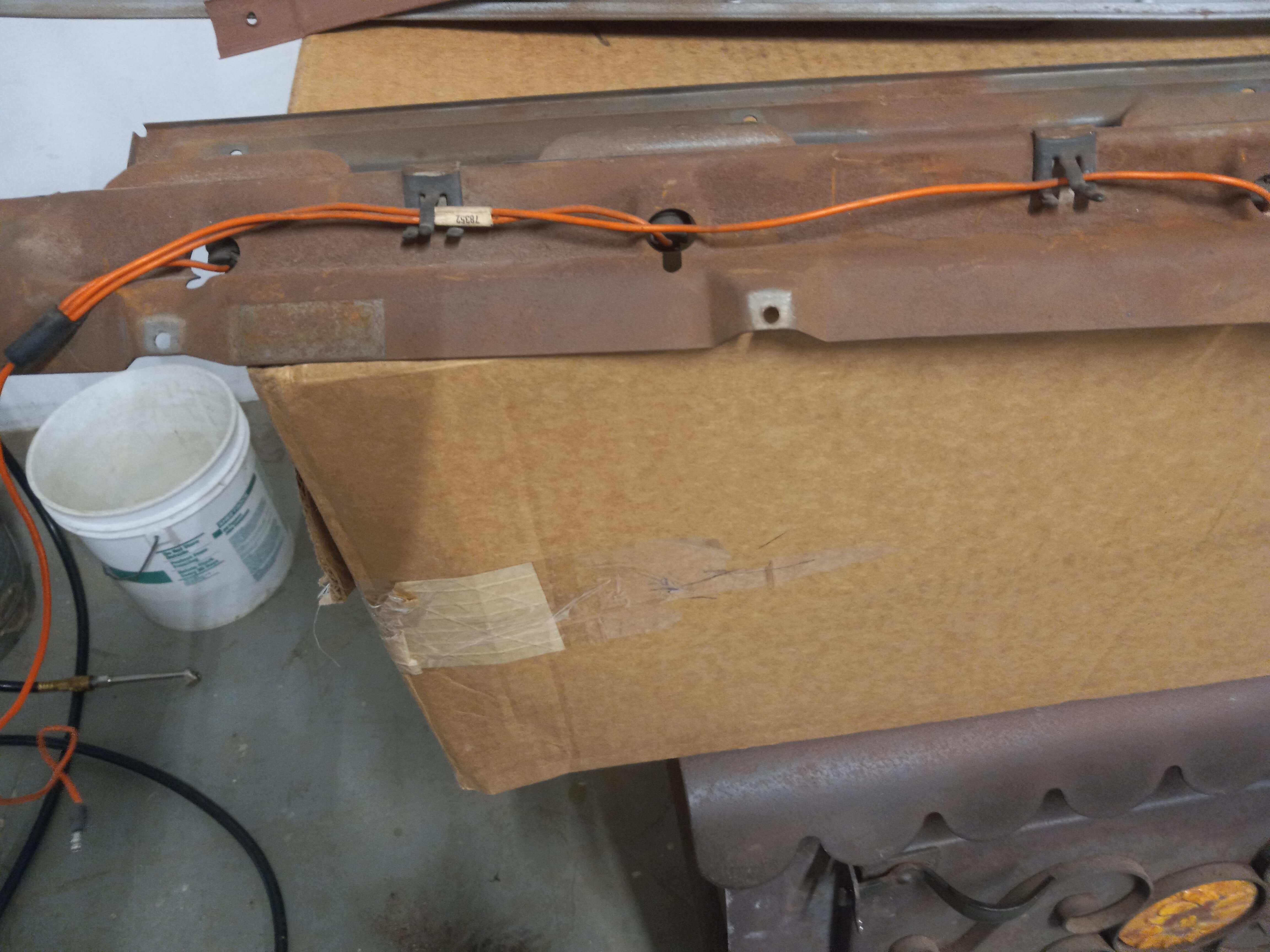

Sep 8, 2023 #1 G gran coupe john Well-Known Member Joined Aug 15, 2023 Messages 665 Reaction score 178 Location Ohio How do you take the 3 lights out, without damaging them?
Sep 8, 2023 #2 heminut Well-Known Member Joined Dec 28, 2008 Messages 873 Reaction score 723 Location Deming, New Mexico The sockets just pull straight out. You might have to push sideways a little to get them loose.
Sep 8, 2023 #3 G gran coupe john Well-Known Member Joined Aug 15, 2023 Messages 665 Reaction score 178 Location Ohio Thank you! Starting to ask, before I break.
Sep 8, 2023 #4 Xcudame Well-Known Member Joined May 27, 2023 Messages 2,207 Reaction score 1,590 Location Southeast Arizona Remember, they've probably been in there a long time! Even just a little tiny bit of corrosion makes them hard to pull out.

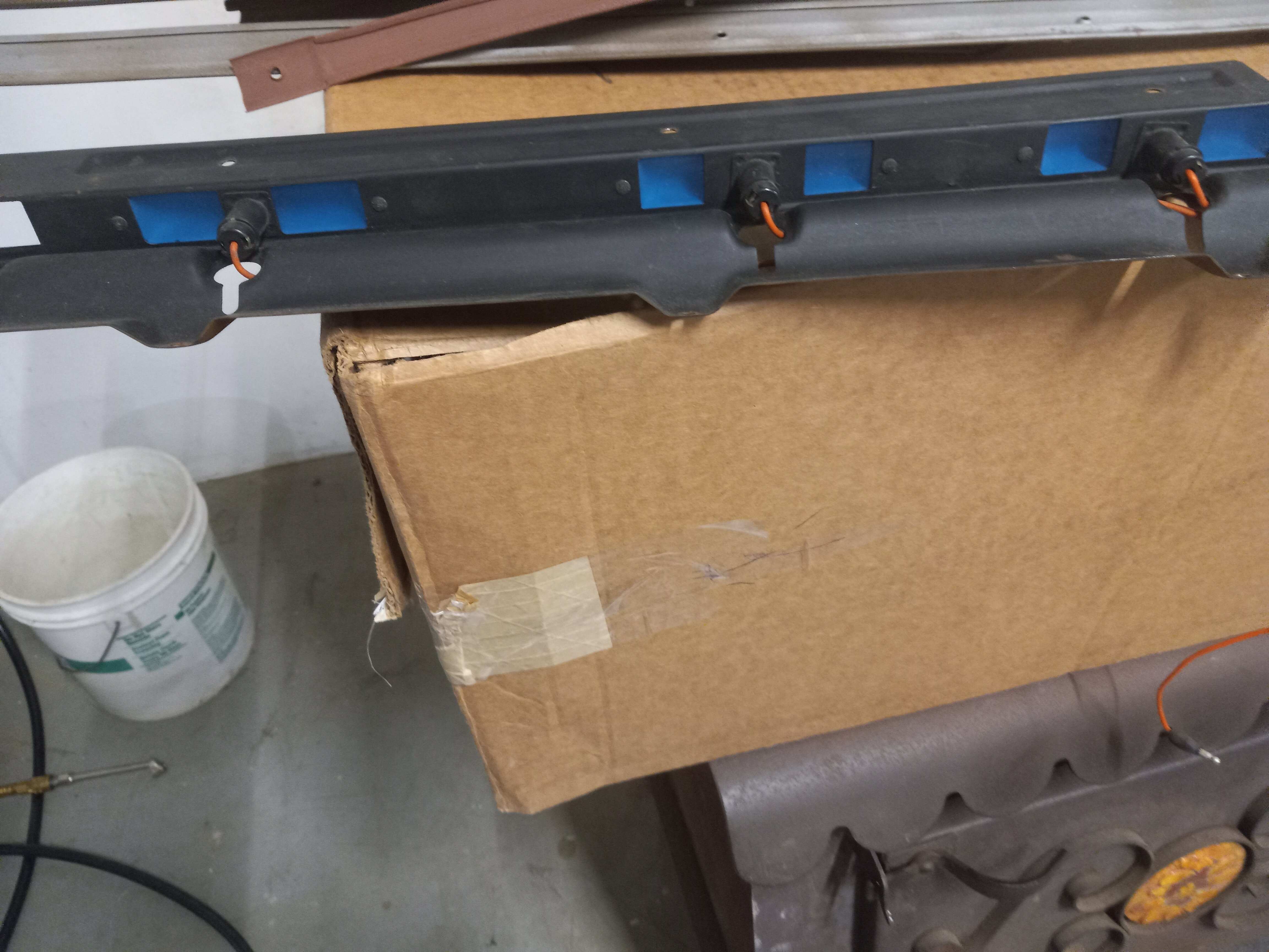

Sep 8, 2023 #5 G gran coupe john Well-Known Member Joined Aug 15, 2023 Messages 665 Reaction score 178 Location Ohio They all came out fairly easy, and cleaned up great. With a little rust paint might look good. Thanks again guys

Sep 9, 2023 #6 Challenger RTA Well-Known Member Joined Oct 28, 2018 Messages 4,285 Reaction score 2,321 Location PA Flood city Remember paint is not a good ground conductor.
Sep 9, 2023 #7 E EW1BH27 Well-Known Member Joined Dec 31, 2021 Messages 747 Reaction score 445 Location Canada Challenger RTA makes a good point. Mines painted but I scraped the paint off the top 3 contact points. One would have probably been enough.

Sep 9, 2023 #8 G gran coupe john Well-Known Member Joined Aug 15, 2023 Messages 665 Reaction score 178 Location Ohio Thanks, will get those 3 points cleaned up. I just put to rust prevention on it
