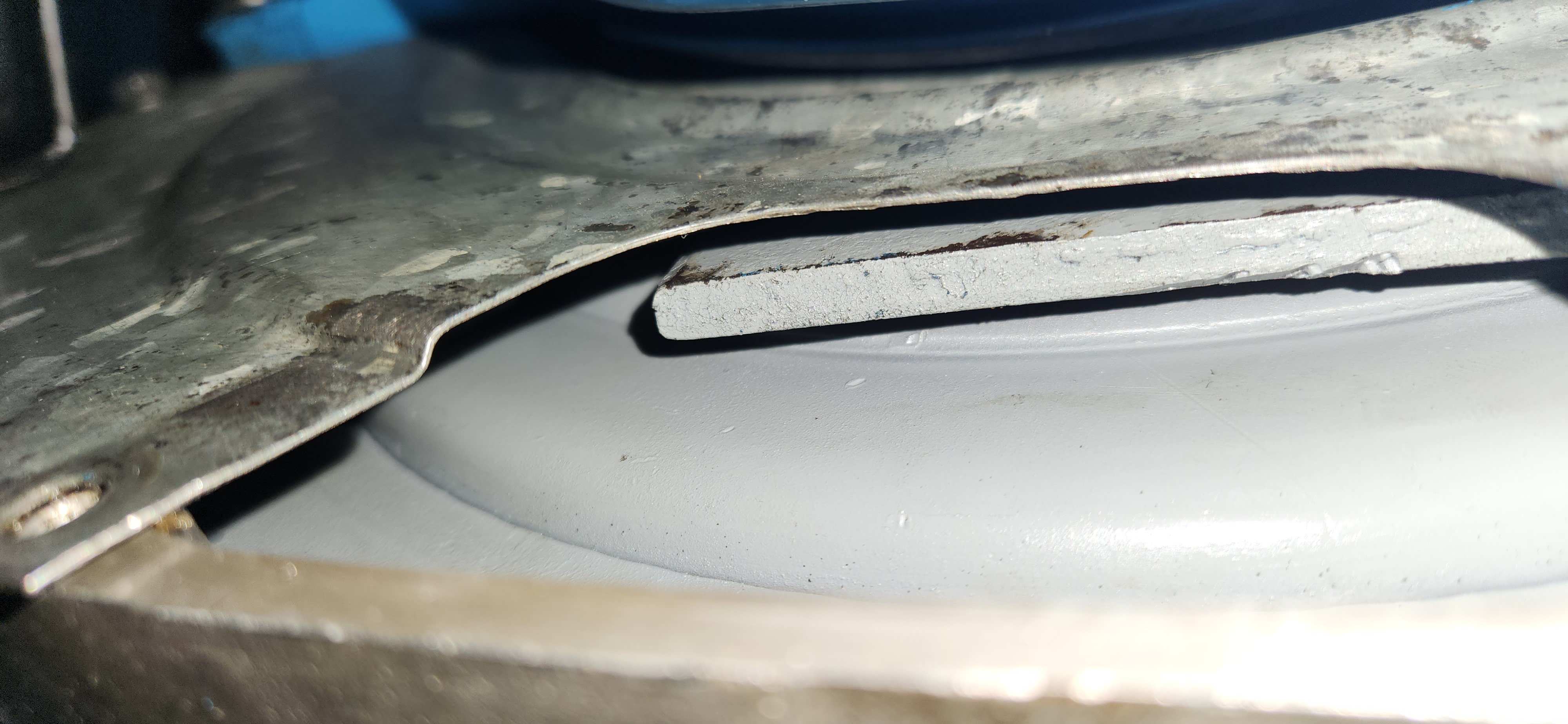

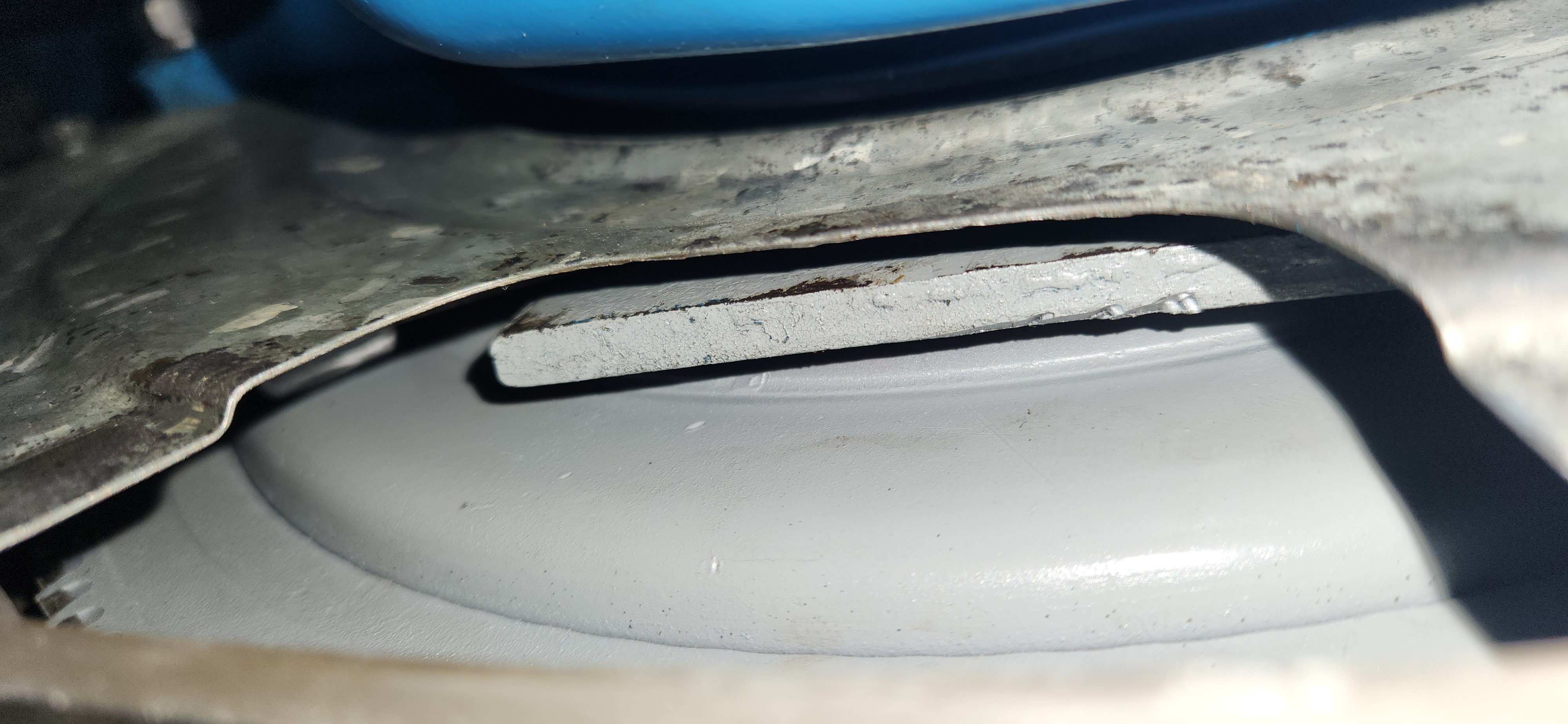

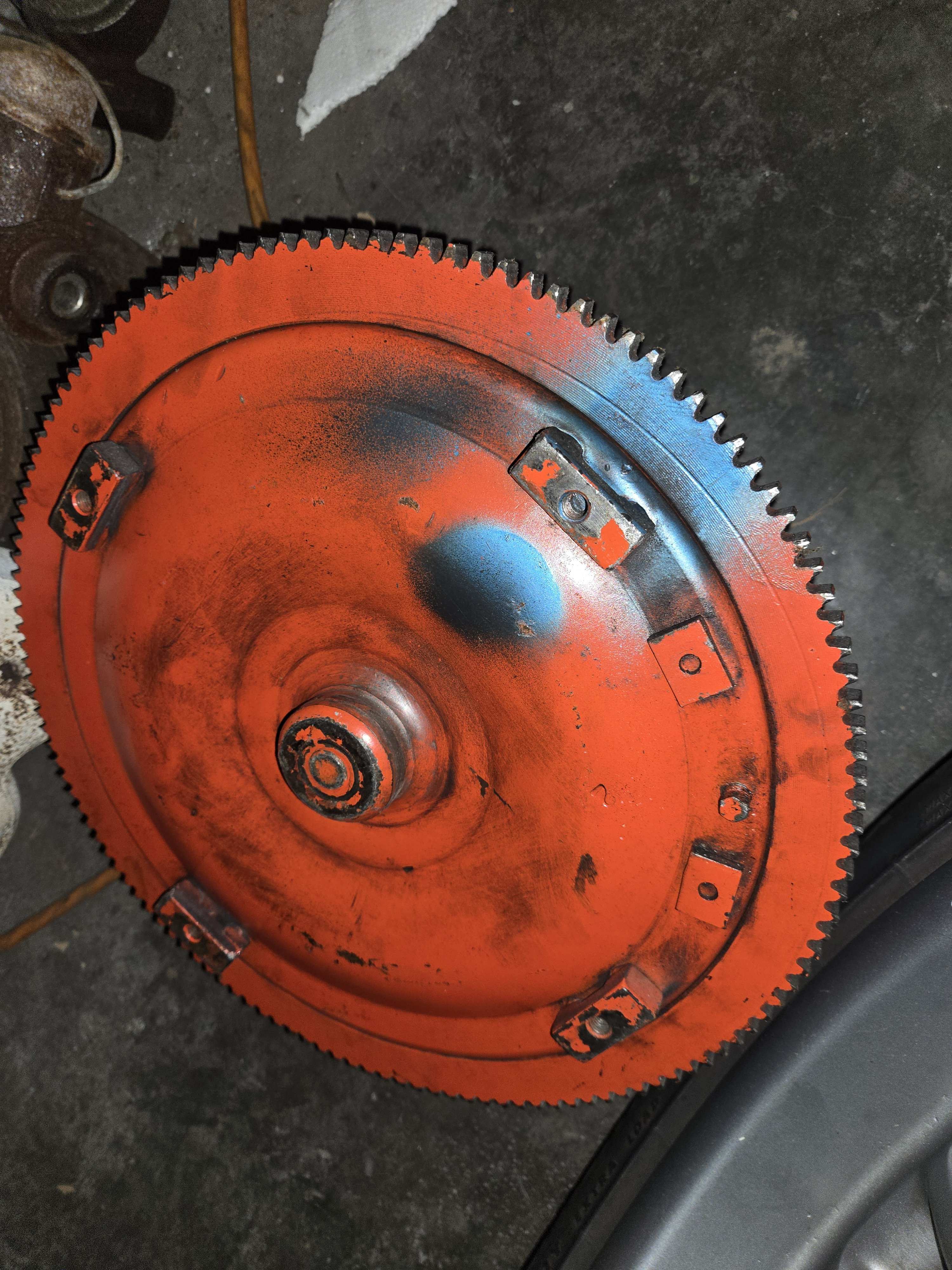

After reinstalling the rebuilt 340 and 727 combo back in my 72 Barracuda, I have a pretty terrible vibration. I thought I had it nailed when I replaced the aftermarket engine damper (that was weighted for a 360) that the engine builder installed with the factory rebuilt damper that I had sent with the engine. Unfortunately, wasn't much, if any better. I contacted the transmission rebuilder about the torque converter he supplied, and the guy that builds TC's for him retired and closed shop. So... I have a TC with no specs, no way of looking it up, installed in the car. I have a couple of pics of the balance weight. The engine builder (he only does MOPAR's) said he's never seen a counter weight that big, and has asked others, and they agree. Does the weight in the attached pics look like too big for a 340? Engine is the factory, late-72, cast crank. The transmission is a replacement and running the numbers, appears to be out of a mid 80's truck.
Mr Cuda
Jan 26, 2022
324
164
North of Seattle
That weight is way to big.
Looks like the one piece 360 weight.
(Early 360 are dual weights)
The cast 340 uses the smallest of counter weights for any mopar. For starters, twist that off and run none until you can weld the right one on.

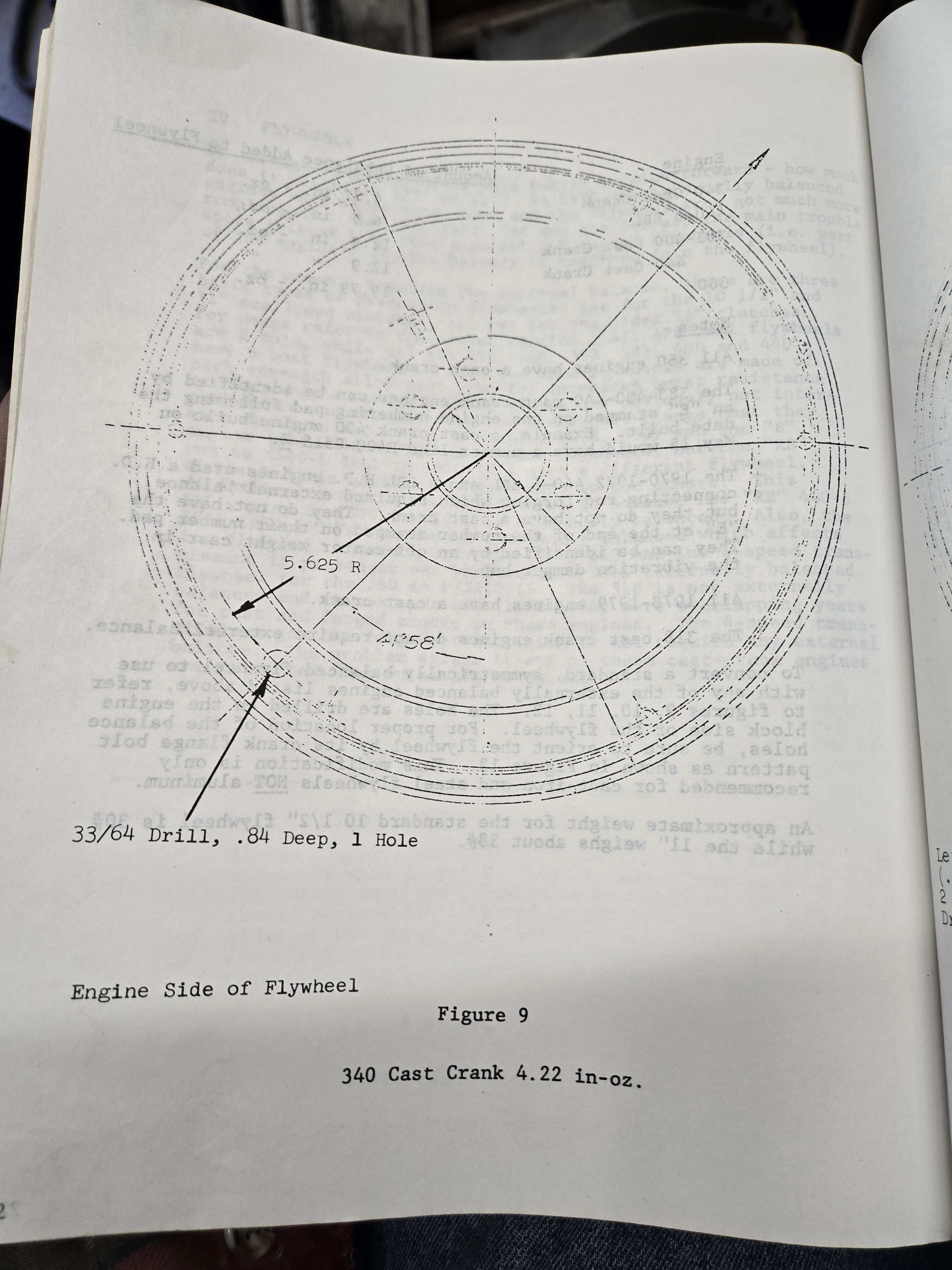

I will get the spec from the direct connection manual and update.
Maybe a picture too, as I have the one from mine. I zero'd the rear onky for a flywheel.

I had found pics of different counter weights on TCI's website, and it stated that the butterfly weight was used starting in 1977. I didn't occur to me until recently that there were no 340's in 1977, so that probably wasn't the correct weight.

The direct connection tech sheet was for modifing a flywheel for a counter weight engine. So the reference for drilling holes in the flywheel, means you have to add that weight on the opposite side for a converter.
Our old torque flite expert (Mr Pat Blais) had a pattern to position for welding weights.
I'm sure one is out there.
340 had 4.22oz of imbalance, and the 360 had 19oz.
I bet it shook.
The electro spot welds for the weight are strong for prying but not twisting.
I have put a giant cresent up in there with the splash sheild off, and just twisted them off.
I will still look for my 73 cast converter.

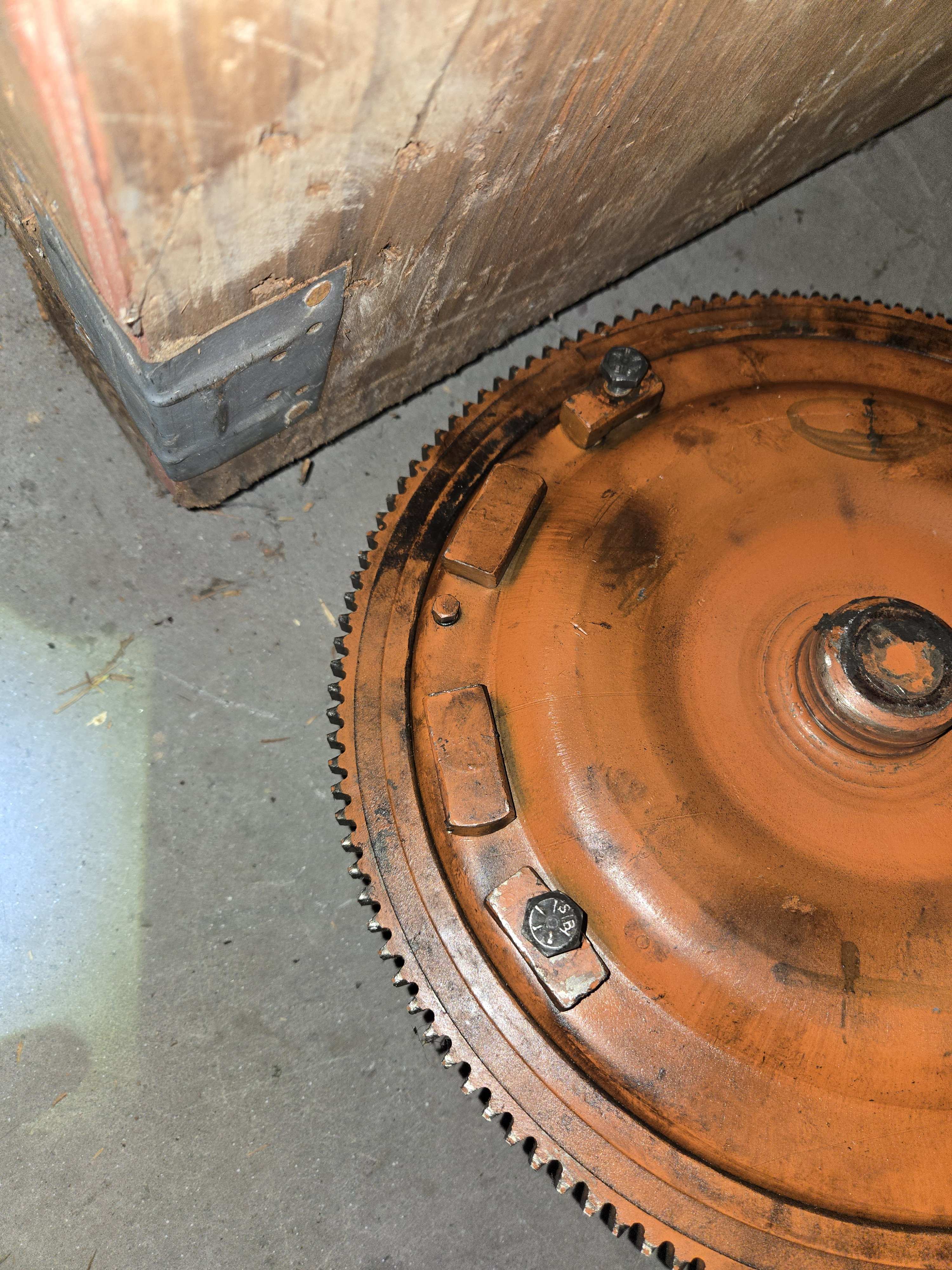

Here is my cast 340 converter with 2 small metal square by the drain, and an early 360 with the dual weights to compare.

Thanks for all of the help. After removing the splash shield to better access the counter weight, it appears that it is welded on the sides (and maybe on the top), so I don't see any other option other than dropping the transmission so I can gring off the welds to remove the weight.
Yea, I thought that was a given. I was not even aware the weights could be removed without separating the transmission from the engine and dropping it for access. Nice tip, Mr Cuda.
If your crank and rotating assembly was rebalanced during the engine rebuild without the (correct 340) torque converter, you may not need another counter weight, only to remove the (wrong) one that is there and grind down the spot welds. As I said in post in post #6, you may want to put the harmonic balancer it was balanced with back on, because this SHOULD be less guess work.
But you may want to have the rebuilder weigh in on both the counter weight and which harmonic balancer. They will know if the crank was rebalanced with or without the T/C counter weight. If they balanced with with a presumed counter weight, they can tell you what (offset) weight it was balanced for.
If it was NOT rebalanced during the rebuild, presuming the crank is still factory configuration, then use the factory counter weight mass on the T/C and the factory harmonic balancer. I detest guess work, but what can we do, without definitive recommendations by the rebuilder?
