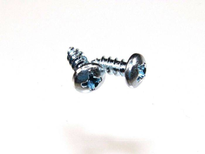

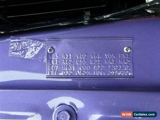

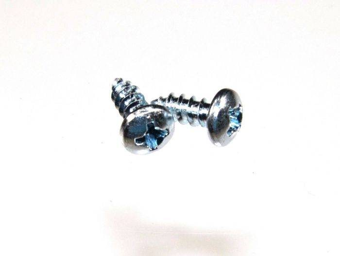

Thanks for information; these don't seem to match. Which head contour is correct?

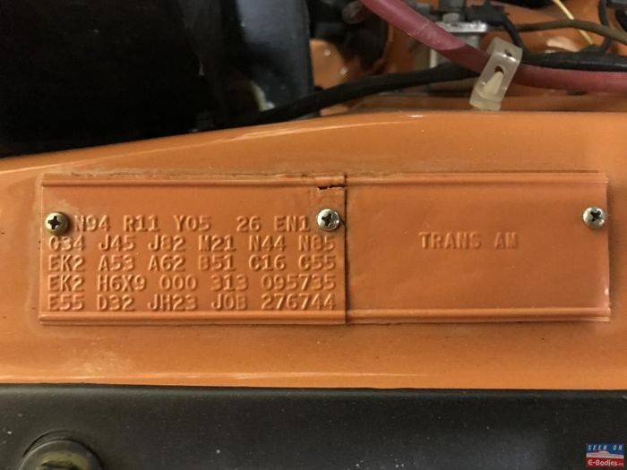

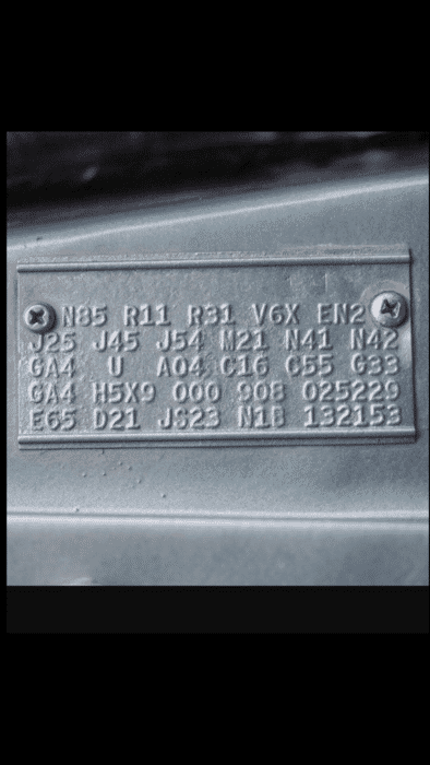

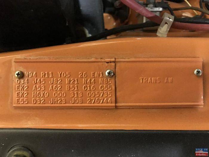

Example of the one painted/ one non painted screw.
Nothing carved in stone with Mopars.
My understanding is that sometimes the data plate screws were like this one. Some cars came with both screws painted, and some came out with neither screw painted?
4iNyZIbu4Rs8A7RQD8egMnw37np5qhubw-iW_rnePx47OHiWHs8wECi8xhS-LcznsOlHDOj_xDjiLEsvxdrF98-vF_isfIiQ.jpg
And in some cases; you can see where the original tag was bent up on the right side before being screwed back down.

So it looks like the screw heads on both those tags match the one on the right in the photo I posted?

The correct screws are different in size.
In fact, that is the first thing I look for. It doesn't mean that the tag is the original, just that the detail was not overlooked.
You mean the two screws were different in size from the factory?
budascuda
Jun 17, 2017
1,106
572
Yes, they were different size HEADs from the factlry.
That little fact made them "rightous".

If you think about it, some cars coming down the line that would have the fender tag bent up slightly in adding a 2nd tag or ac tag, then bent back and screwed down toward the end of the build run have a different second screw size, coming from a different fasteners bin.
It seems there is no set rule with this, since it seems some cars had two different size screws and some had two of the same.
Unless you have an original tag that was never removed from an unmodified car; you really can't determine exactly what your car came with.

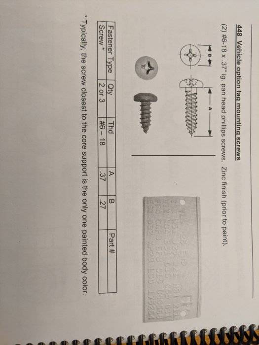

If you go by mopar lee's factory engineering screw size chart, it shows only one size.
As with Ma Mopar, never say never on anything.

So these 2 different screw heads could be original? Amazing.
budascuda
Jun 17, 2017
1,106
572
Since 1984 when I bought my first challenger as a young man, I have kept note of the screw size on the tags and 6 cars later, plus all the original condition cars that I have seen, they were all different sizes. I think the first time I came across that oddity was in 1984/85 and quite by chance I saw an editorial in the Mopar Muscle magazine regarding this.
But as 340 says, other more important thing should be considered, the screw size is just an amusing factoid, That's all.
