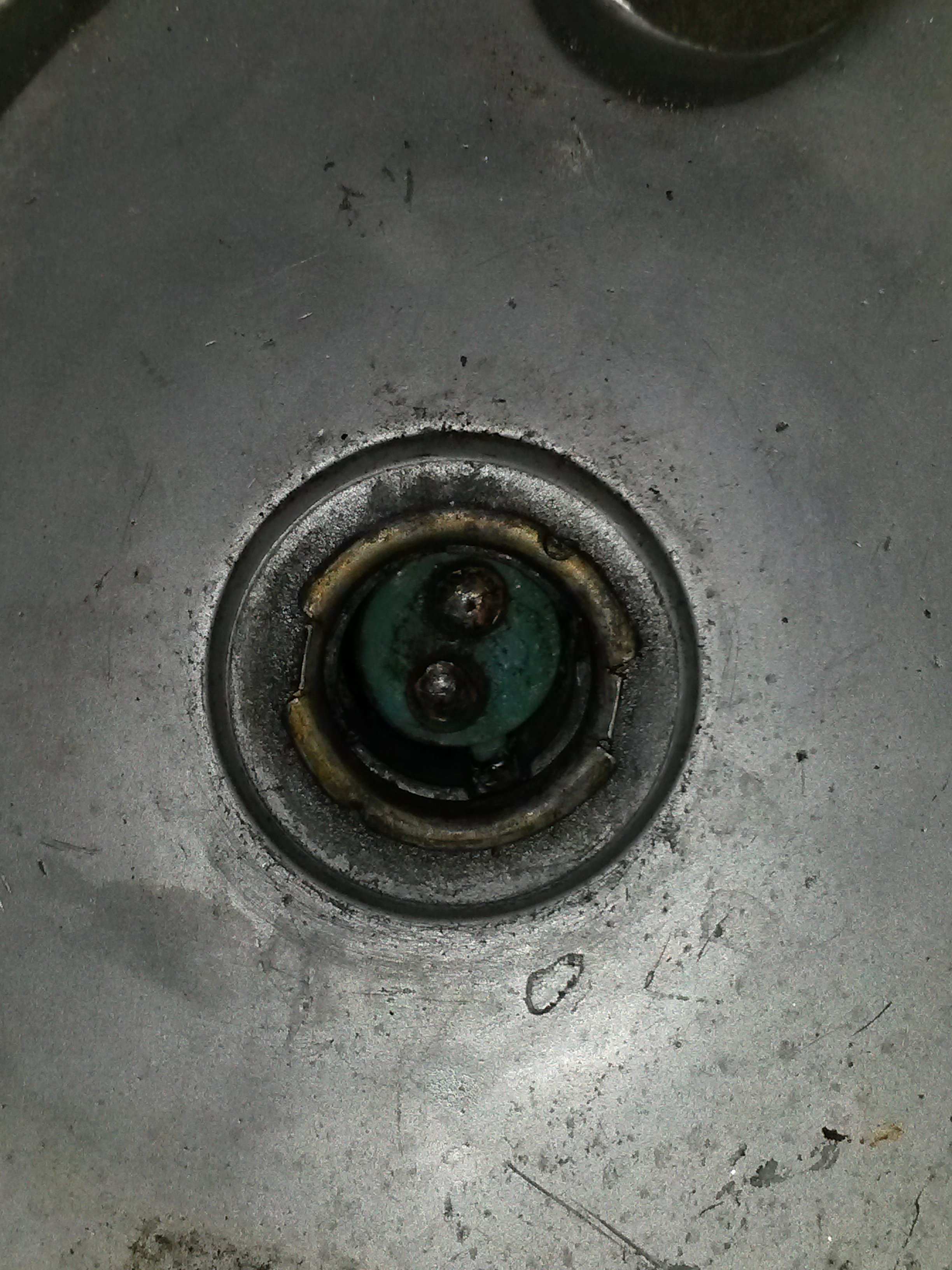

Sorry, I forgot to mention this is a 70 Barracuda. The turn signal/driving lights are a little different, There is a separate ground wire for the bulb housing. I'll check but I don't think the bulb is in backwards since I didn't remove it. The turn left signal indicator comes on also with the parking lights are on. I'm going to double check the ground. The weird thing is the turn signal indicator goes off when I turn the left signal on. The turn signal does not flash. If I turn the headlights off, the turn signals work. Thanks.

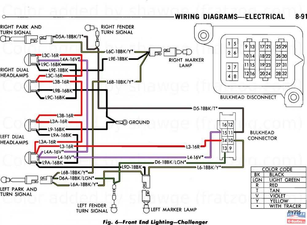

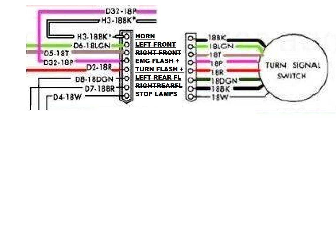

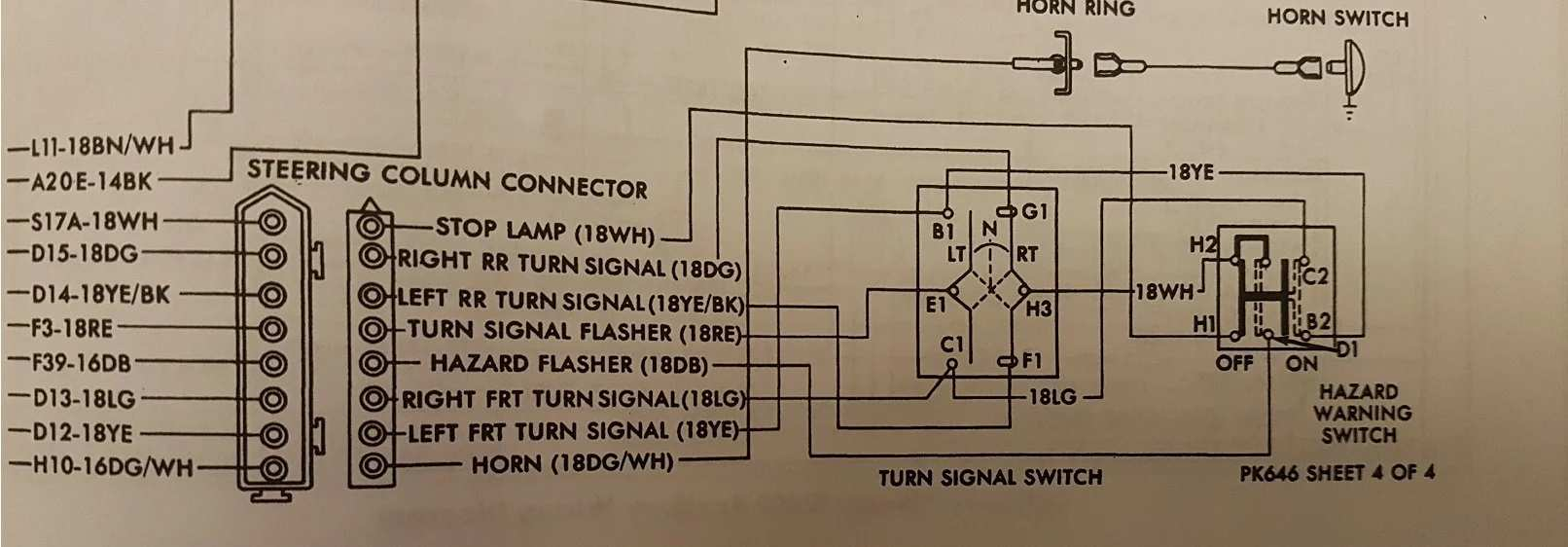

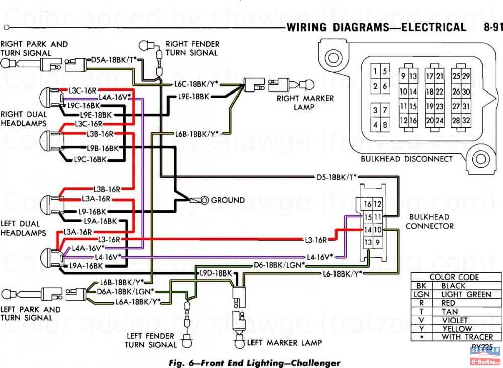

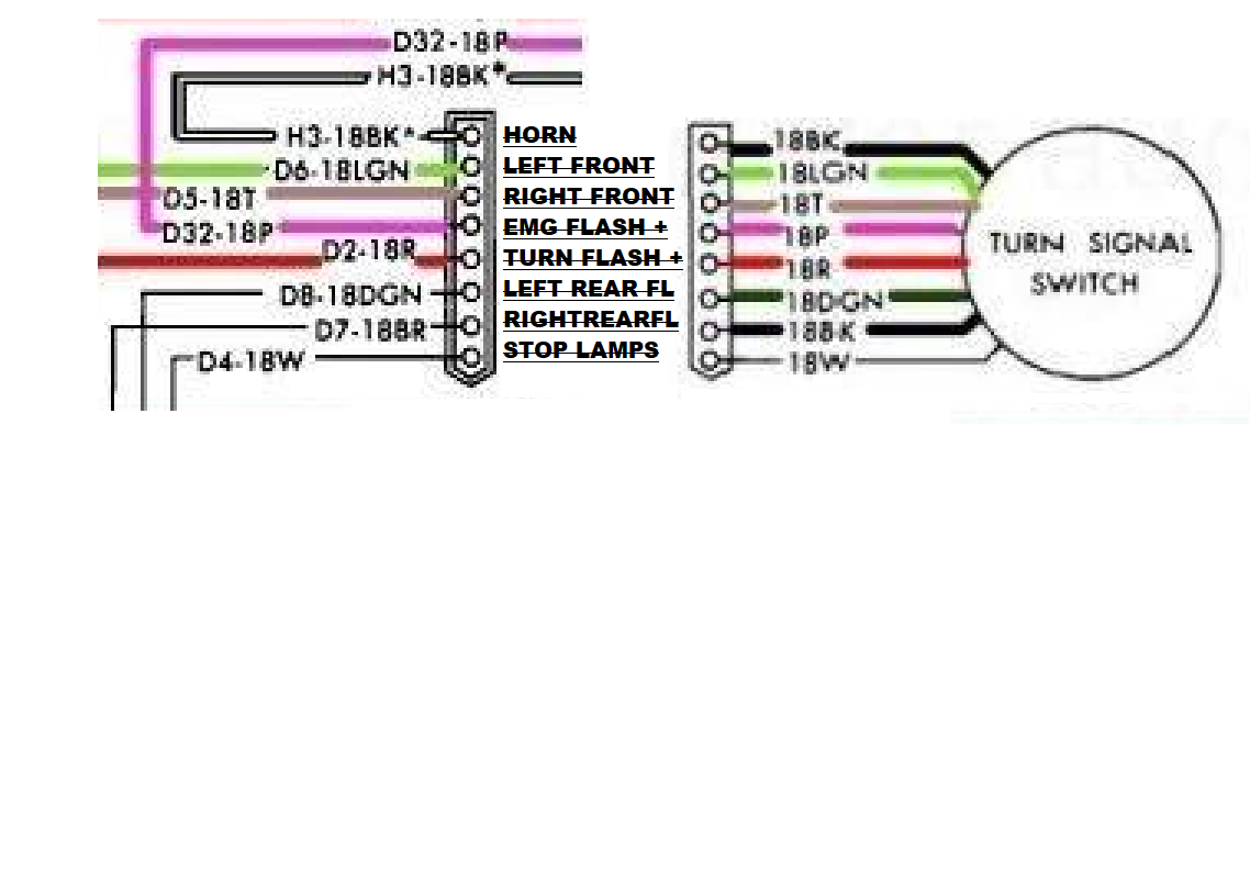

OK the top black and white is a in-general diagram of how the most turn signal switches are configured. The second color diagram didn't exist until I made it from other diagram. Or at lest I never seen one. It is the pin out of the turn signal plug under the column.

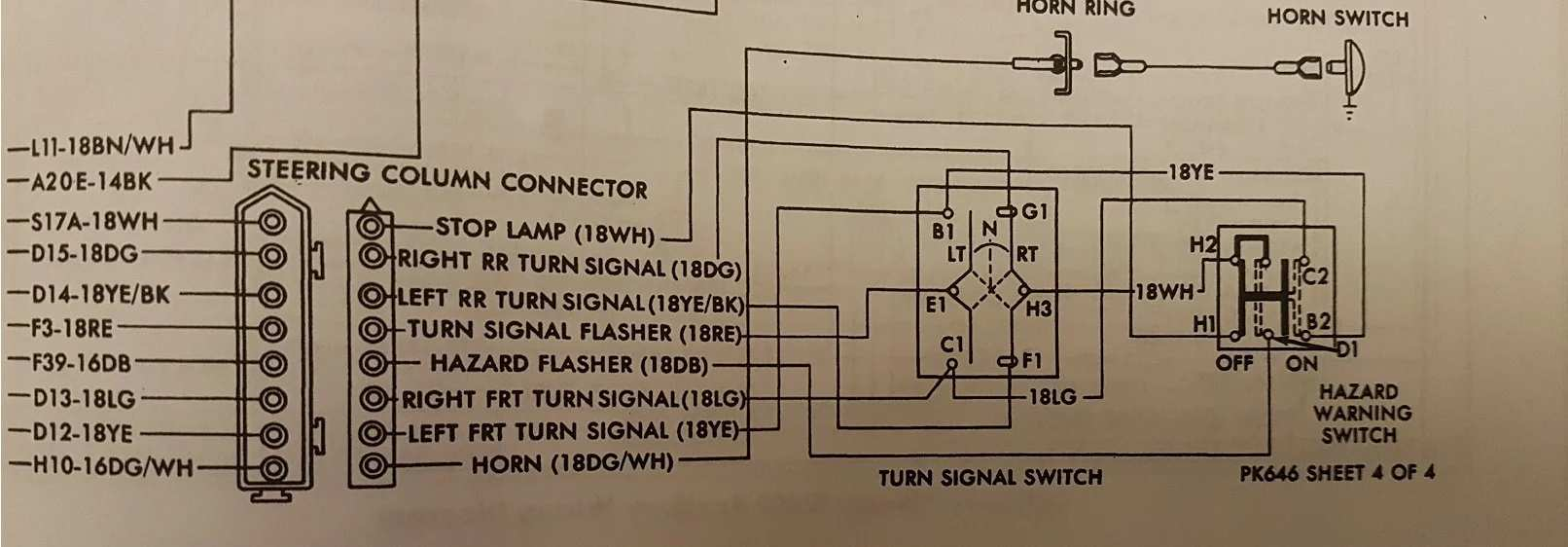

Unplug the connector. On the car plug apply power to each signal wire. that you want to check

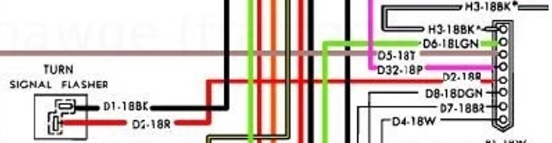

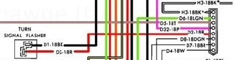

last diagram to show the dash side wiring with the steering column connector and the Turn Signal Flasher (on the side of the ashtray).
By unplugging and applying power to each signal wire. This is a quick way to see were the problem is. Use power from Batt on the fuse box. Take note that is not fused. Use a test light to test. A light will have enough resistance if the is a dead short.

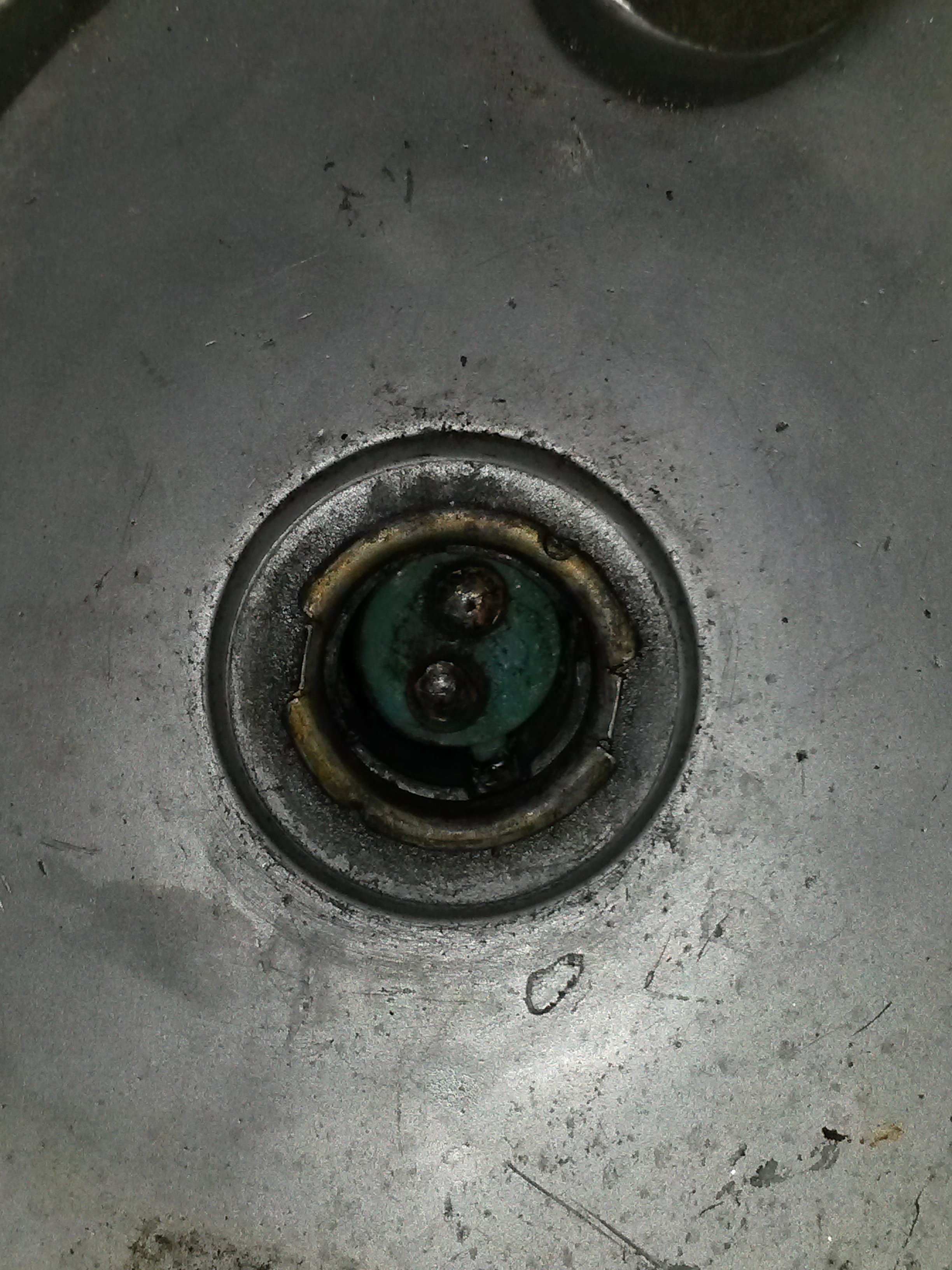

If you have a front park and turn signal light that glows dim.
The bulb is in backwards or not quite locked in. The socket is shorting out. Sometimes you really have look at it to see it. And Yes now you can put a bulb in backwards now. Cheap Chinees crap.
In a perfect world. Sockets not rusted or inner parts not bad. Check the socket connections inside and plastic insulator. Look and see! I fixed this one.
In the last picture.
