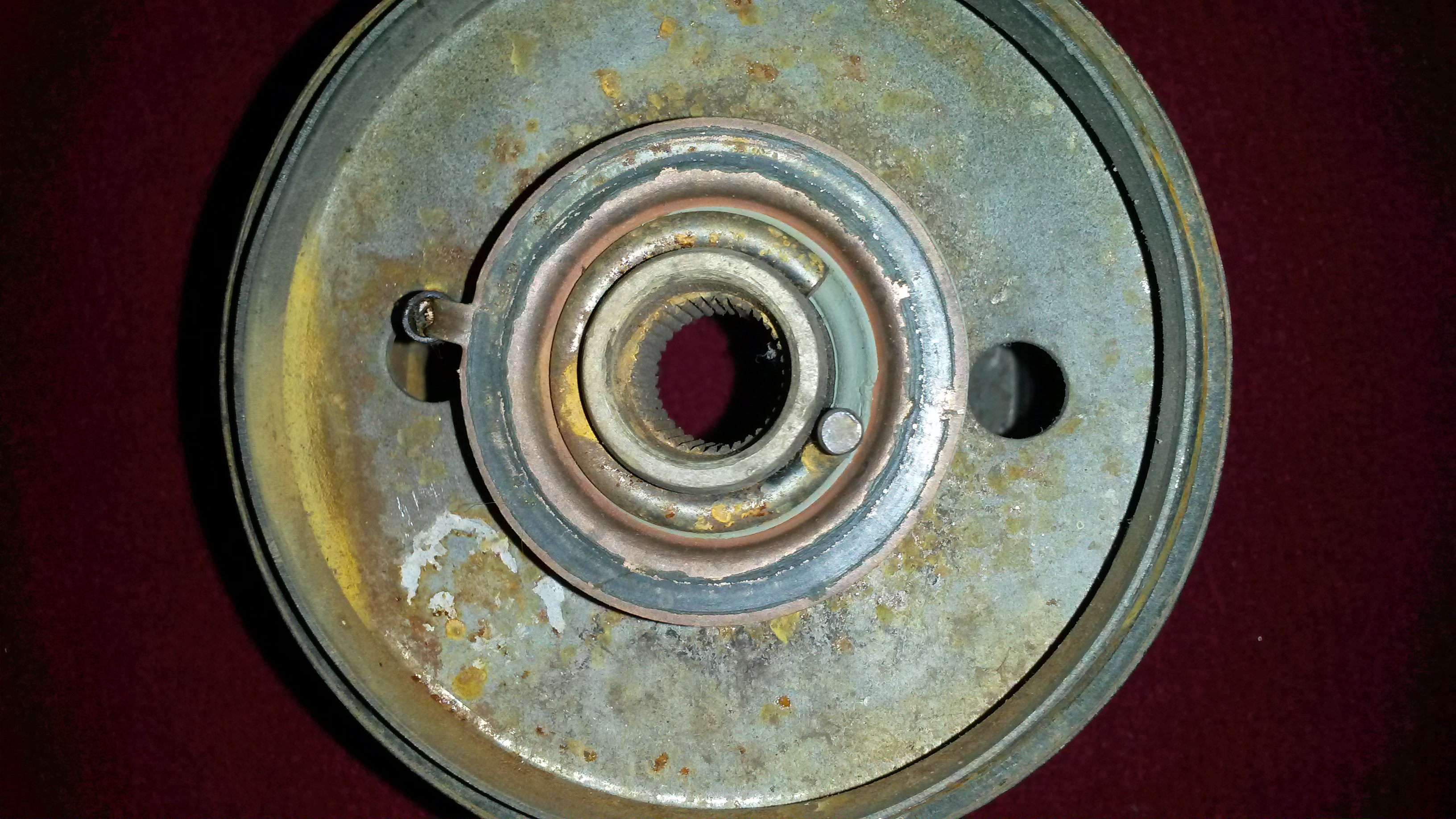

Something crossed my mind when reading you explanation. I was thinking you also changed the cancel pin. When turning one way it would clamp tight on the can. Then the opposite way it would be a loose clamping force. Opening up the C shape pin. Might not be holding tight. check it. Just a thought.🤷‍♂️

I changed the crush can. It already had the pin installed and it's tight. The pin is in the correct position, according to other posts I found on this website. With the flat spline at 3 o'clock and the pin is at 6 o'clock. Thanks
