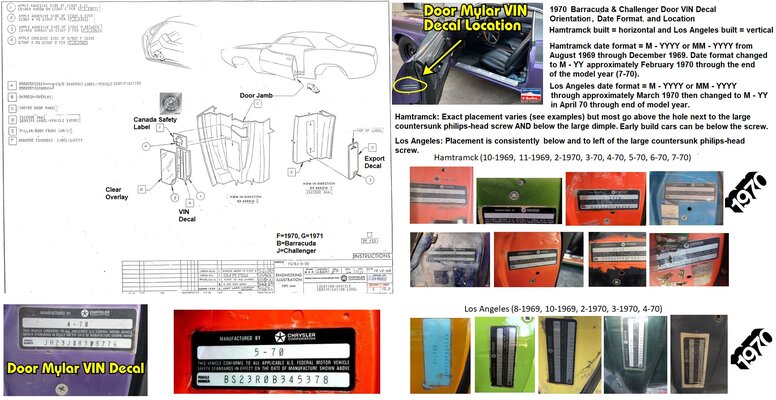

All,
I apologize if this was asked already, I did a little searching and could not find a clear answer.
I am having a door sticker made by ECS Automotive Concepts since mine is long gone. Which way is yours oriented? Are both horizontal and vertical accepted? Google image search provided plenty of examples in both orientations with maybe 60% horizontal and the rest vertical.
Secondly, besides the VIN sticker on the inner frame was there any other stickers or plates which would've been standard? My car was sold in America so no Canadian tags needed.

This is how it is on my 70

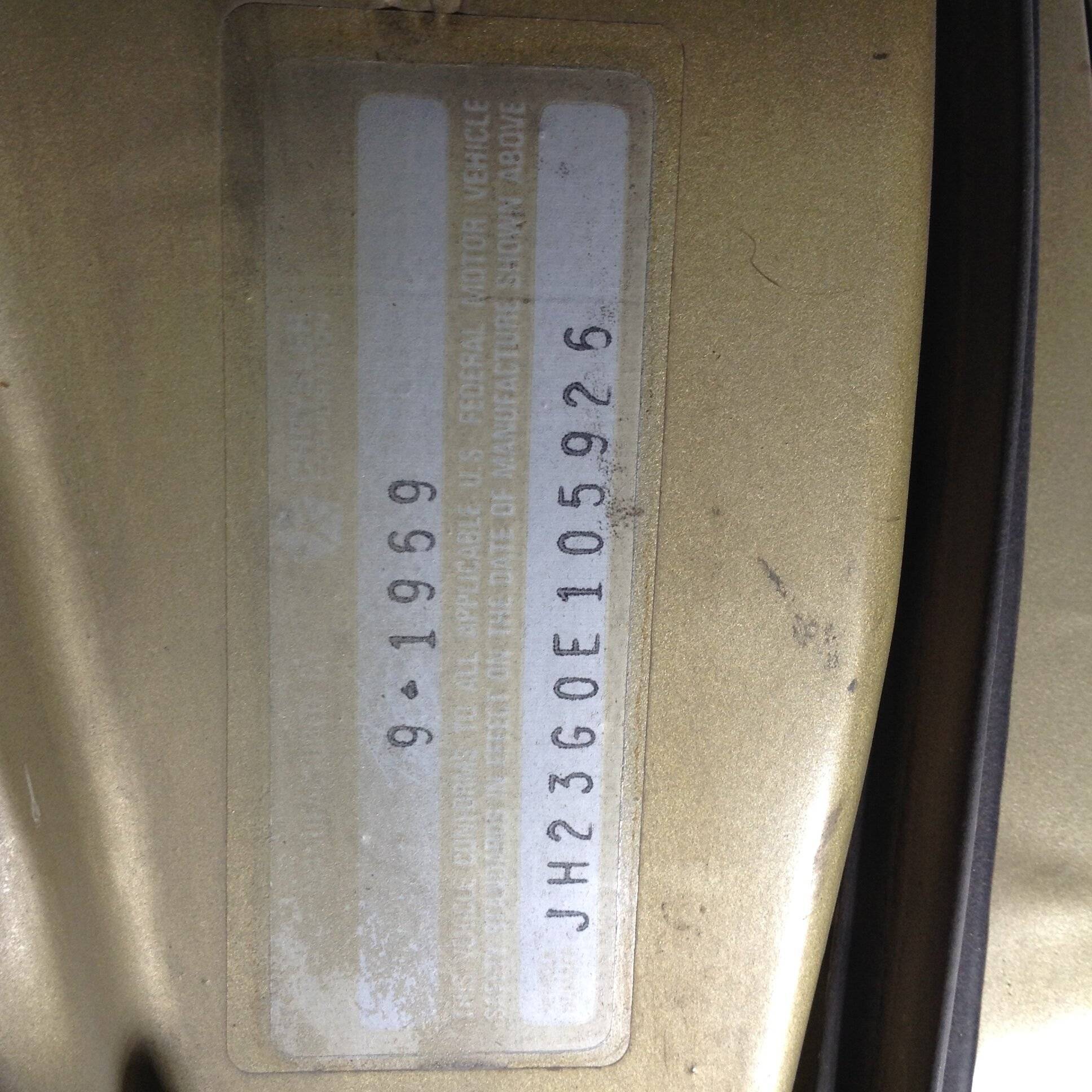

Door sticker: Hamtramck (B) horizontal, Los Angeles (E) vertical

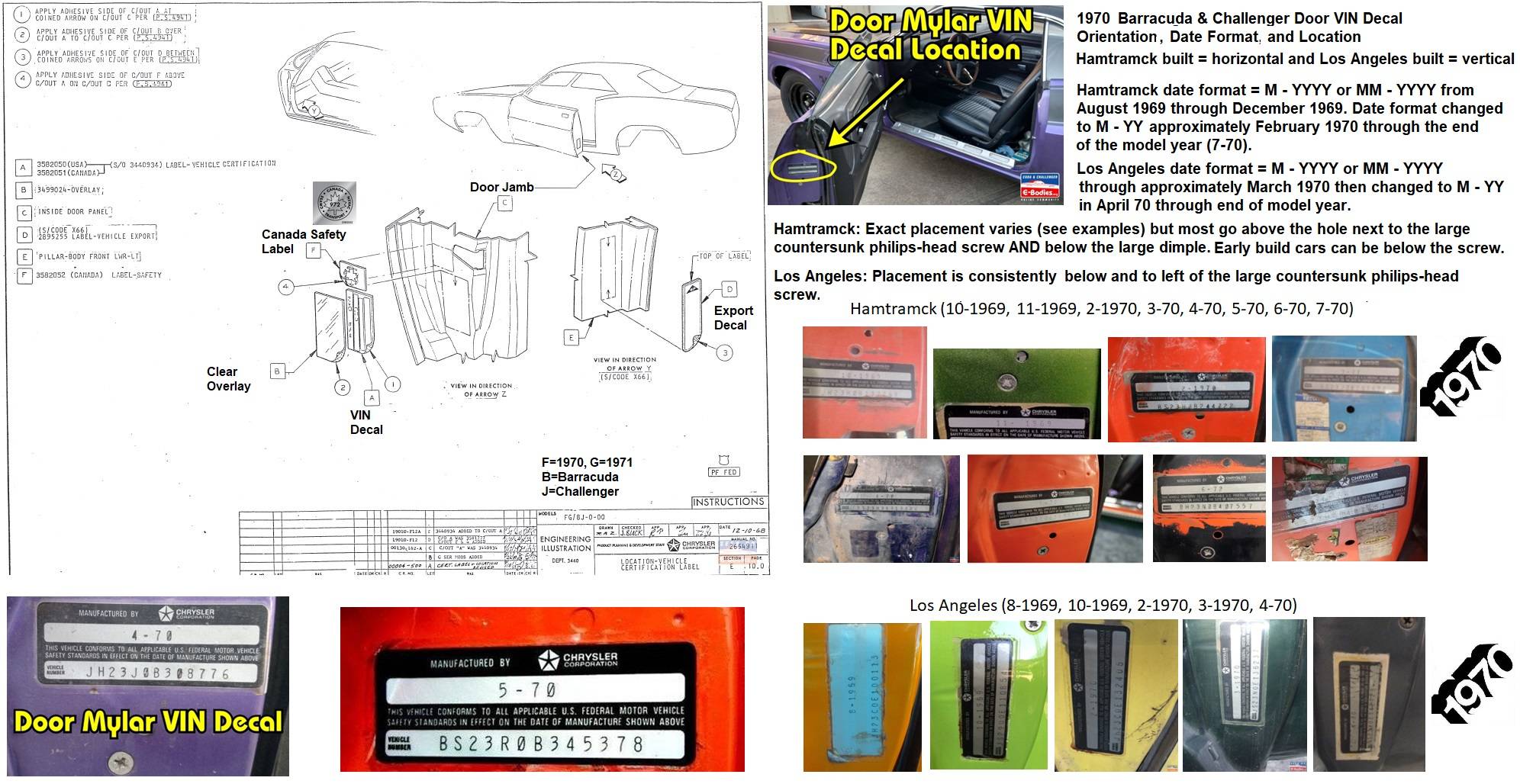

What year and model do you have? What is your Scheduled Production Date (SPD) to determine if you should have MM-YYYY or M-YY on the decal?
@Culvers is correct. Hamtramck built = horizontal and Los Angeles built = vertical.
The factory engineering drawing shows vertical for all Barracuda & Challenger in 1970/1971 but Hamtramck assembly line workers placed it horizontal anyway. The exact placement varies but most go above the hole near the large countersunk philips-head screw AND below the large dimple. They do vary within this space. Some are placed on top of the screw head while others are found between the door latch mechanism and the Philips-head screw. See engineering drawing below and graphic with examples which also show the orientation, various date formats for the Month and Year, and location/placement.

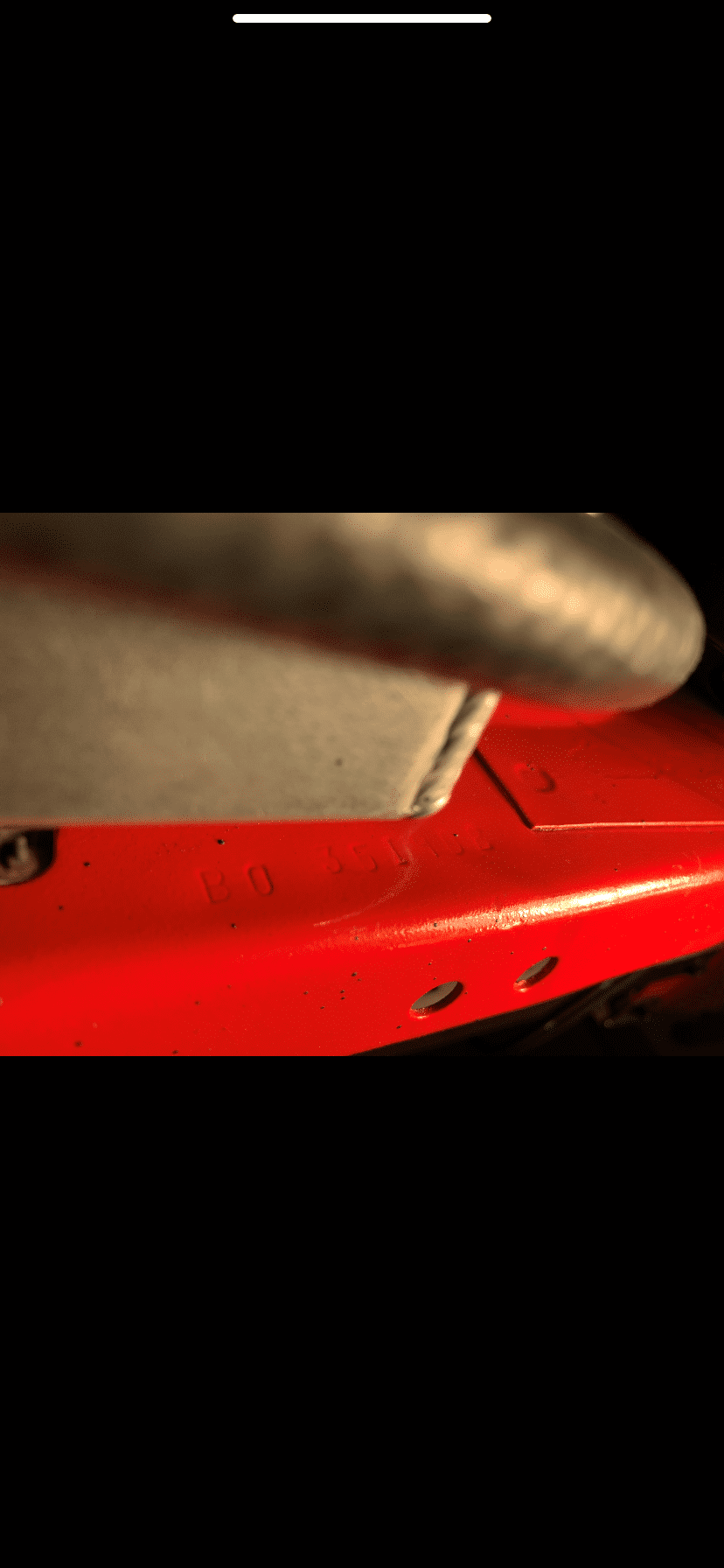

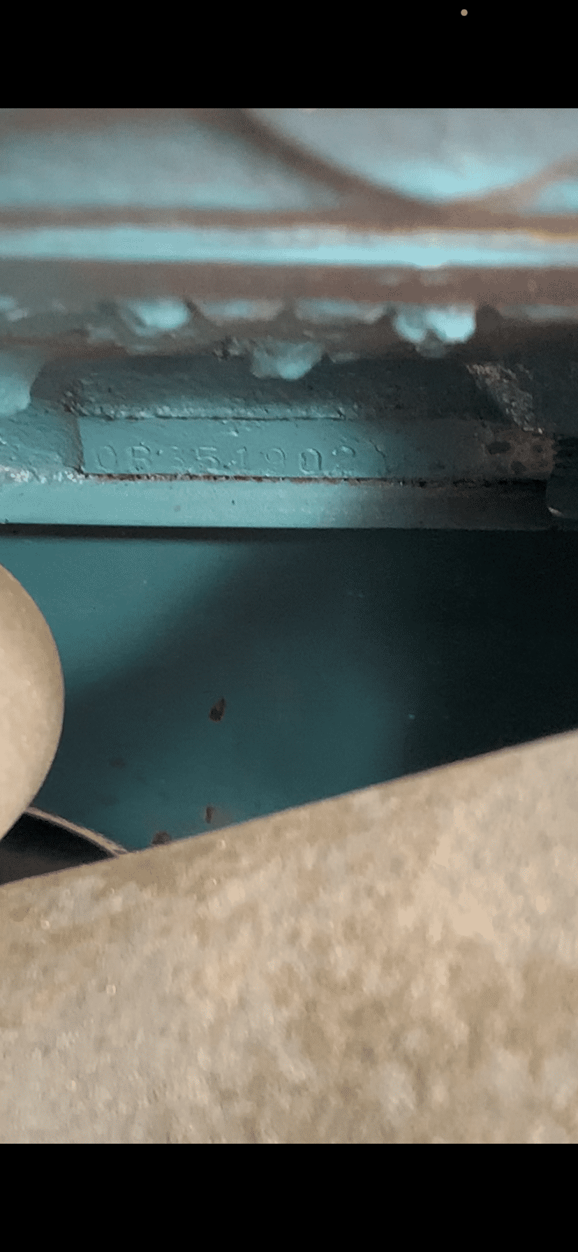

Here are the 2 easiest to spot VINs for me and luckily they match.
JH23G0B351902. Would love to know where this lies in the known VIN order if possible.
On the front of the engine I found the 10,000 day code (I think that is what it is called) for 3218. According to a decoder website that would be May 20th. The entire code reads FW 318 R 3218 1193.
I had the engine painted when we rebuilt the vehicle so I honestly cannot tell if the W is truly a W it might be a M, I cant really see which end the letter connects at.

That is the info needed to narrow your SPD down.
The engine production info breaks down like this.
FW318R32181193
F=1970, W=Windsor Assembly Plant, R = Regular Fuel, 3128 = May 20, 1970, and 1193 = 1193rd engine assembled.
That info and the sequential number of 351902 narrows the SPD to the end of May 1970 to early-June 1970. More on that later.
That does not confirm the actual build date as the SPD is a scheduled production date and can be off by several weeks but your engine was definitely built on May 20, 1970 so your door VIN decal's date has to be May or June.

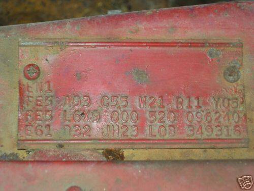

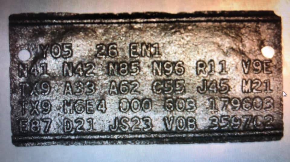

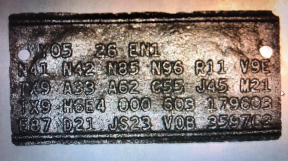

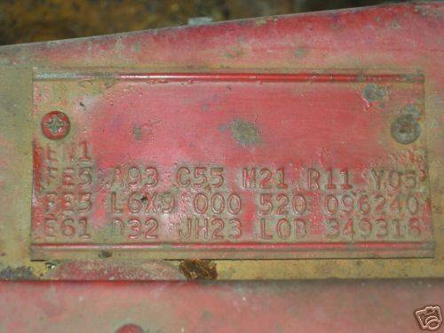

The closest fender tags that I have to your sequential number are below. I used them to narrow down the SPD.
The lower number is sequential number 349318 which is very close to your sequential number and has an SPD of 520 or May 20, 1970. Just so happens to be your engine build date. :)
The upper number is sequential number 359762 and has an SPD of 603 or June 3, 1970 so this puts your sequential number's SPD closer to the end of May than early June. That leaves 11 days in May for your engine to get to the assembly line and go into the car but only 3 days in June. Odds are your car was built in May. I would venture to say your SPD was between 521 and 531 which would, if built as scheduled, put your door VIN's decal as 5 - 70. If it was delayed for any reason, it is possible the door decal would be 6 - 70 but more info is needed to pin it down exactly.

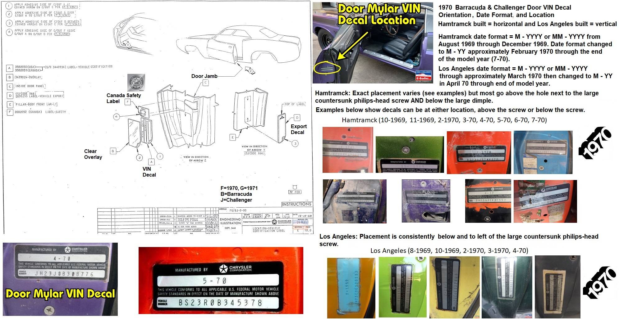

Updated door VIN Decal location diagram for 1970. The diagram has been updated to reflect additional confirmation that the Hamtramck door VIN decal can be located either right above the door latch or further up above the hole next to the Philips screw. Most are at the upper location but original, survivor decals show it can also be a the lower location.
