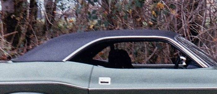

I had this done like 30 years ago at a local boat top/ upholstery shop. The same shop is in business, but now the son runs it and said that they can still do it. Then they did not have to have the trim, but instead they ran a rail system, and put a matching vinyl trim on as pictured below. I don't know if they can still do it, but it is another option.
