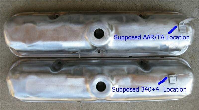

There’s a debate whether they are anything different from 340-4 valve covers. I personally think they are unique based on the survivor cars I’ve seen. I can’t recall all the subtle differences (two or three, I think) but the most obvious difference is the height of the spark plug wire tab on the D/S cover. IMO, the AAR/TA cover tab was about a 1/2” taller than the 340-4 version. Some chalk up any differences in the valve covers to supplier variations rather than intentional AAR/TA design. The taller tab makes sense to me when you look at how the brake booster vent hose attaches to the manifold on a 340-6.

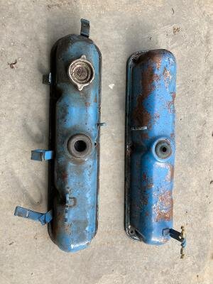

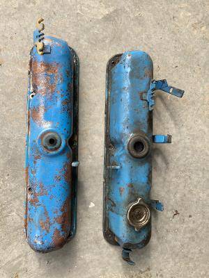

I have this pair that I got in a package deal.
I was told they were 73/4 340 but I really don't know.

I couldn't remember the difference. I asked a friend Scott Smith owner of Harms Auto www.harmsauto.com. He sent me this picture. It is still up for debate and the difference could be something as simple as Mopar changing vendors.
