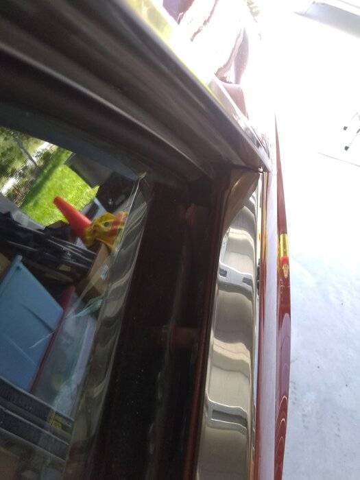

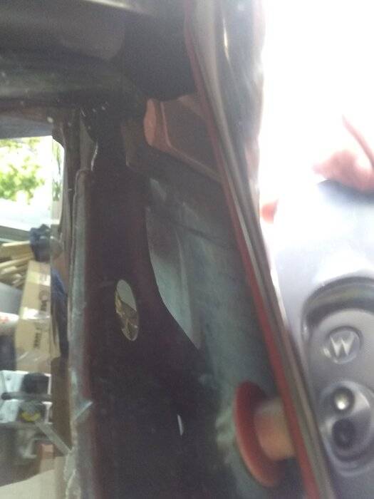

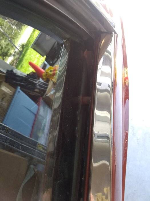

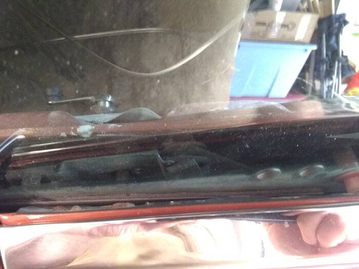

Could Somebody Tell Me what I am missing? It's been over 10 years since I've owned
a E-body and my memory isn't what it used to be.
Is there supposed to be some kind of U shaped gasket seal and inner and outer felts?
This is for the rear Quarter windows on '70 Challenger. Thanks All

The felts go onto the body and onto the inner door panel, together they take up the gap between the glass and the channel.
70chall440
Dec 11, 2010
1,261
984
Western Washington
There is a rubber piece on the ends of the door and on the end where the quarter window goes down but it does not run the length of the window opening, only the felts are there.
