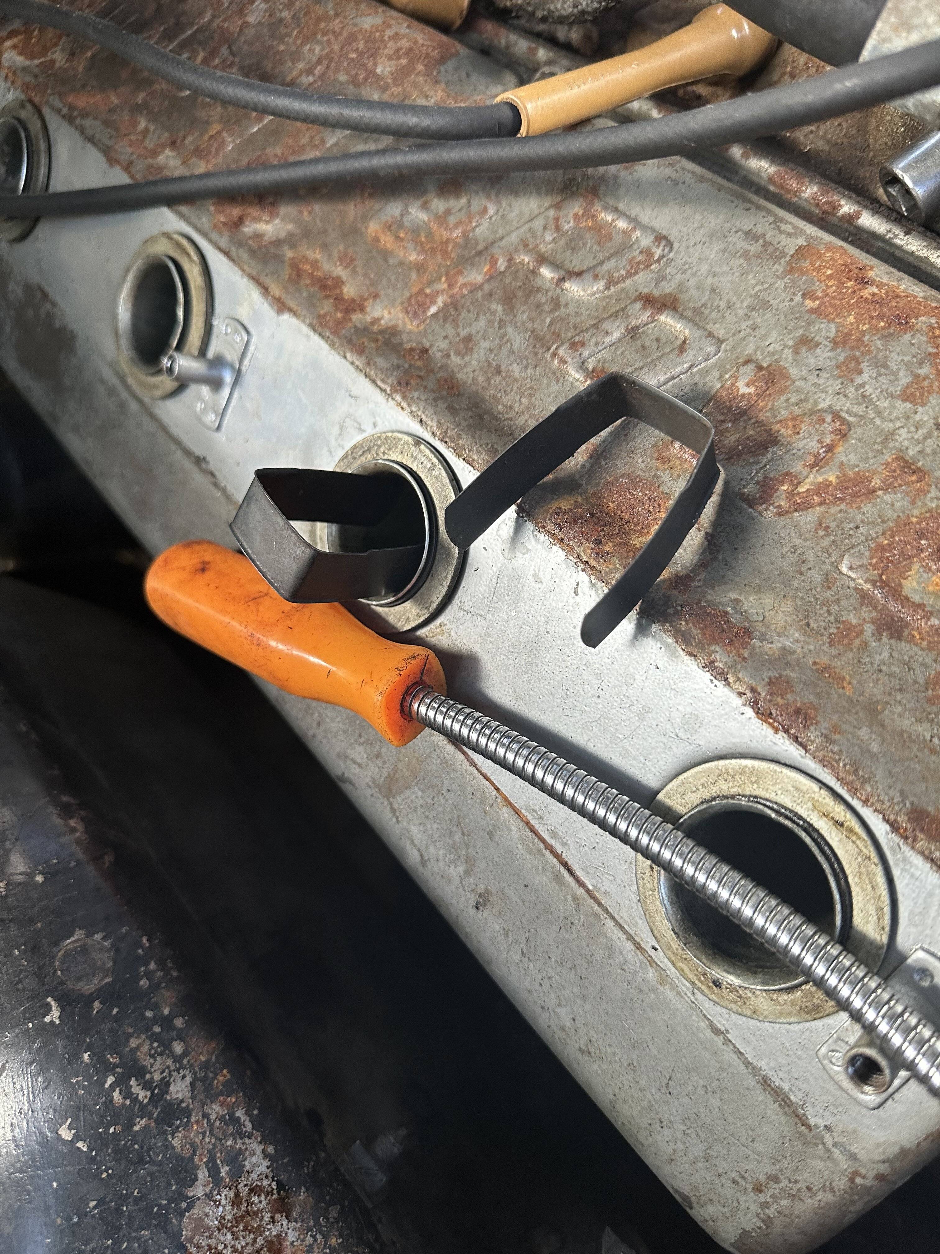

OK these are in a 1954 Chrysler New Yorker deluxe underneath the valve. Cover cap on a 331 hemi. What are they called? I need three more For this original rig.
