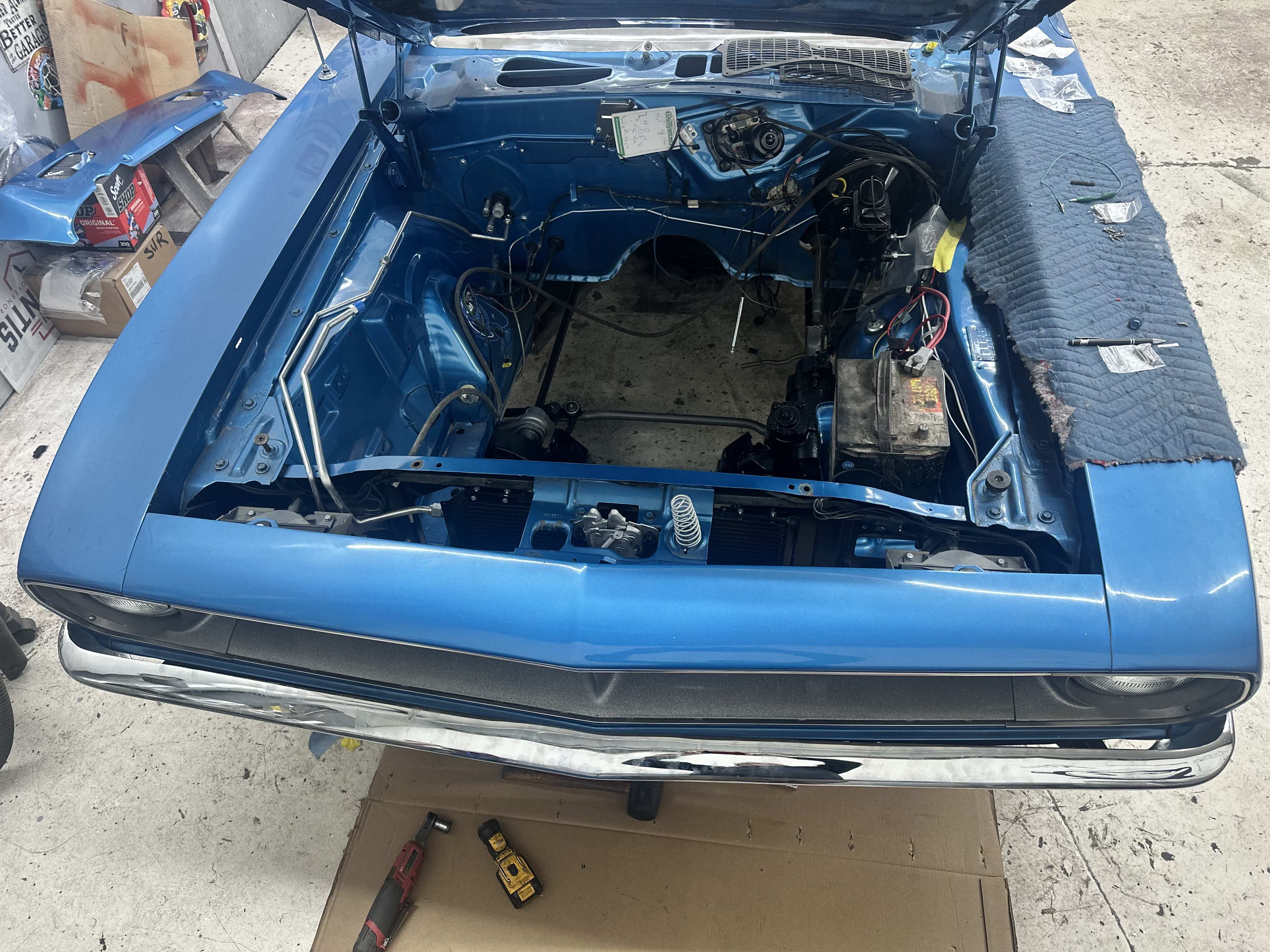

Why is there such a large gap? Just got the bumper back from the chrome shop. Tight in the center but wide on the ends.

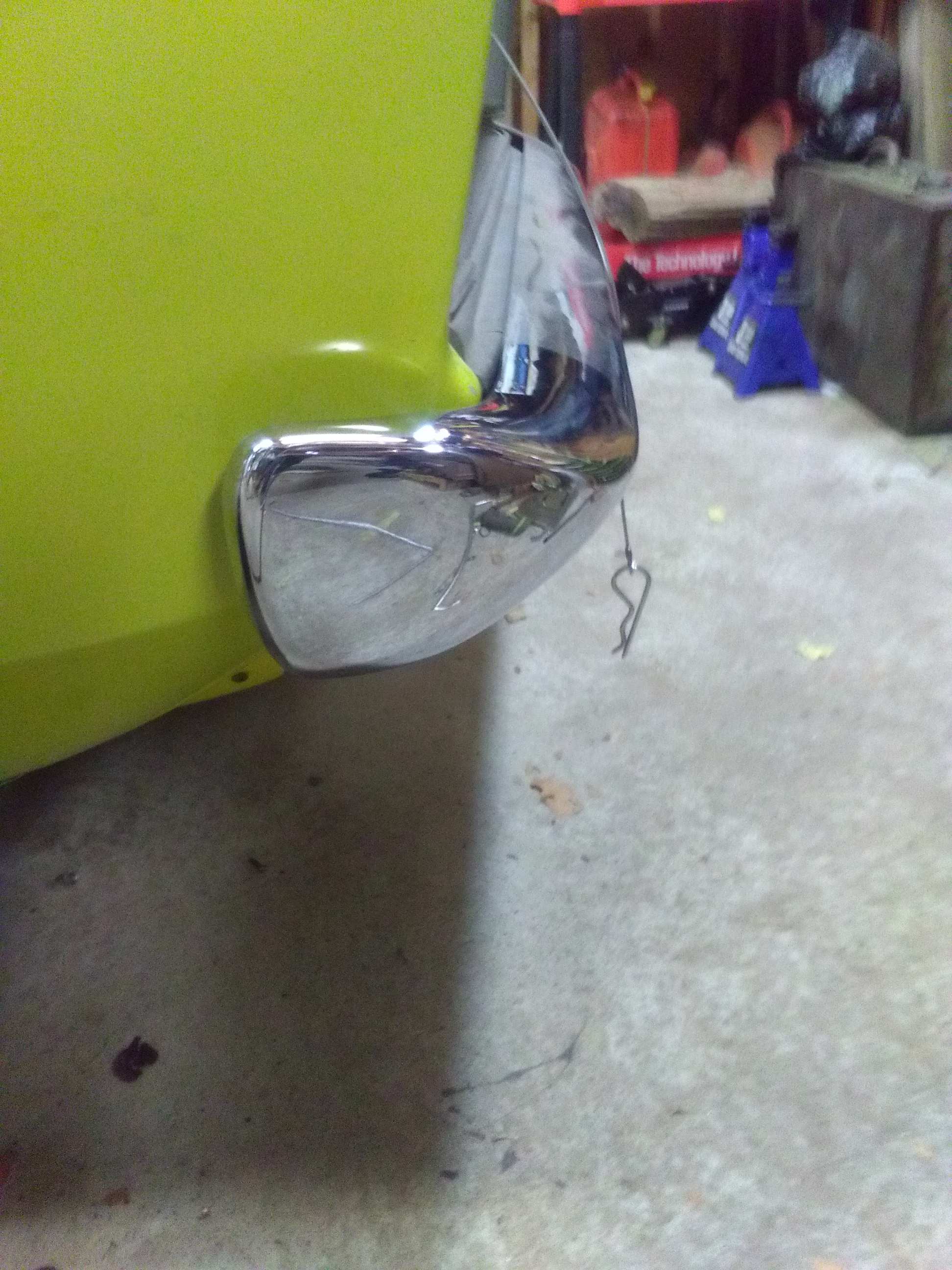

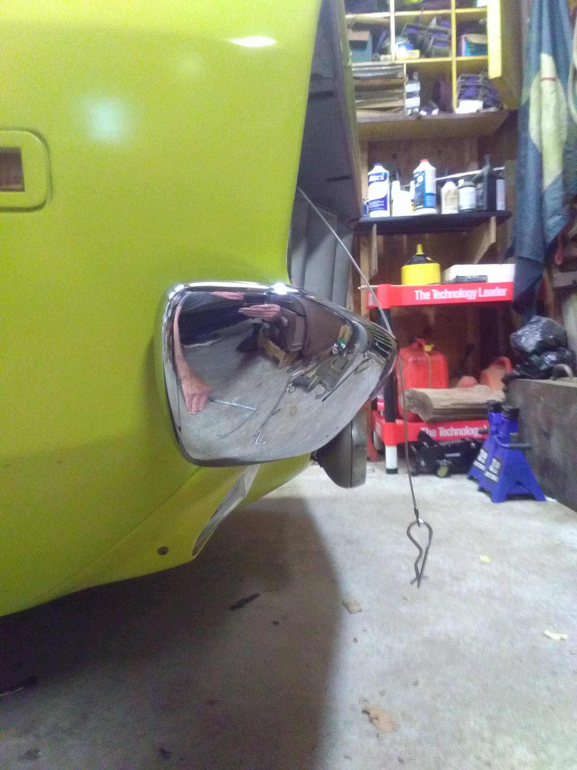

Challenger RTA
Oct 28, 2018
3,964
2,076
PA Flood city
This is what I was referring to. I wasn't about to put the rubber bumpers on just then. A good while back I put a used bumper on so I could push and pull it around. If it is held up to the body and it matches check the brackets. Or the wrong ones.

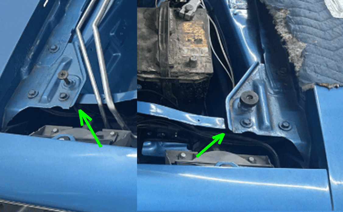

Daves69
Feb 4, 2014
352
122
ChiWest
I'm no body guy but I'll cite an observation from your OP picture.
Maybe it's a clue or no help at all but it appears your passenger side fender may be further forward than the driver side............
Challenger RTA
Oct 28, 2018
3,964
2,076
PA Flood city
Good catch! 48 1/8" from the fire wall the front of the core support. Measure along the top of inner fender where the A/C lines run.
