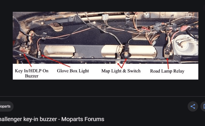

So I am looking for the key buzzer box on my 70 Cuda. The buzzer wasn't working . Any one have a photo or tell me where to look ?
Thanks for your help !!
Thanks I didn't know that.In 70 it is part of the horn relay in the fuse block
