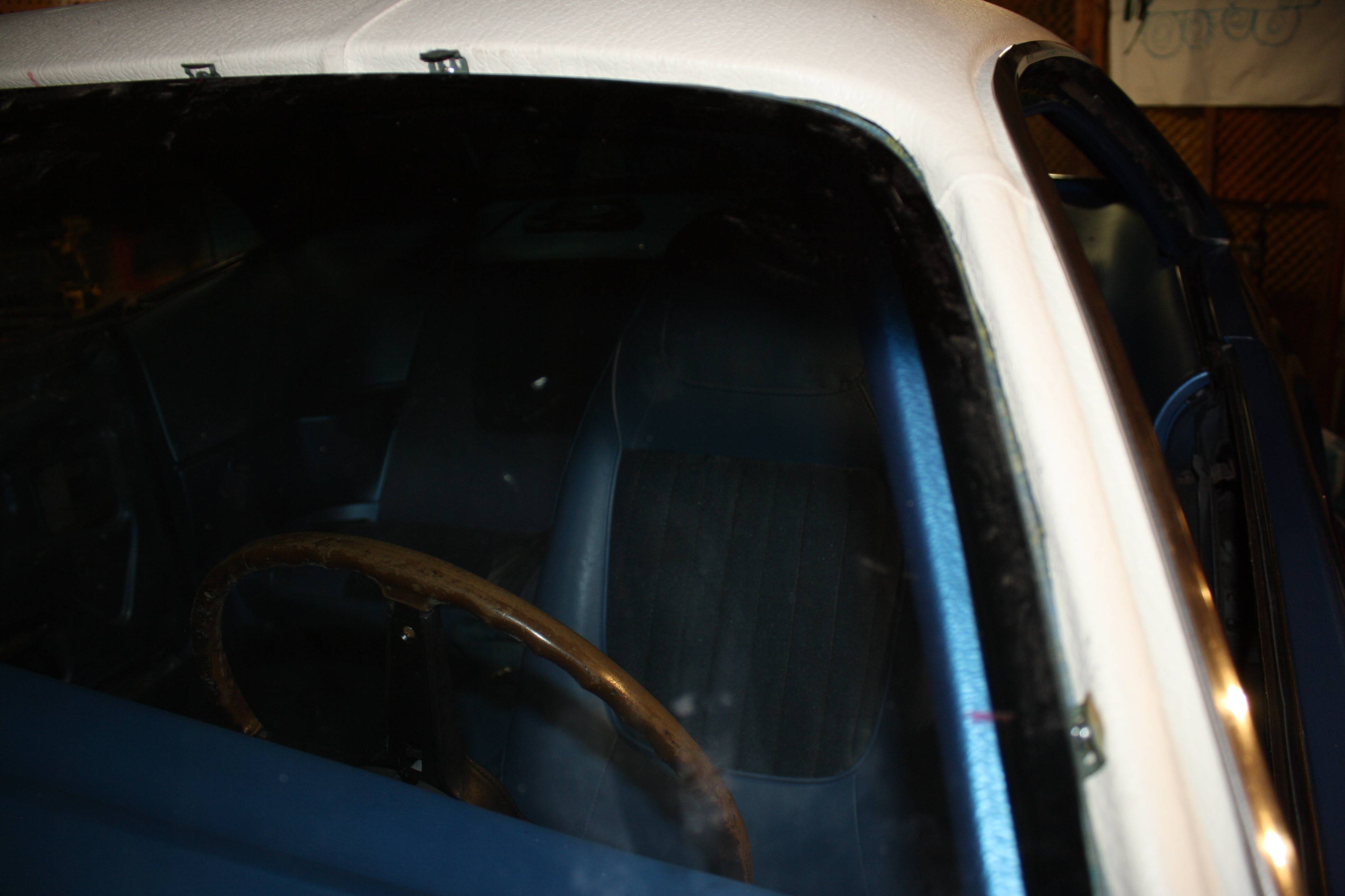

not there-----checked and re checked before vinyl top and windshield install----I have a 73 Chally. I have three studs for the clips coming down the pillar. There is one near the vinyl fold as you turn the corner on mine.
is there any way ti install clips after glass is in placenot there-----checked and re checked before vinyl top and windshield install----
bee warnedIf you try to install clips after the windshield is installed, be prepared to buy another windshield. I did.
Terry W.

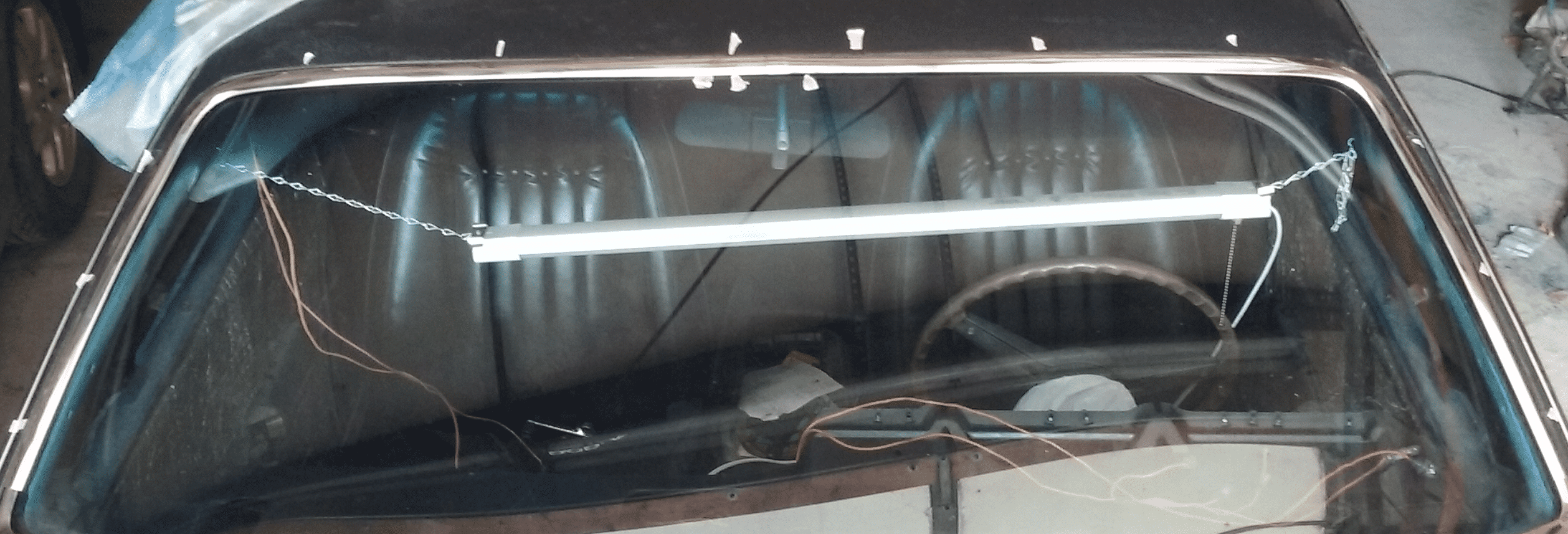

biggest thinking problem was not cracking glassTape on outside.3 on each side.6 across the top. drill 1/16" hole then enlarge to 1/8". Use a small spacer in the channel to protect windshield and hold starting point. or drill a hole in a stick . Popsicle sticks or a piece of metal to hold you position. Use small needle nose to turn screw in.It's a pisser but it can be done.
Think you way out of this problem!
Did you get them drilled?biggest thinking problem was not cracking glass
no, working on other small details, but will try later onDid you get them drilled?
