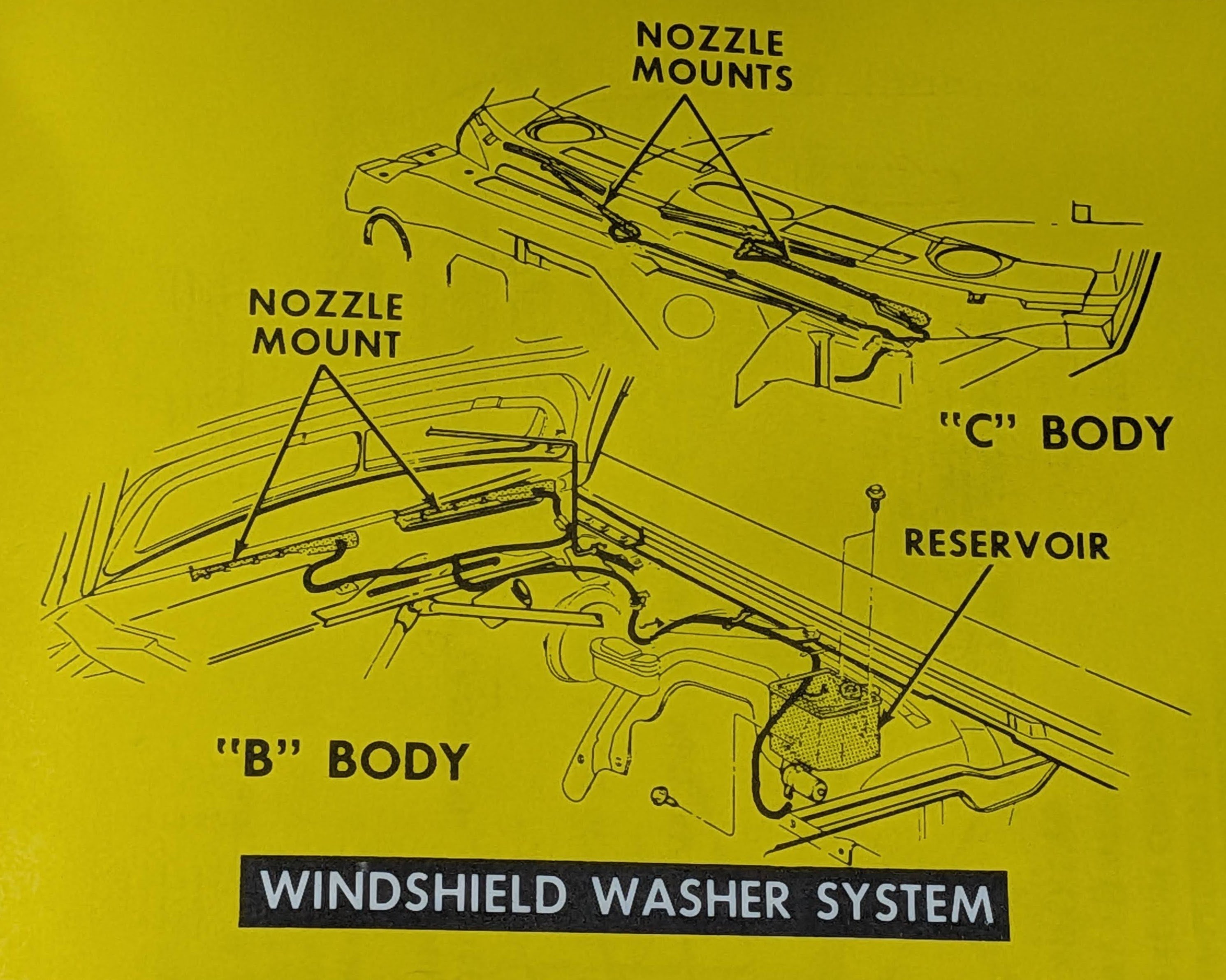

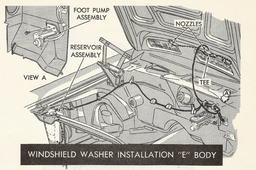

The nozzles mount to the bottom of the hood and point through the hood grills. The following image shows the 1970 E-body layout with foot pump shown in the diagram. The electric washer pump version is essentially the same, minus the routing to the foor pump.

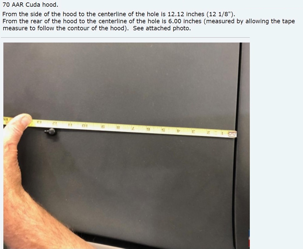

No holes are in the surface of the hood for the nozzles, except in the case of the AAR 'Cuda and Challenger T/A which use different, hood surface mount nozzles on their fiberglass hood.

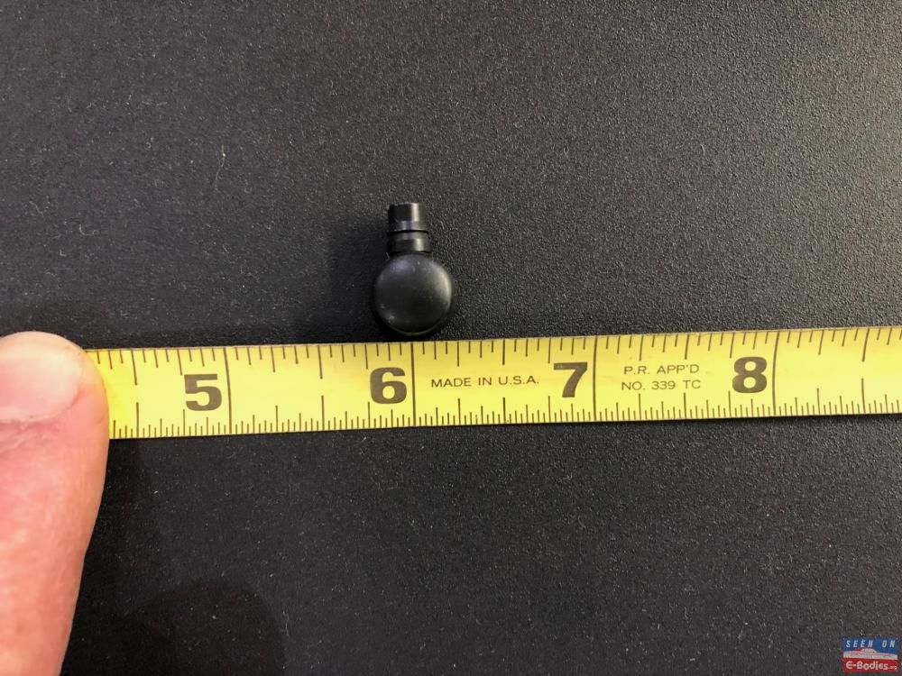

I just stripped my hood of parts, making ready for soda blast. I was able to get my original tee off without damage. Was a little surprised...

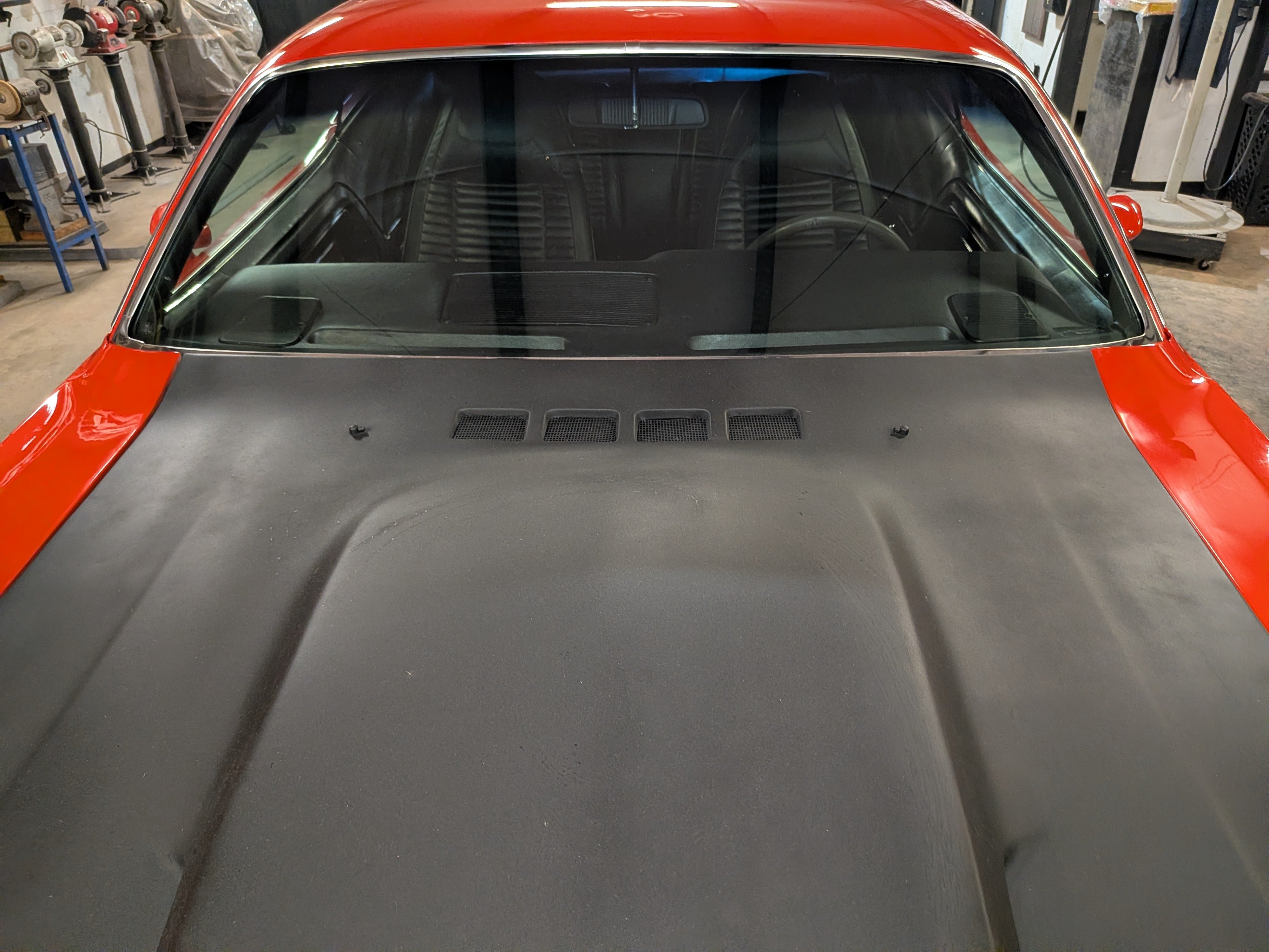

I have an aftermarket fiberglass hood. There is no vent or holes on the hood.

I have an aftermarket fiberglass hood without holes or vents. I may need to drill holes unless I can think of another idea.
With an aftermarket fiberglass hood, placement could be where it fits best. As a start, you could base it on the factory fiberglass hoods and use the factory style nozzles for them. I don't have an AAR 'Cuda to measure or photograph, but I have two Challenger T/As. Following are pictures of the factory nozzles and tubing underhood. This is with an electric washer pump.

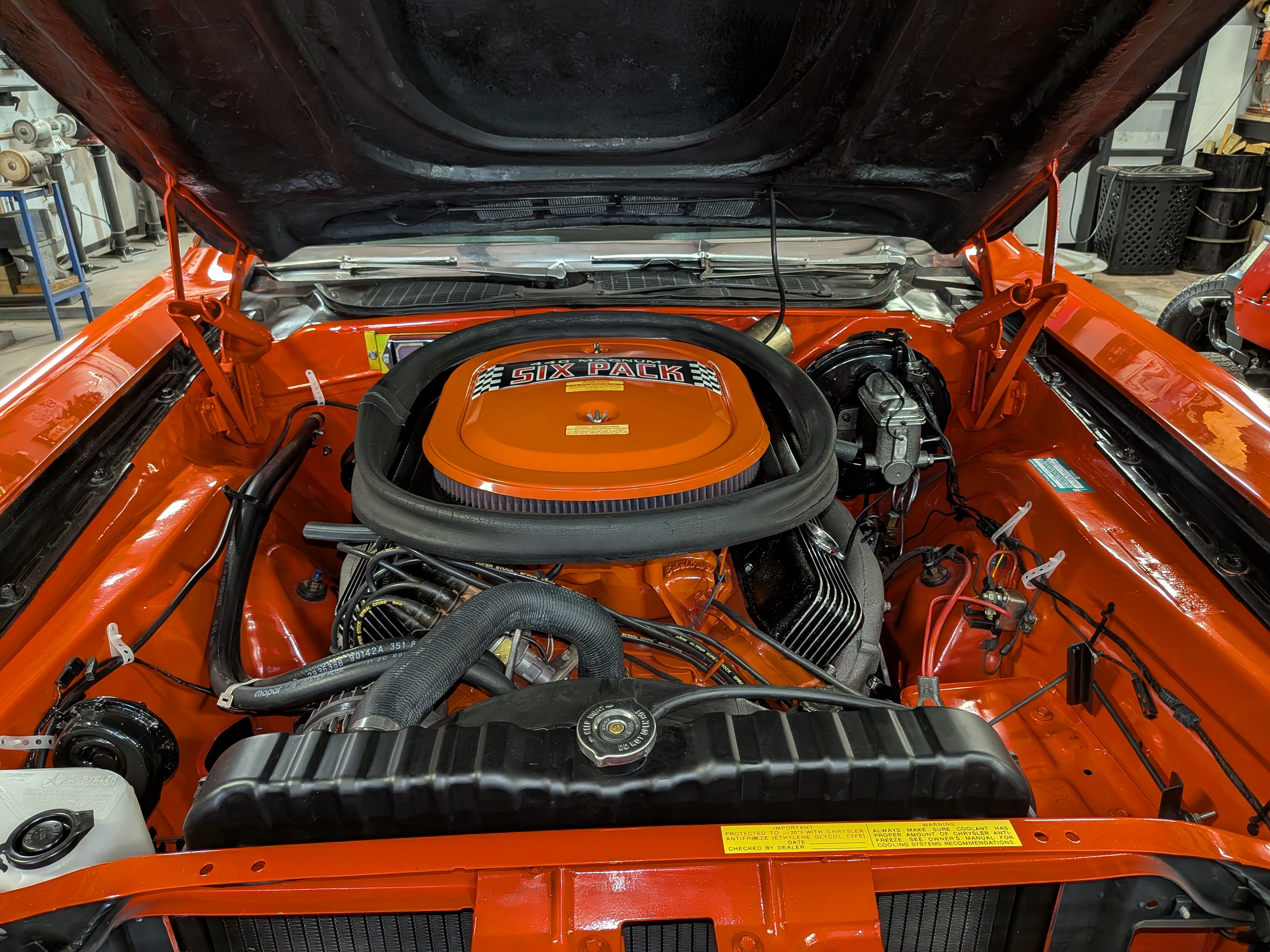

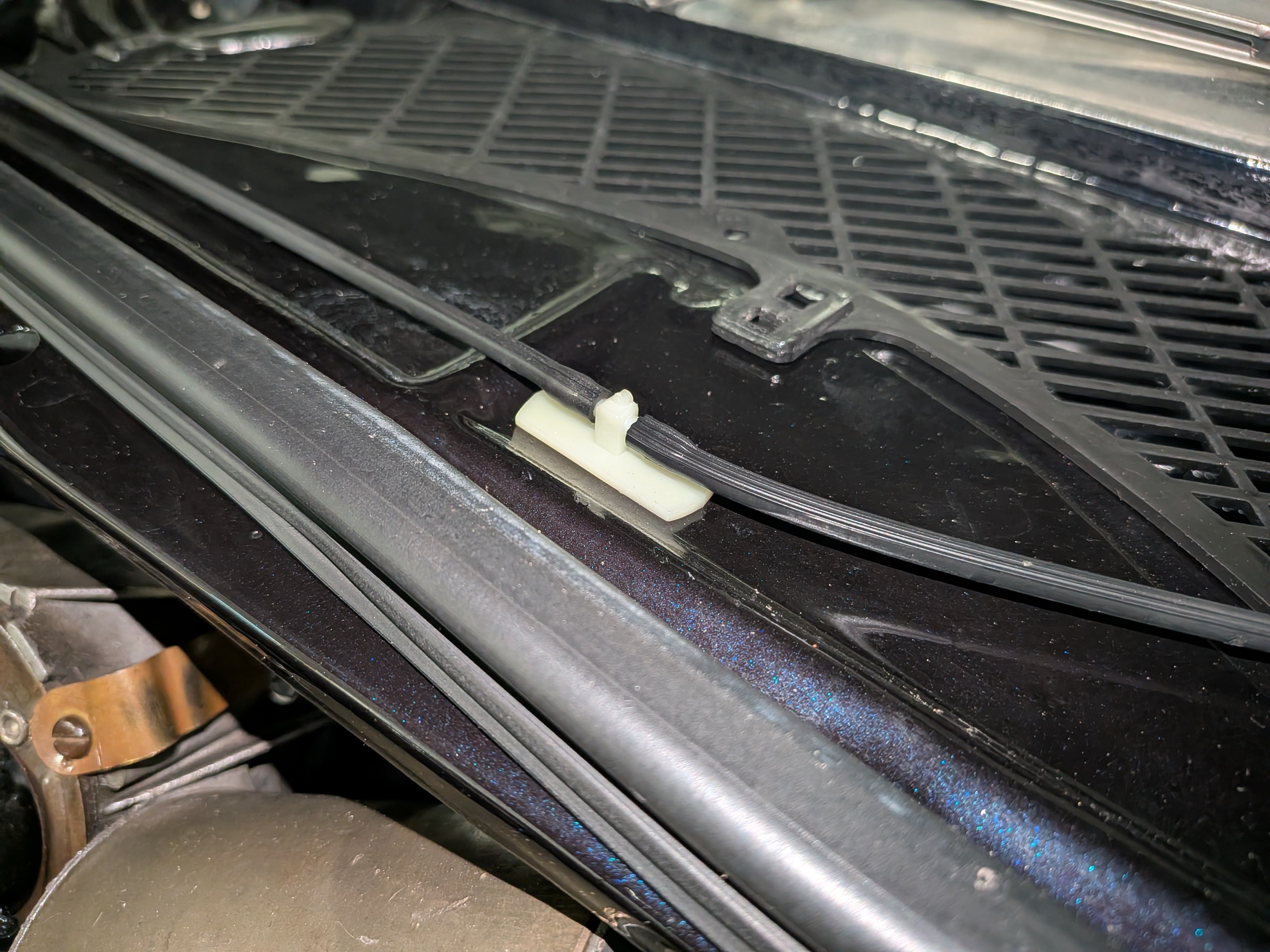

Driver side nozzle underhood, with tee:
Passenger side underhood:
Overview with larger hose to the reservoir and to the hood:

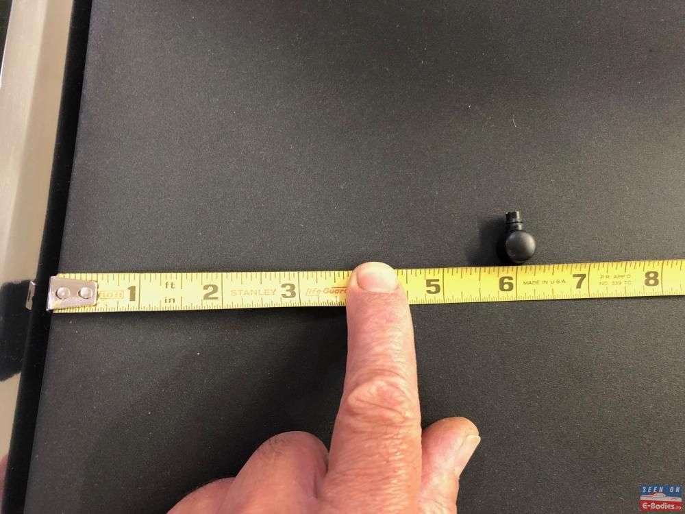

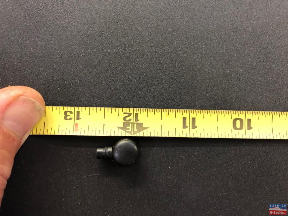

Hood surface with nozzles:
The nozzles measure 12 inches in from the side edges of the hood, and 5-5/8" from the back edge of the hood, to the center of the nozzle. Placement may differ some on the 'Cuda hood, and for whatever under structure the aftermarket hood has, but this may provide a guide to start.
The rest of the layout from the factory diagram and the hose lengths from my prior post can still work.

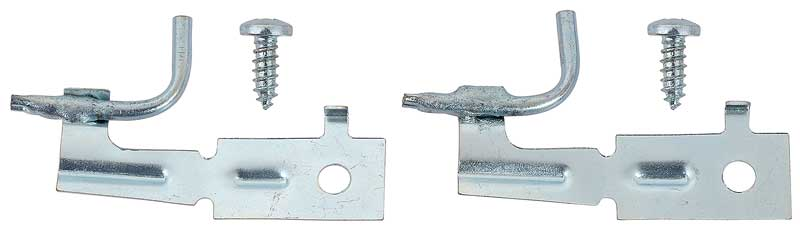

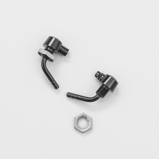

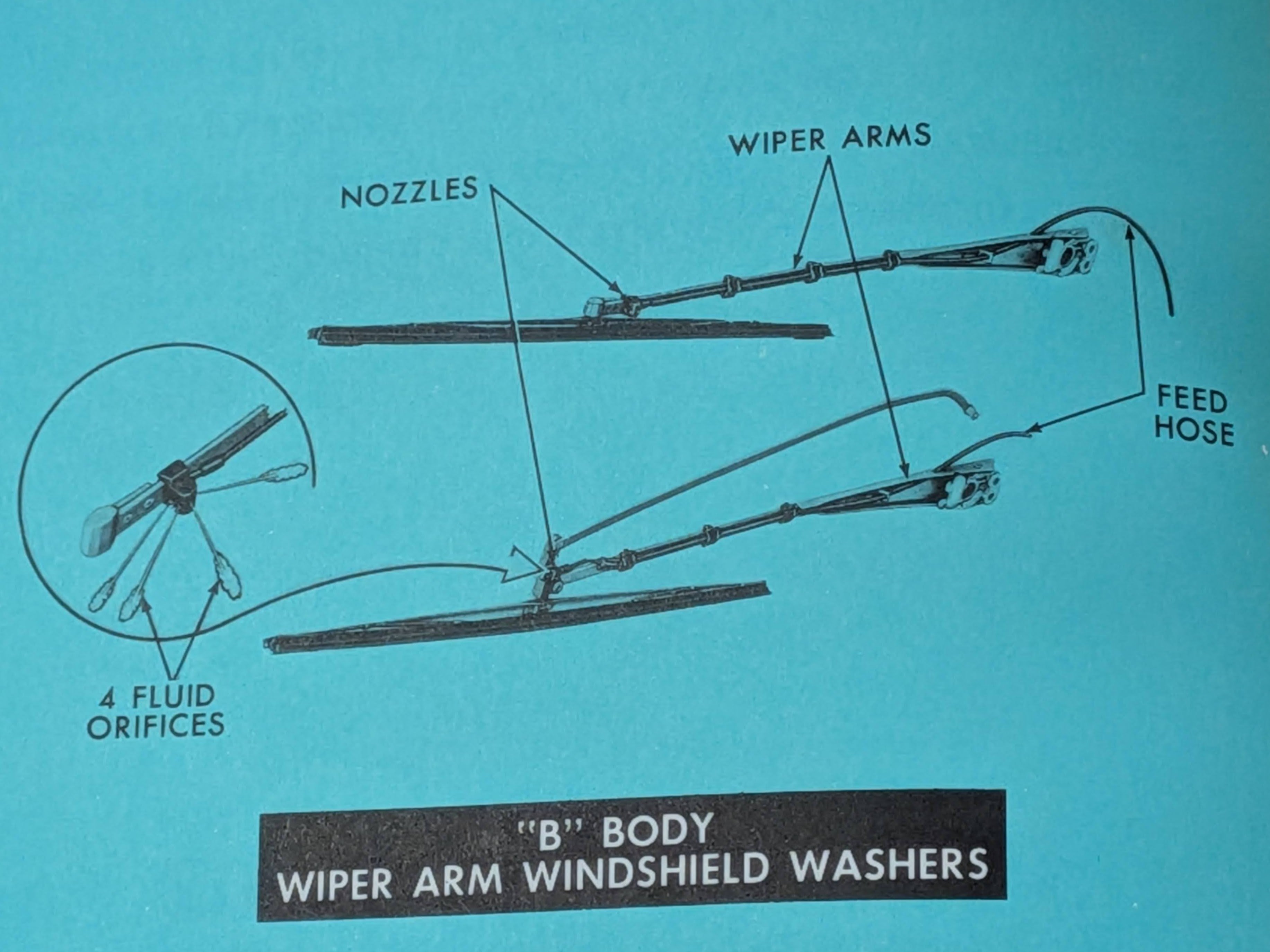

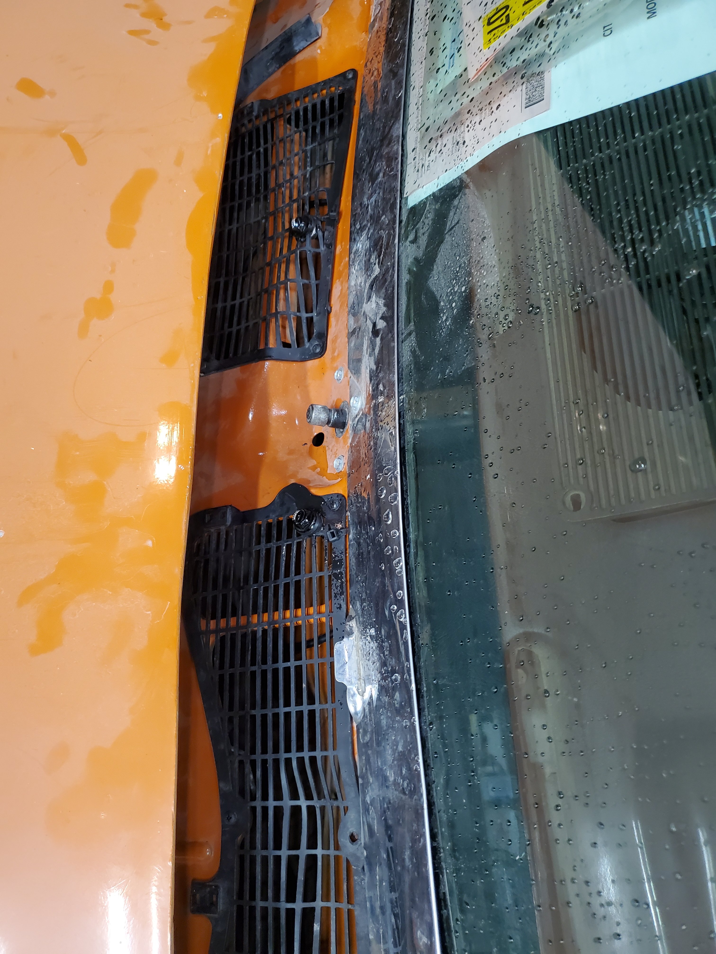

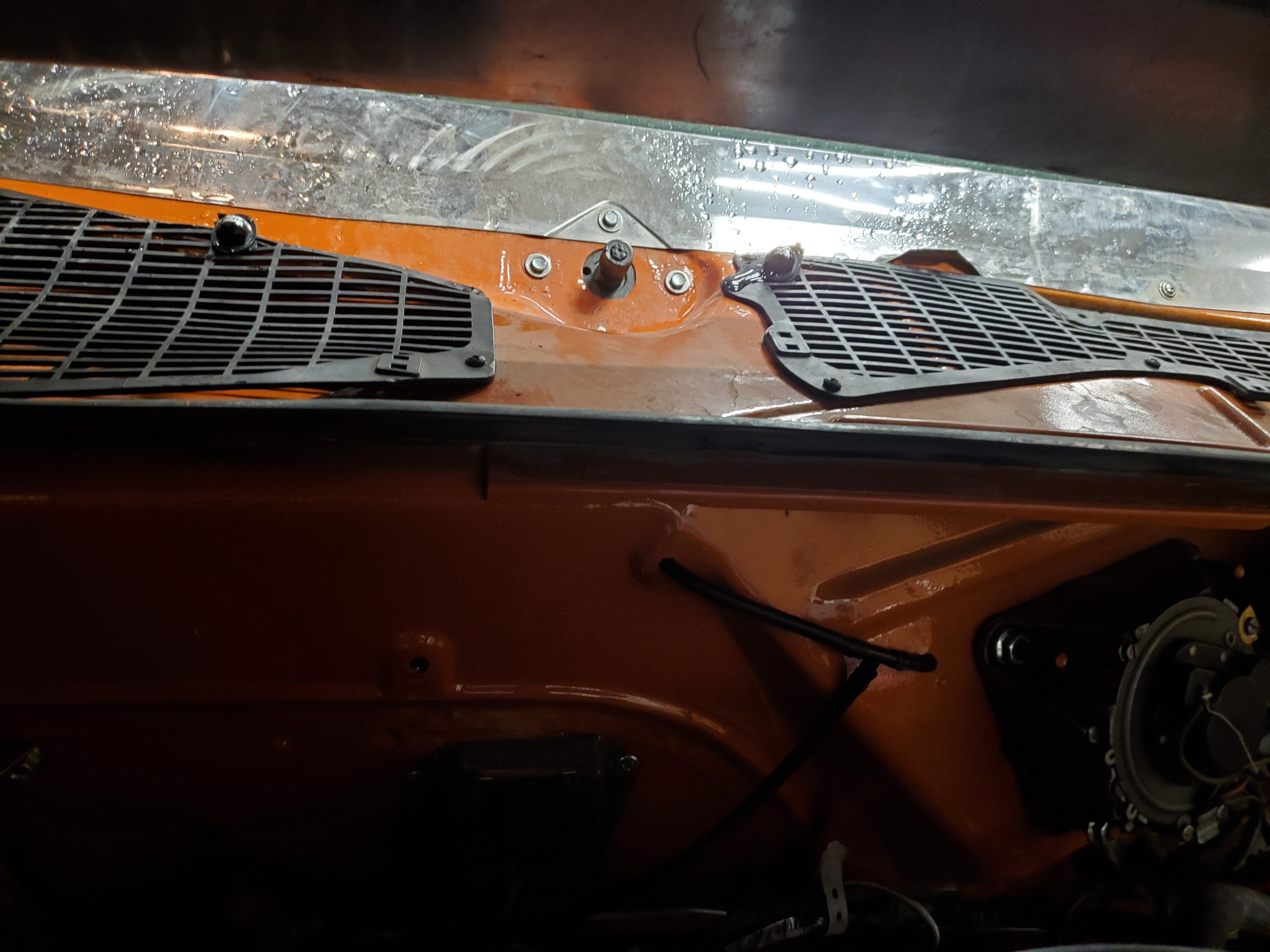

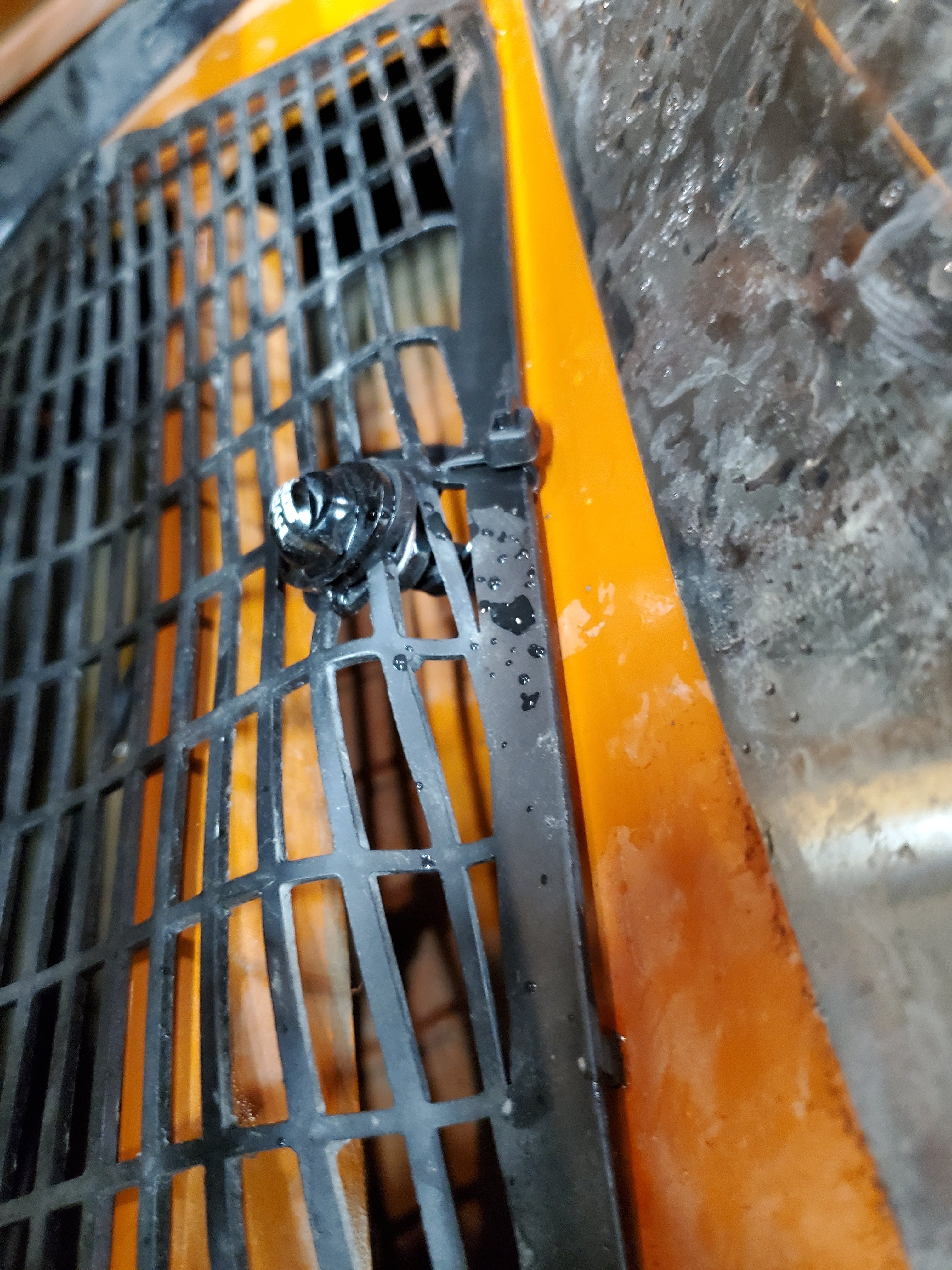

To avoid making holes in the hood, or adapting nozzles under the hood, another factory style system might be used. In 1974, B-bodies began using a system that had a nozzle bar mounted to the wiper arms. The bar has four nozzles and sprays directly on the windshield as the wipers moved. The hoses were mounted to the hood, but in 1975, the hose and tees were moved to the cowl. C-bodies also began using the system in 1975 and used it through 1978. B-bodies used it through 1979. The 1979 - 1981 R-bodies also used it.
The following images show the 1974 and 1975-later setups:
I have this system as originally installed on my 1977 Fury and my 1979 Newport. I have not looked into doing this adaptation, but it appears workable. The nozzle bars clip to the arm, which is similar between the later B-bodies and the E-bodies. The tubing is very small to be lightweight and flexible on the arms. The tees and junctions used on the later cars are no longer available new, but small universal tees and couplers can be used.
Looking for a used set from a donor car to gather all the nozzle bars, tubing, etc. should provide all that is needed, to be complemented with newer tees, etc. to adapt it. It can work with the stock E-body washer reservoir/pump and main hose. The later wiper arms have a hole in the side and the nozzle bar to tube runs under the arm to exit at that hole. The later arms are wider at the base than the earlier E-body arms, so this might be a tricky area to fit well and hide. The later B-body arms themselves might be adaptable to the E-body. The later arms use 18" blades, but might be workable to fit 16" blades.

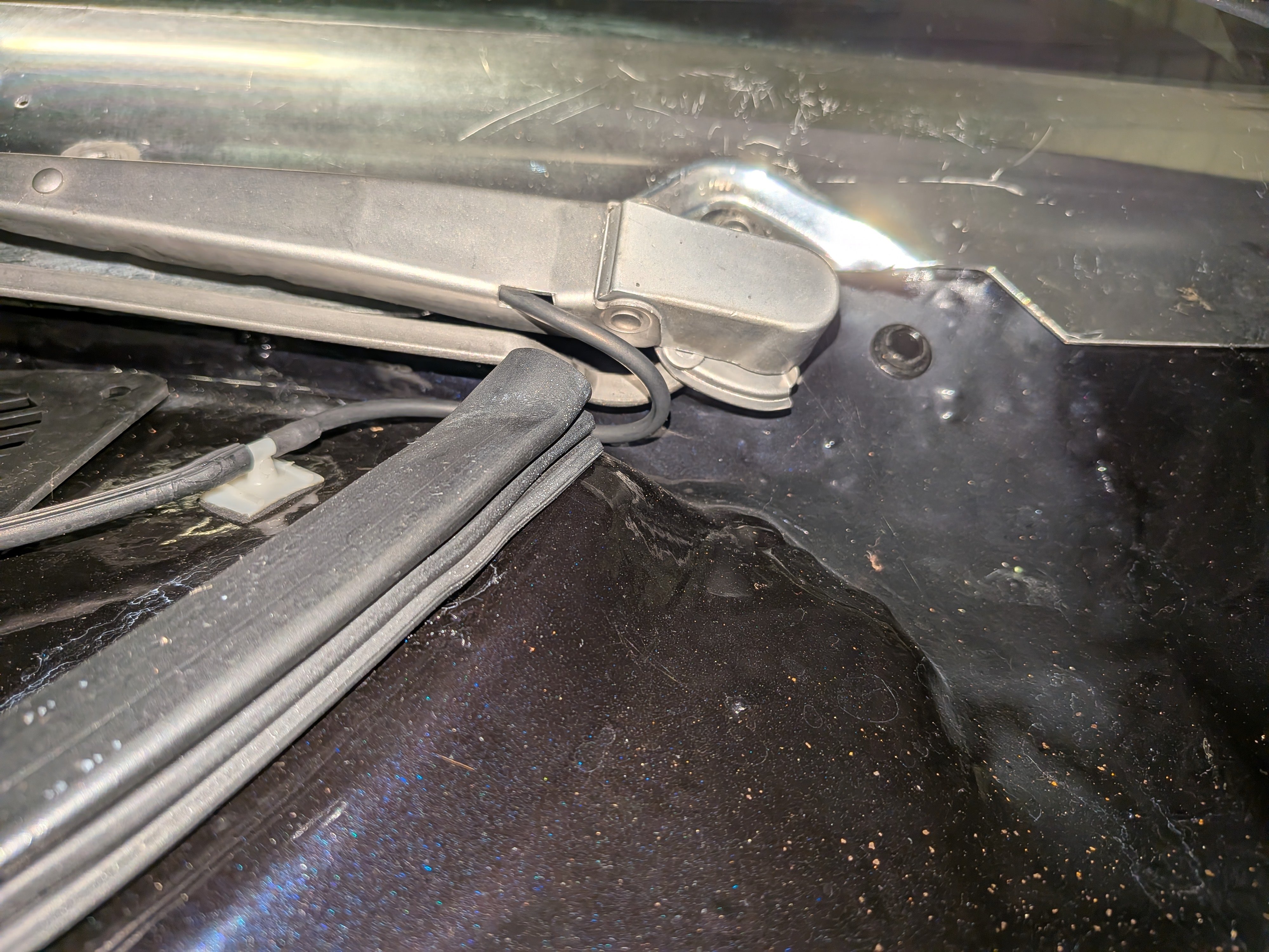

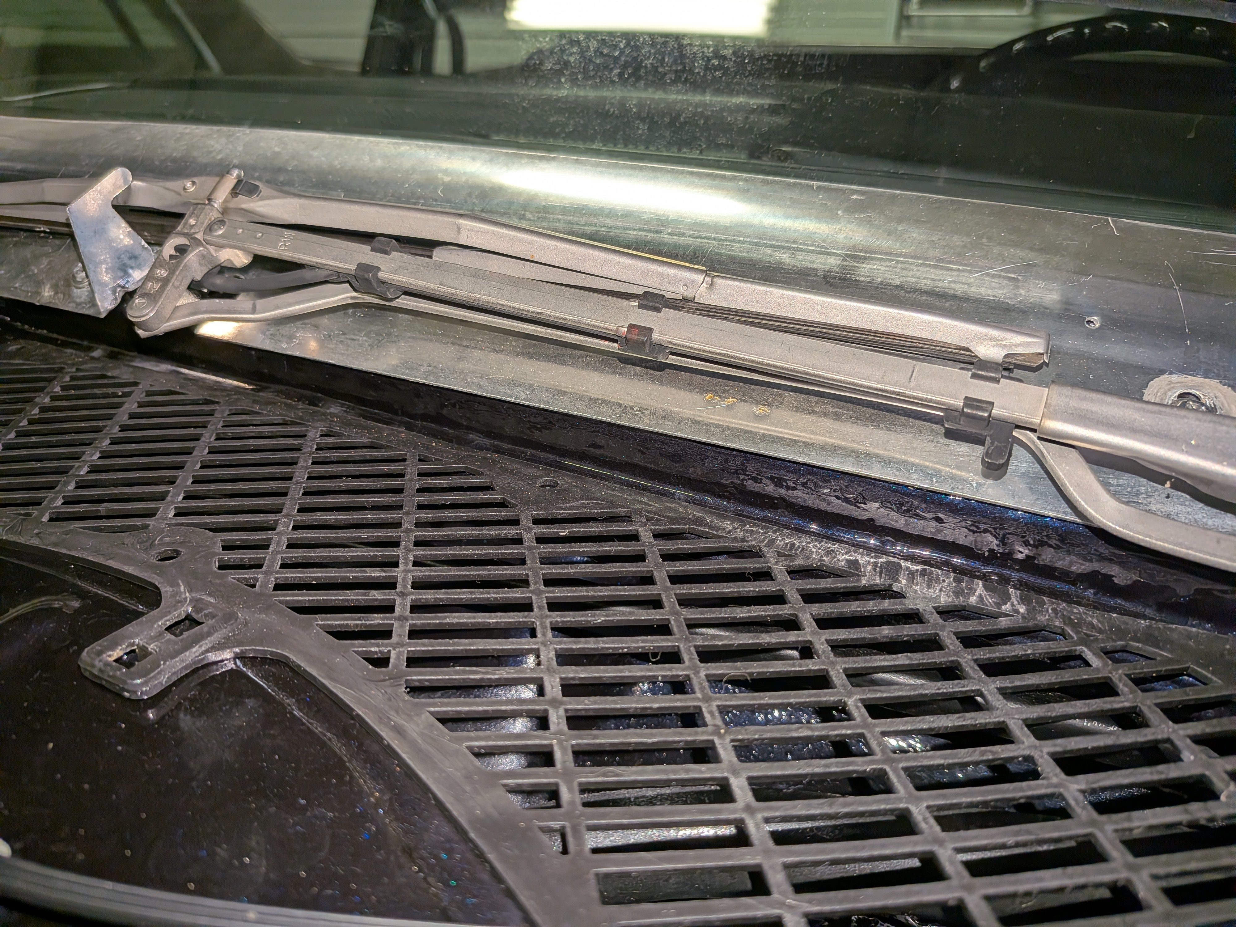

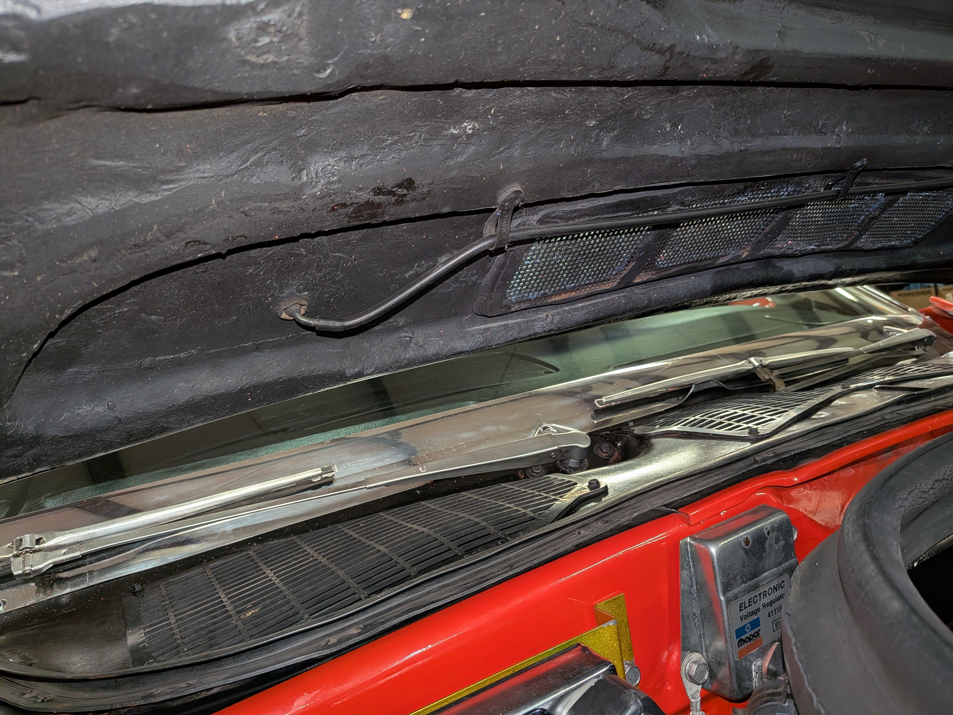

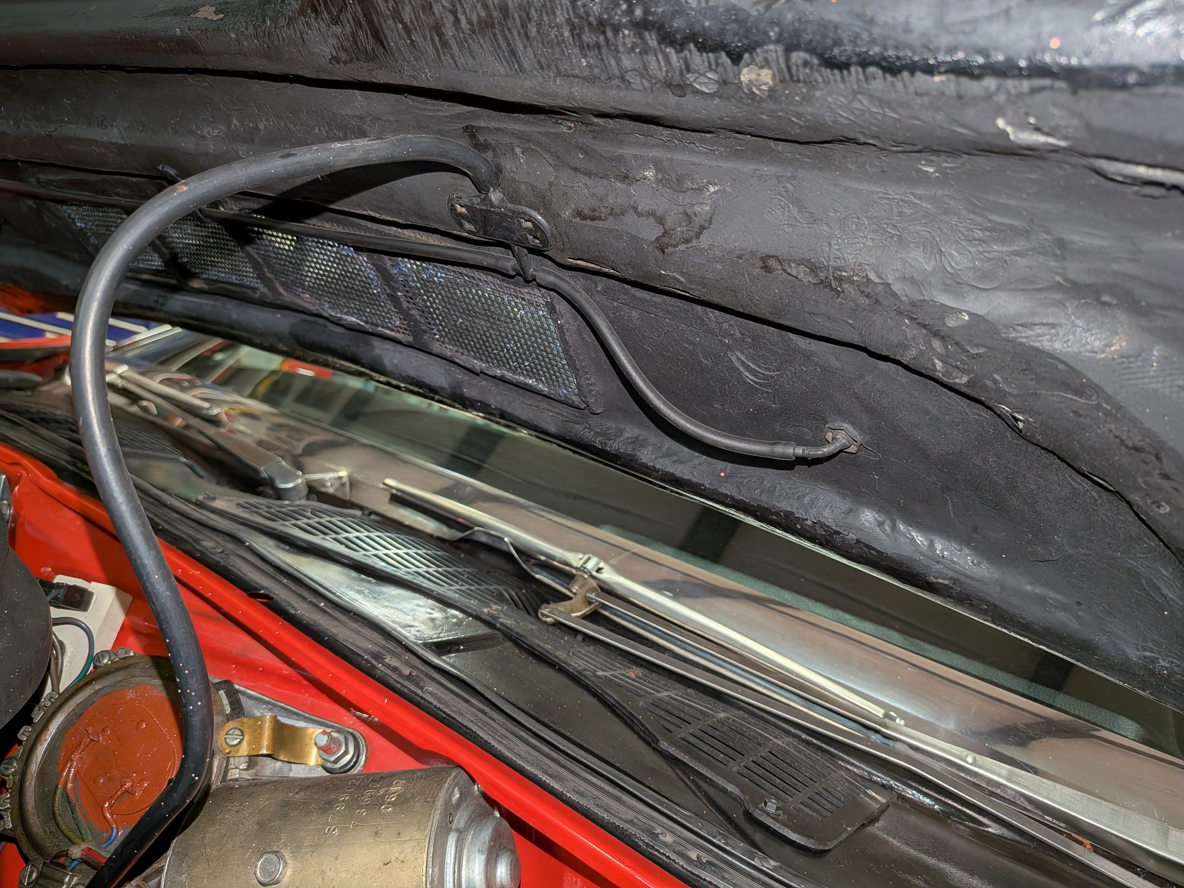

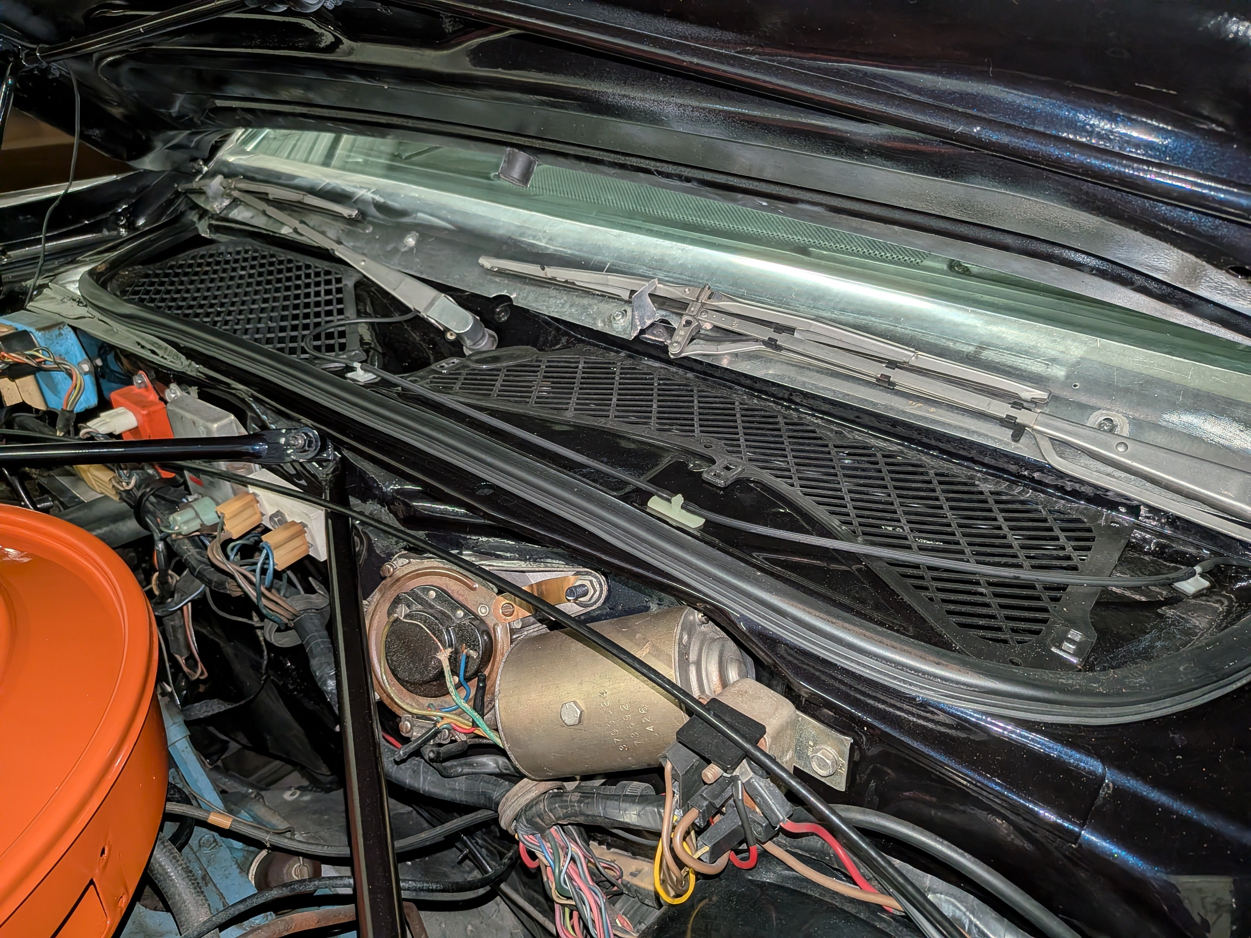

The following images show the wiper system and some details on my 1977 Fury. The tee and couplers were my last NOS pieces that I bought new in the 1990s. I changed the original broken pieces then, and recently had to change them again. They snap into holes made for them. The tee is fed through a hole in the cowl from the washer hose under it. The hole in the E-body cowl could be used for similar with a loose tee.
Couldn't you find something aftermarket that would squirt from the back underside of hood. That way you wouldn't need to drill holes in a new hood. There seems to be enough room there
the lip of my hood (when closed) sits about 1-inch from the windshield glass. the wiper arms must go through there. under hood sprayer is possible. but it's a tight fit, and the angle may be too acute.

there are several newer more modern cars that support this feature. my only critique of this method, is if there is dried debris, such as mud, or ice mixed with dirt, then the wipers must pass back and forth several times over the gritty mess to make it wet enough to squeegee off, while the abrasive of the mud/snow is scratching away at my windshield.

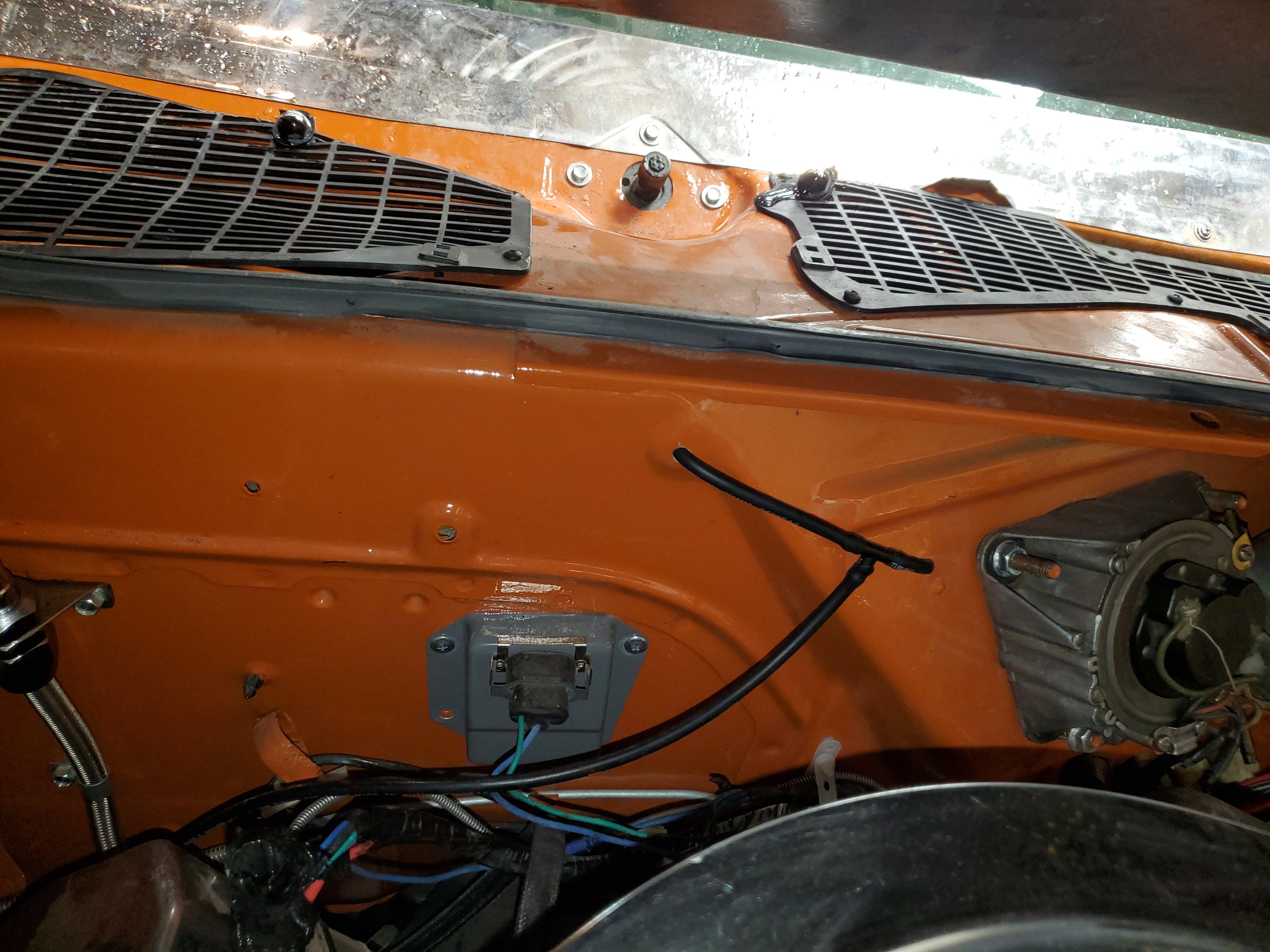

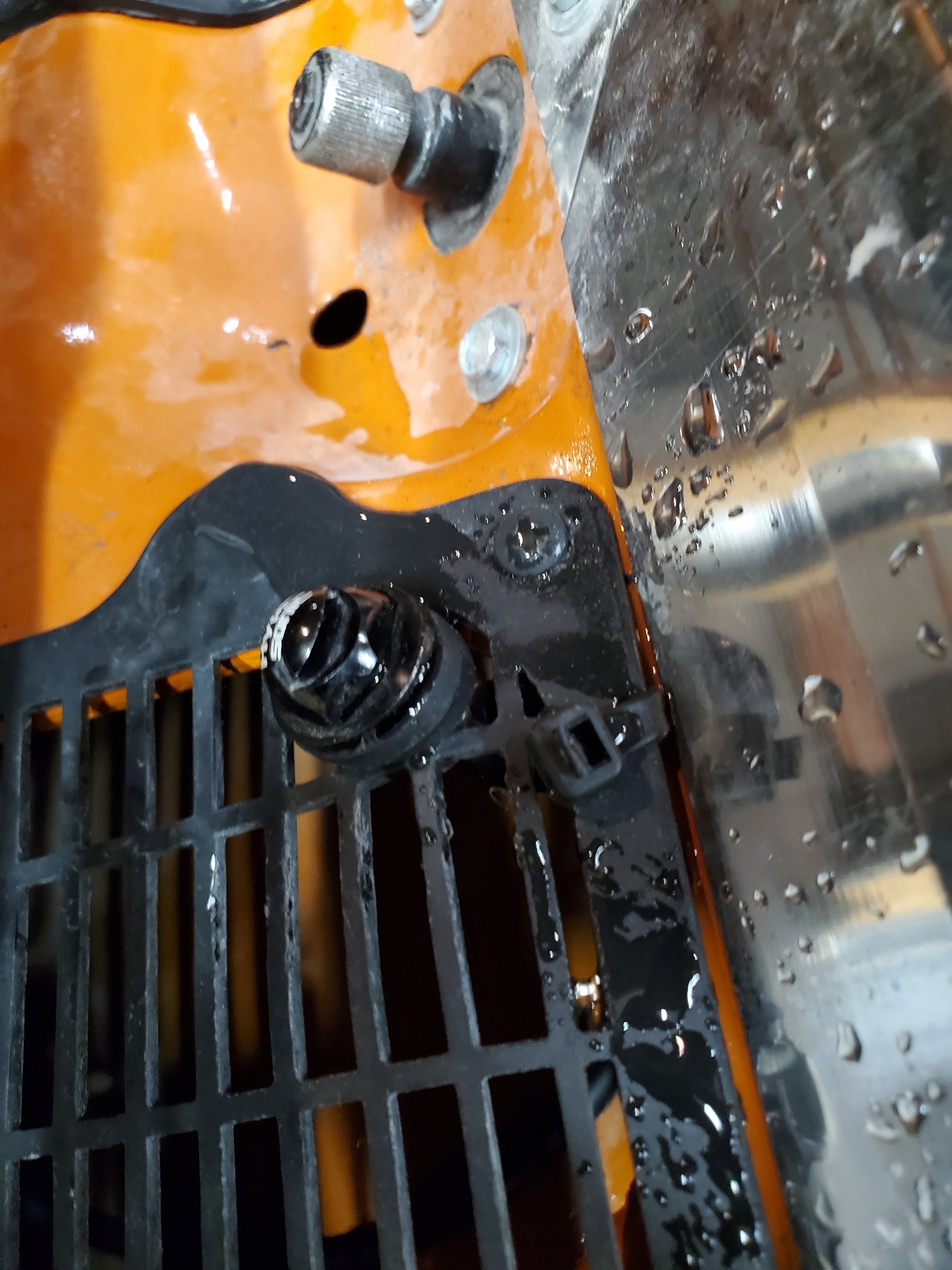

So I put washer sprayers into those plastic cowels on the outside dash. Took a bit of trial & error to get them spraying in the right spot. The wipers will be on the way but not while they are used.
There are holes going into that cowel area already so didn't need to drill anything.
