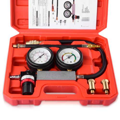

A leak down test also a good diagnosis tool.
Cylinder Leak Down Tester Engine Compression Diagnostics Test Tool Kit | eBay
