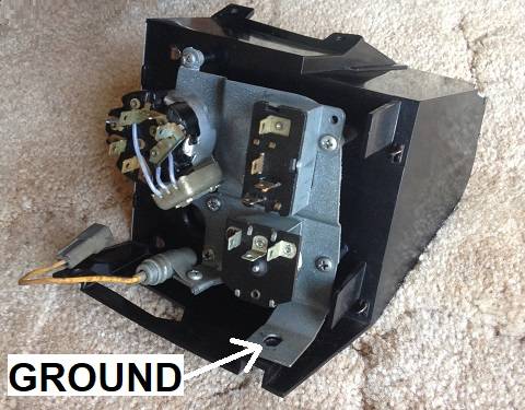

I don't have much experience with 2 speed ones but I'd make sure the motor and switch are definitely grounded using an ohmmeter to squash any doubt. Sometimes the switch plate mounting screw used for ground comes loose or falls out (picture).
I've seen videos where a 2 speed will reverse but not go all the way to park. Does yours just stop as soon as you turn the switch to off?
