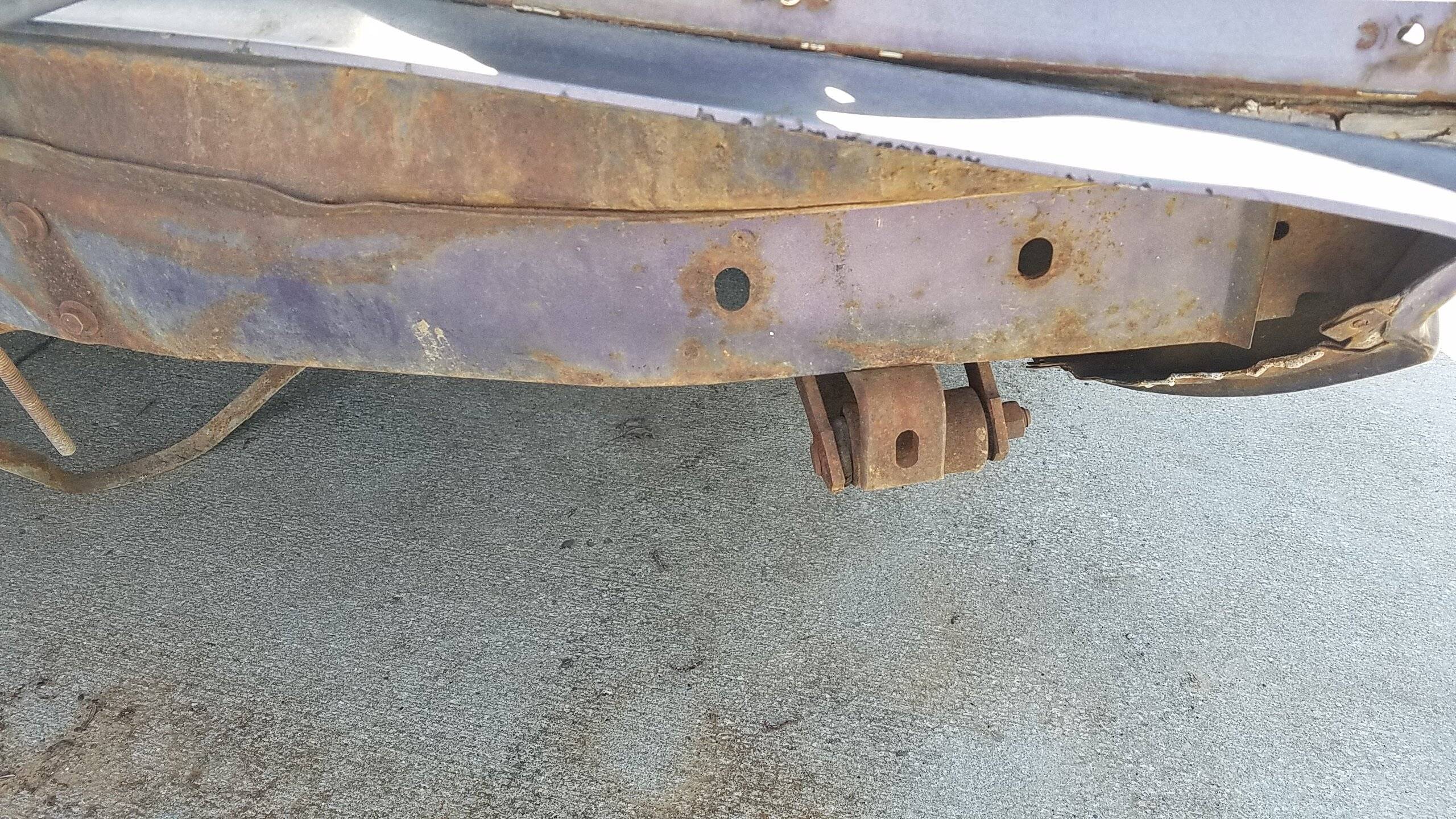

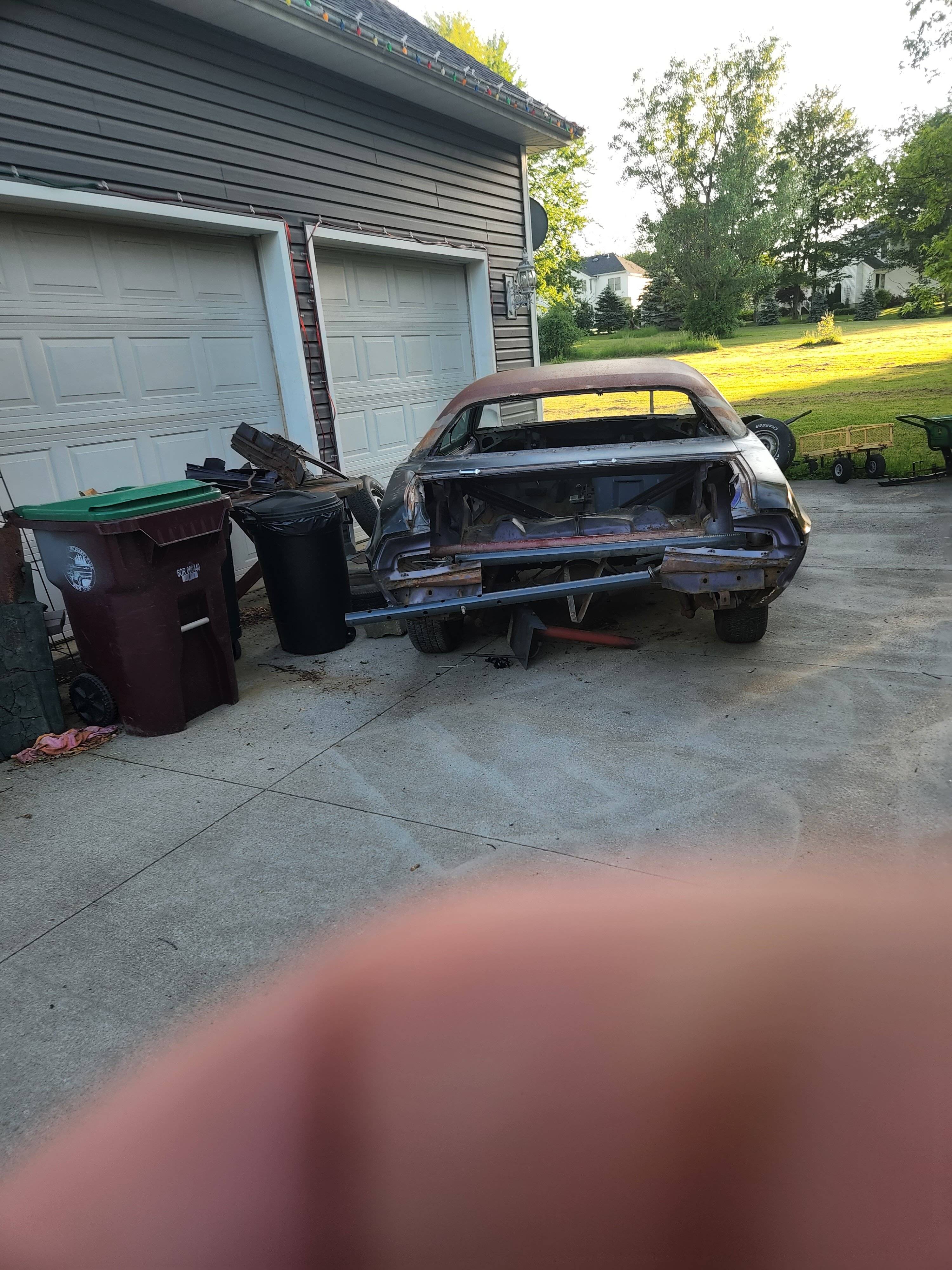

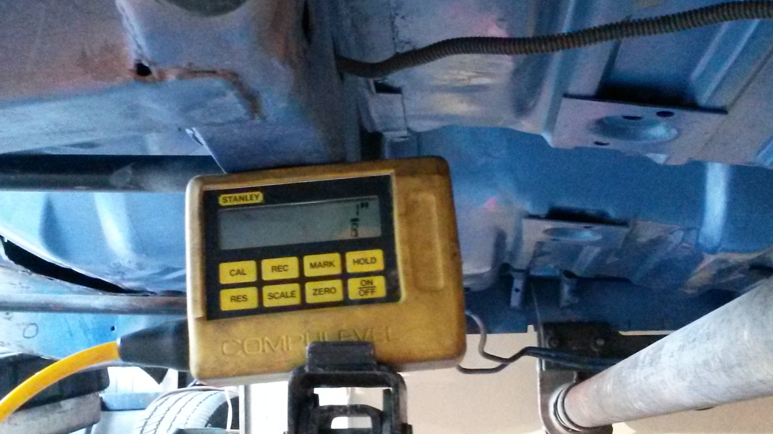

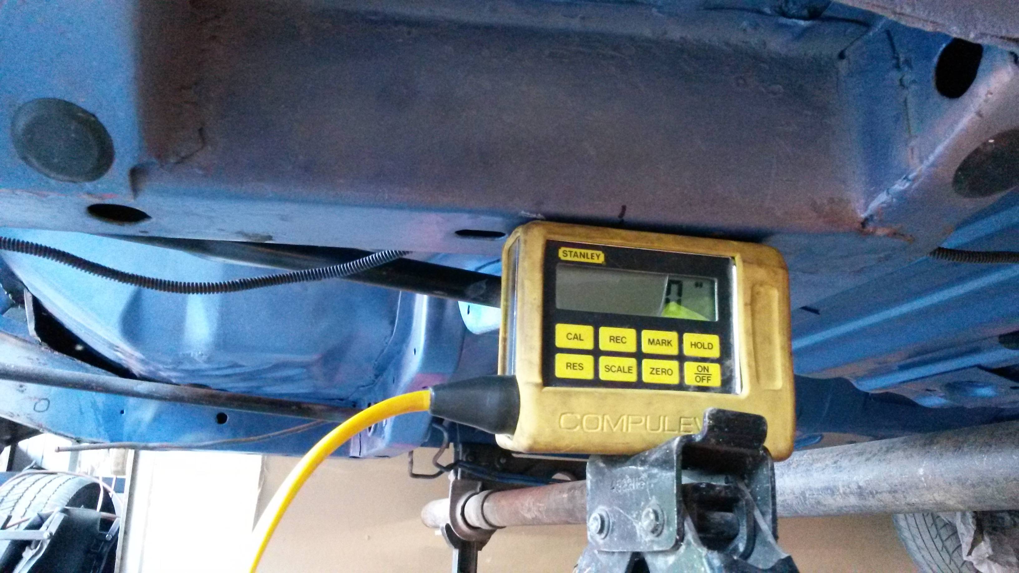

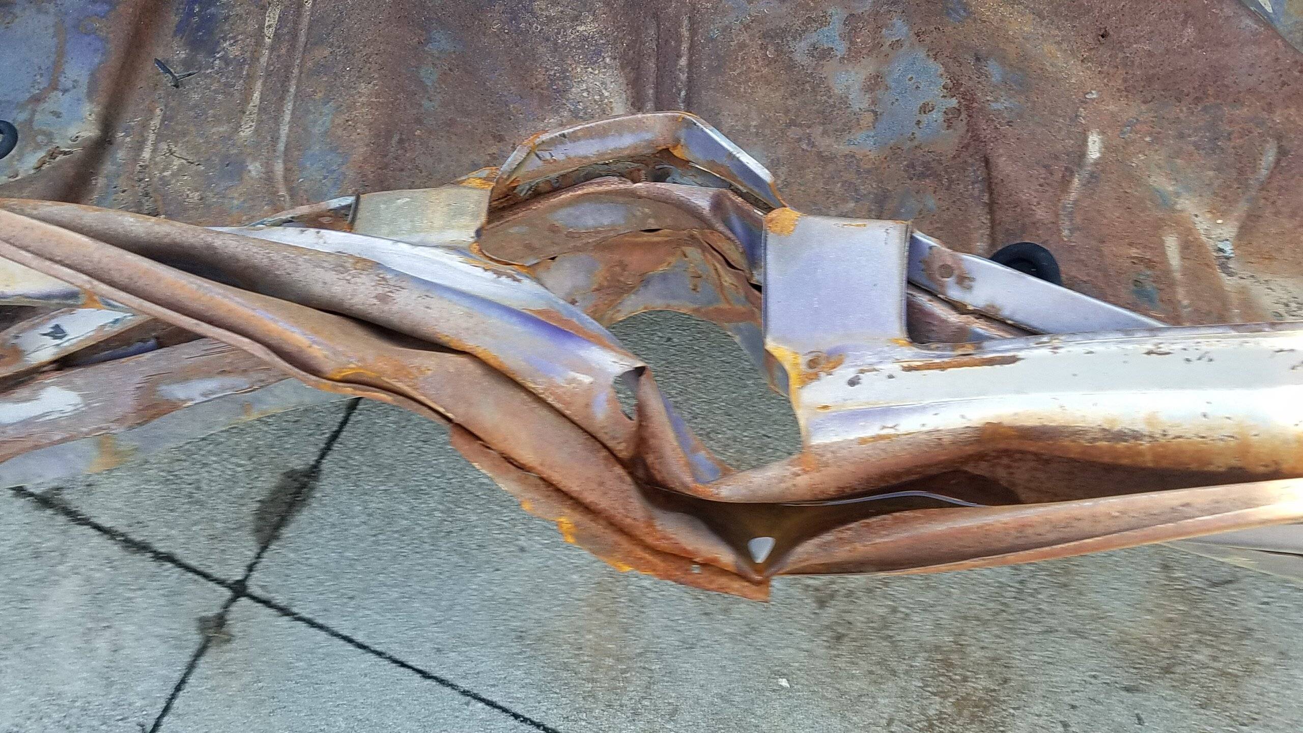

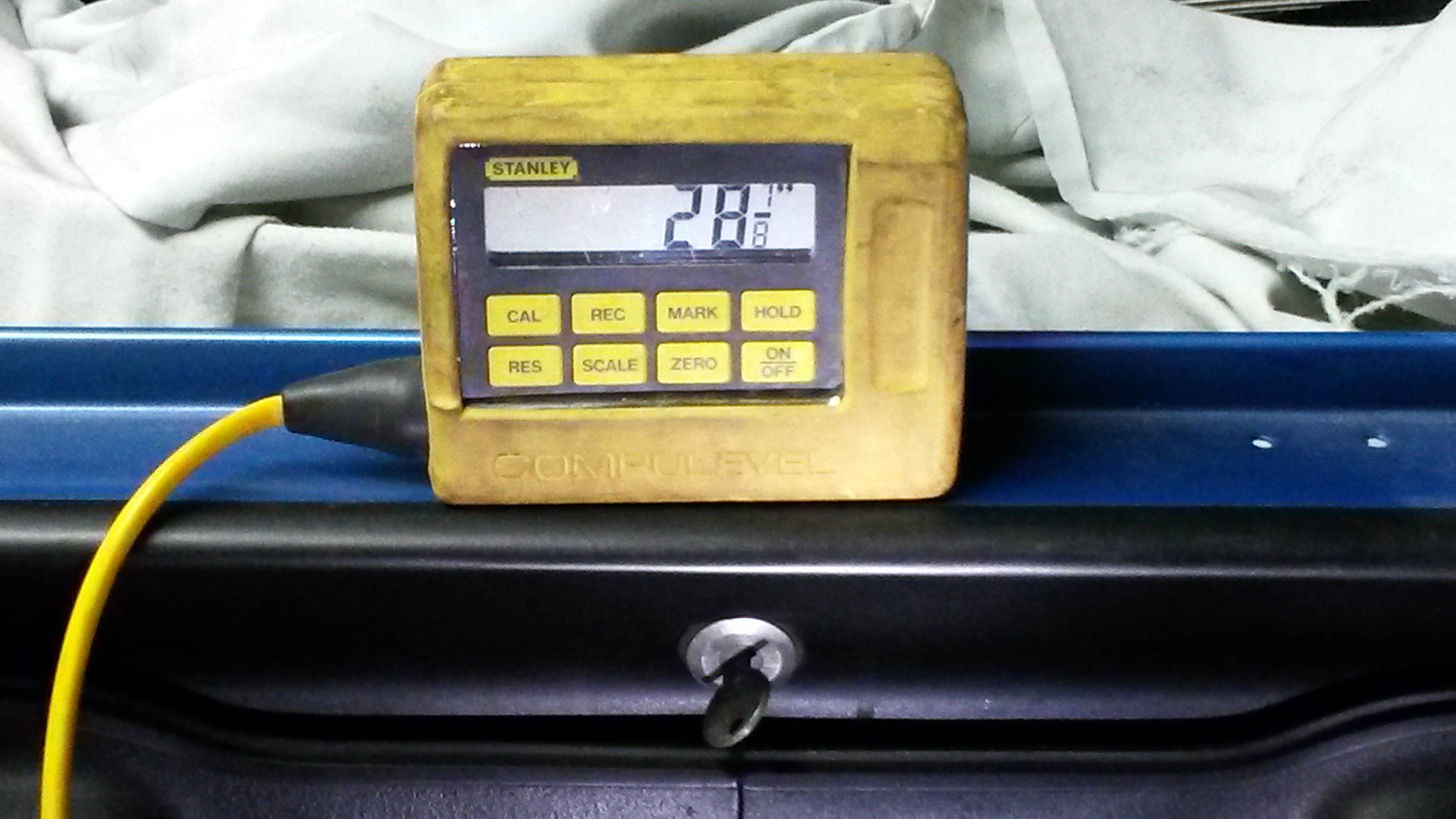

not much to see, the third pic shows 1 side, centered over the spring, the other side looks the same and I was measuring from 1 inside hole to the other and then edge to edge on the panel. Also the length of the trunk lid at the top is longer than the length at the bottom (talking horizontal) so if the decklid is a rectangle the corners are sucked in on the car.

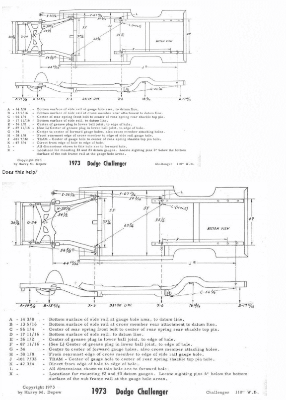

Well I am in for a rough ride, the trunk opening is 56 1/2 at the top (I am measuring the opening not the lid so it should be a little bigger) but when i get to the bottom its 52 and something, so I lose like 4 inches. When I measure the distance outside to outside on the frame rail its at 46" not 48 as in the diagram very thoughtfully posted( thank you).

yes it did and thank you. it seems the D value is equal on both sides but the 48" across the rails at the rear is way off by 2" I get 46 or so. My trunk opening narrows from 56 1/2 at the to down to 52 at the lip. Car is going to need a lot of love!
Once you cut away the caved in areas I think it will relax outward a bit, then only a little tweaking should get it the rest of the way.

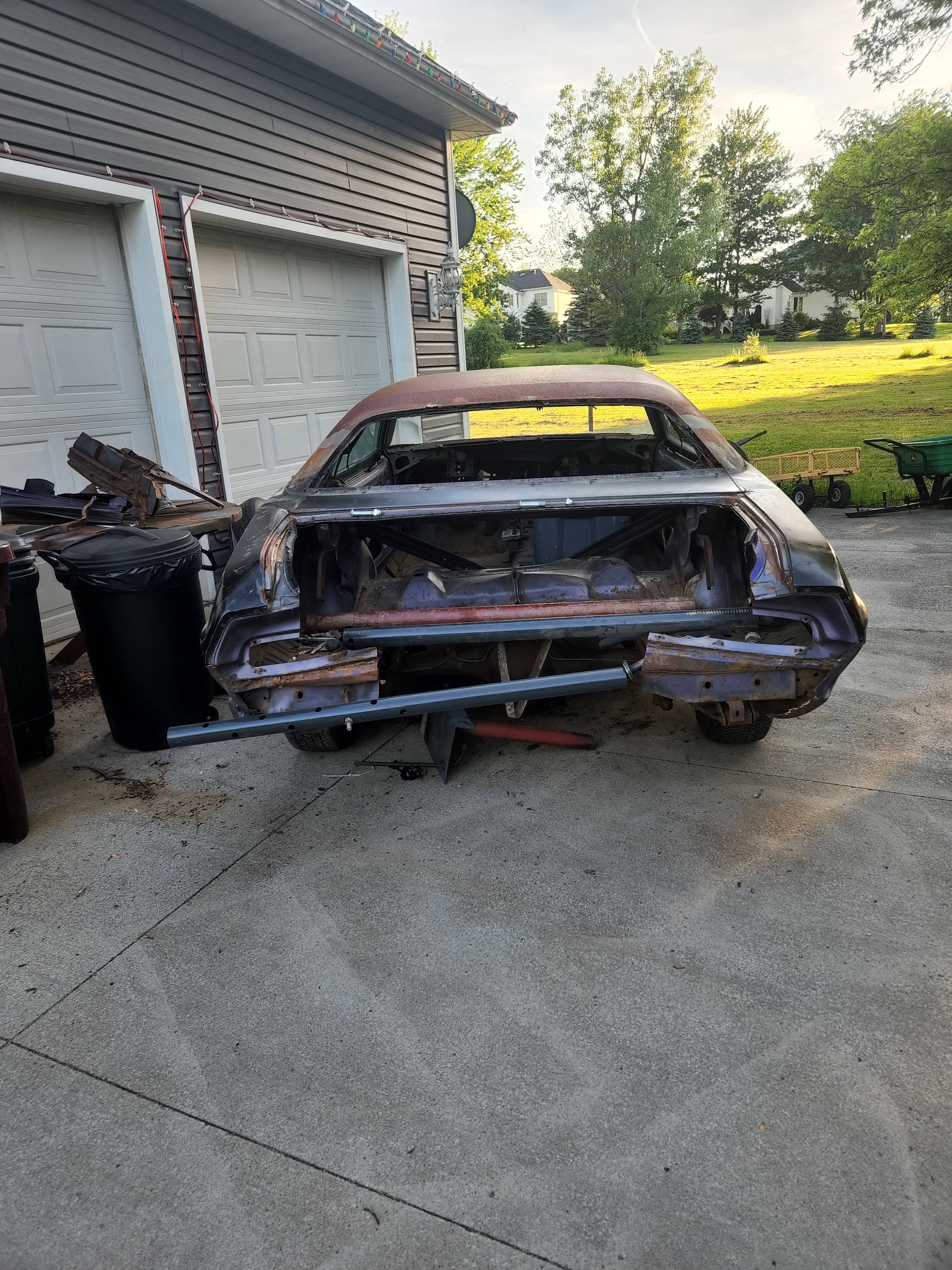

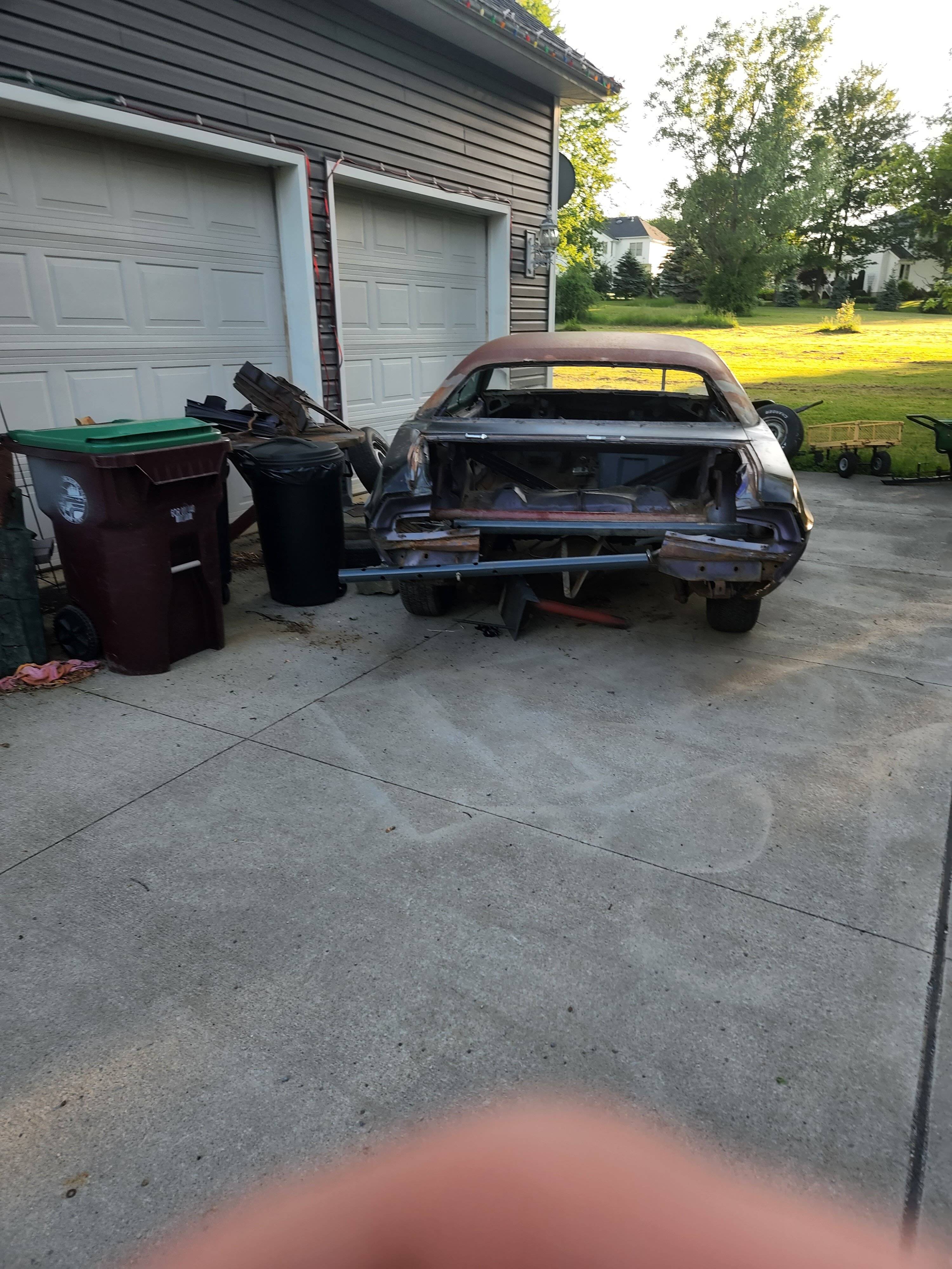

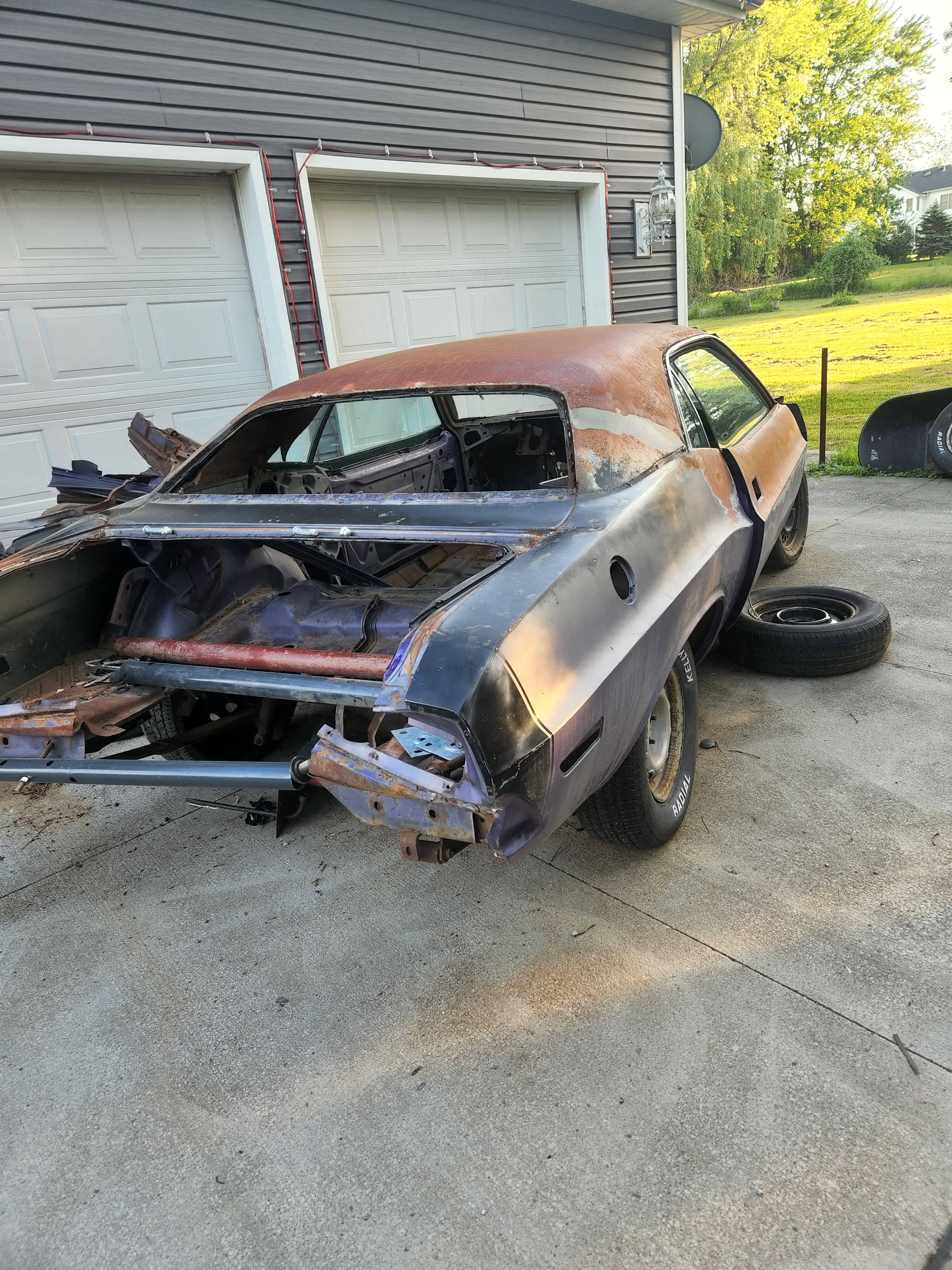

Hey I would like to see more pictures of you car but from a distance to see the total damages, I’m a retired auto body tech , Thanks Ray

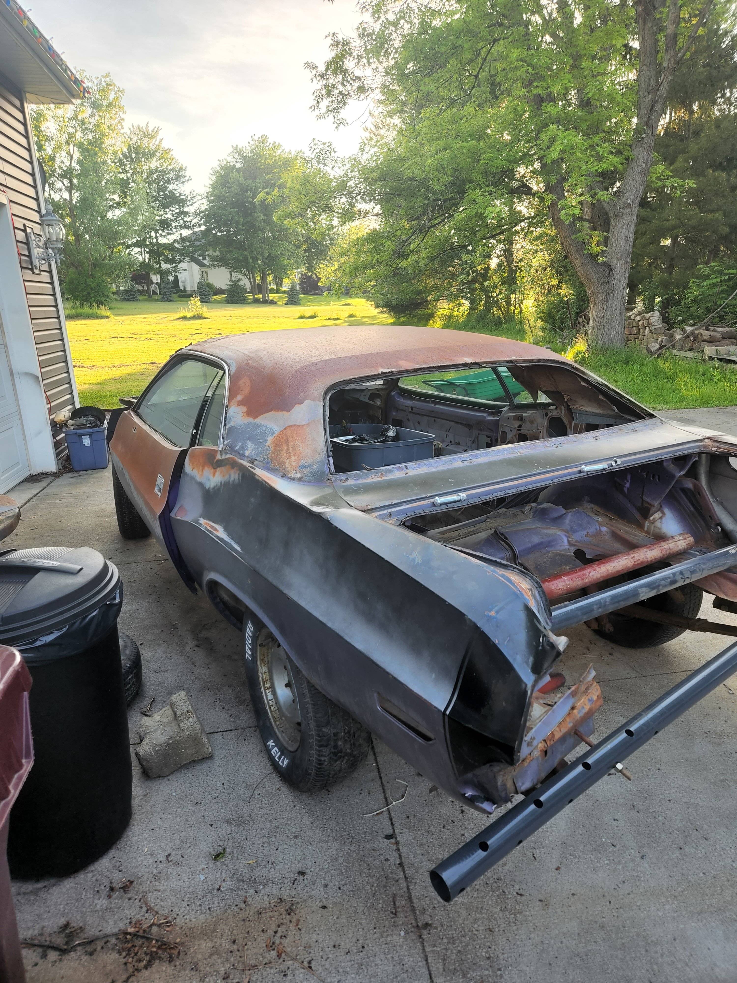

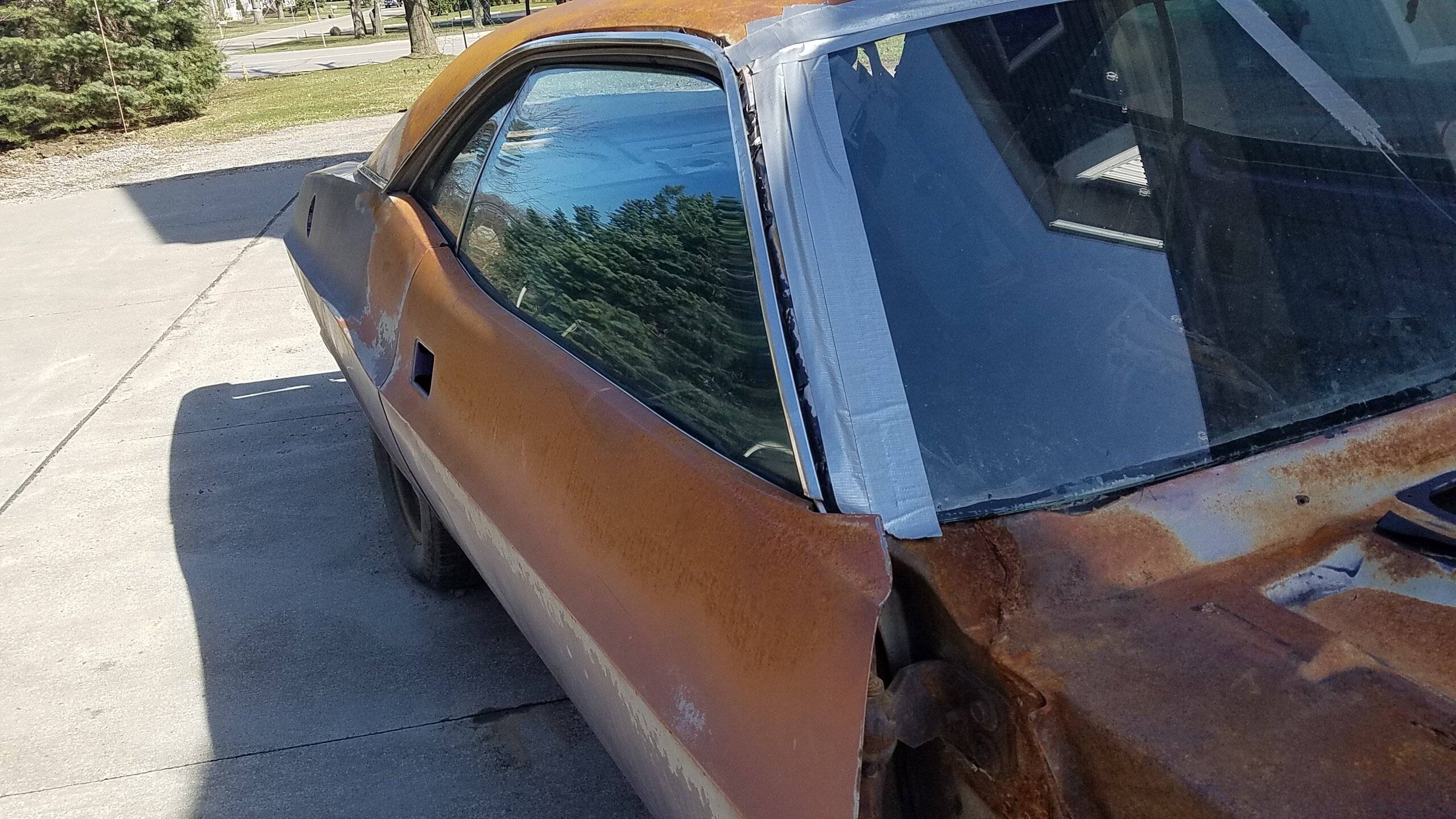

The first pic is another project, a 66 charger, 440 nothing matching so I am going with a new color voodoo violet. the others are the Challenger, i removed the real twisted stuff so I could get in there. The is a little damage that went across the seam from the trunk floor to the back seat panel on the passenger side but its cosmetic.

I would get a new trunk floor pan one peace, new tail light panel, Your trunk lid ok or pushed up at the trunk latch? If so you’ll need a trunk lid the hinges are ok ? A good body person can save both 1/4 panels , new trunk Chanel’s there cheep ,I would cut it off the floor pans get to the frame rails straight them and start replacing the panels ,As for the 1/4 panels replace the left and repair the right , I don’t know your skill level? But it’s your call good luck should be a nice car when you’re done!

Just so you know the 1/4 panels are used to line up the doors.remove the doors you loose the alignment for the 1/4 panels.Unless you set up or pull measurements in front of the doors.Don't remove anything else until an experienced person looks at it. There are no factory tram measurements that I know of.Someone may have something? 3 1/2" top to bottom of instrument.
Do you have a Tram?

I guess unless I hand out bushels of cash nobody wants to even look at it, I have received a lot more help from this forum for which I am very grateful. Anyway, I bought a frame fixing kit , nothing fancy just a pump a ram and some fitting. So far my frame rails have been moved out 2" at the ends and now match the guides that were posted. The holes on the crossmember are not even close yet which makes me wonder if classic industries didnt send the wrong piece. Next I will try and rotate the quarter panels out to full width so the trunk opening remains at a constant width.
