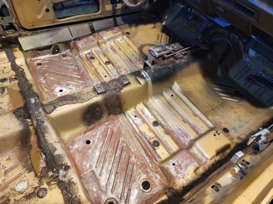

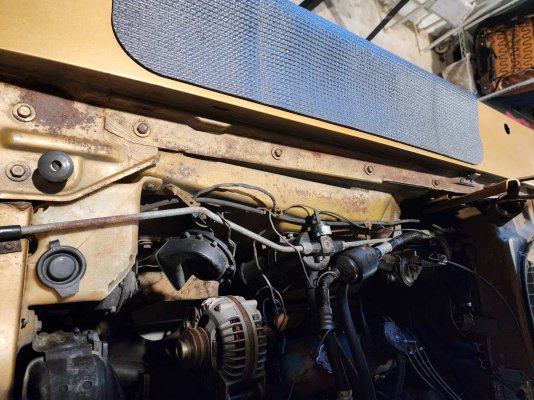

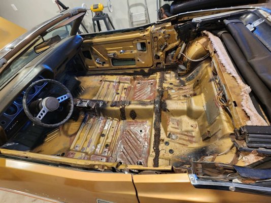

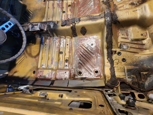

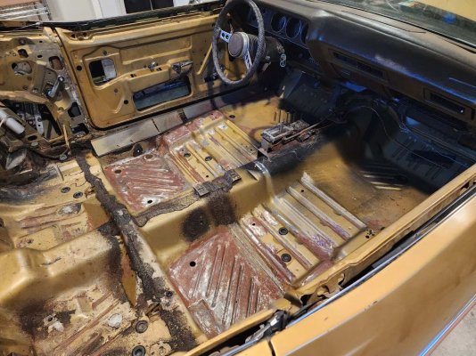

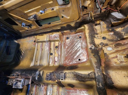

  • CFL
    CFL replied to the thread Rust Repair.
    I've got a similar challenge with surface rust on the rear floor pans of my 71 barracuda convertible and needs some advice. I've grinded...
